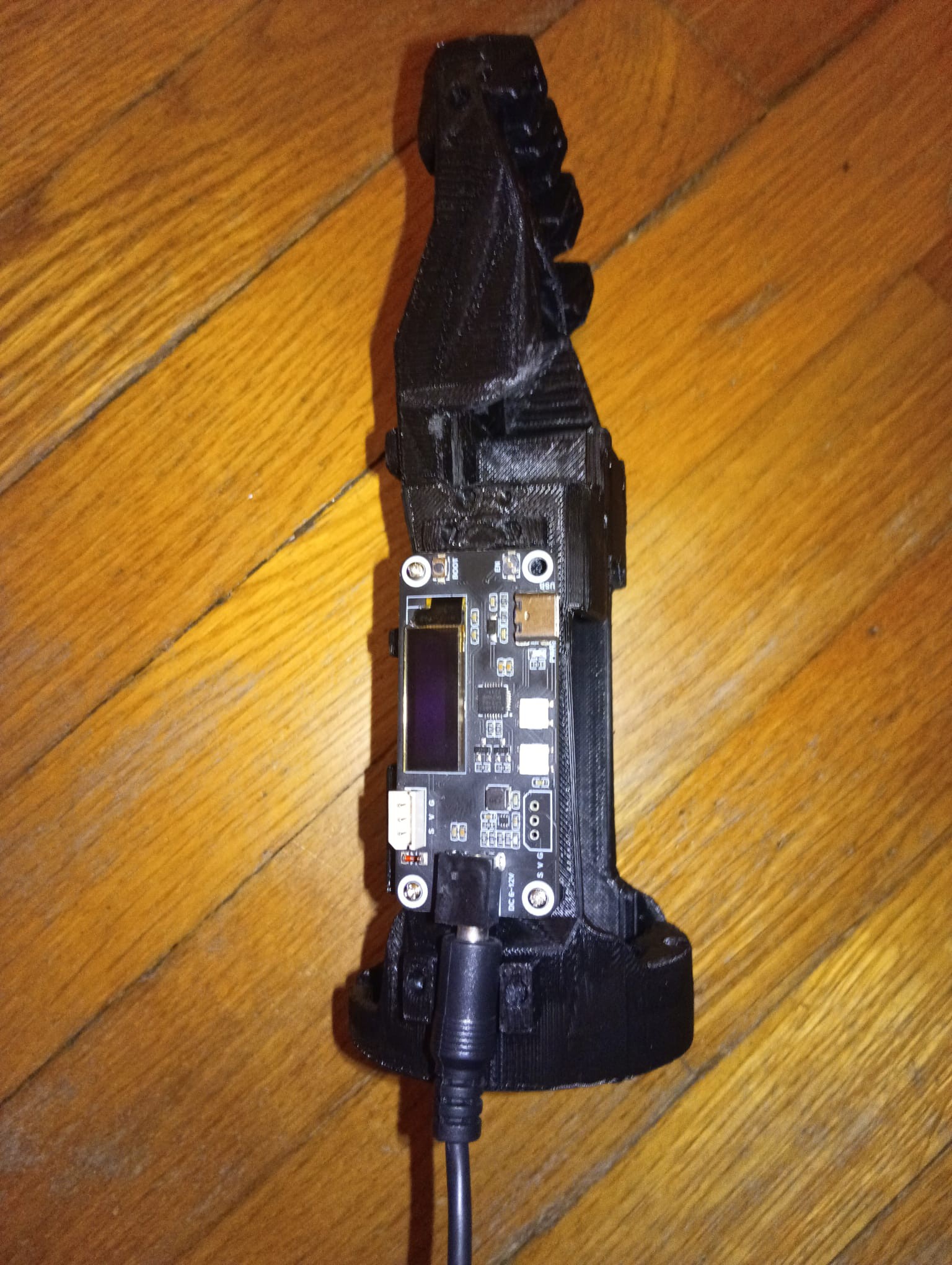

  • 1 × Creality Hyper ABS Filament Spool Skeleton and spools
  • 1 × PolyFlex TPU 95A Filament Spool Fingers and palm
  • 1 × Raise3D Pemium PLA Filament Spool Covers, fingers
  • 5 × WaveShare ST3215HS Servomotor Tendon flexion and extension, Thumb rotation
  • 1 × WaveShare ESP32 Servo Driver Board The brain of the hand

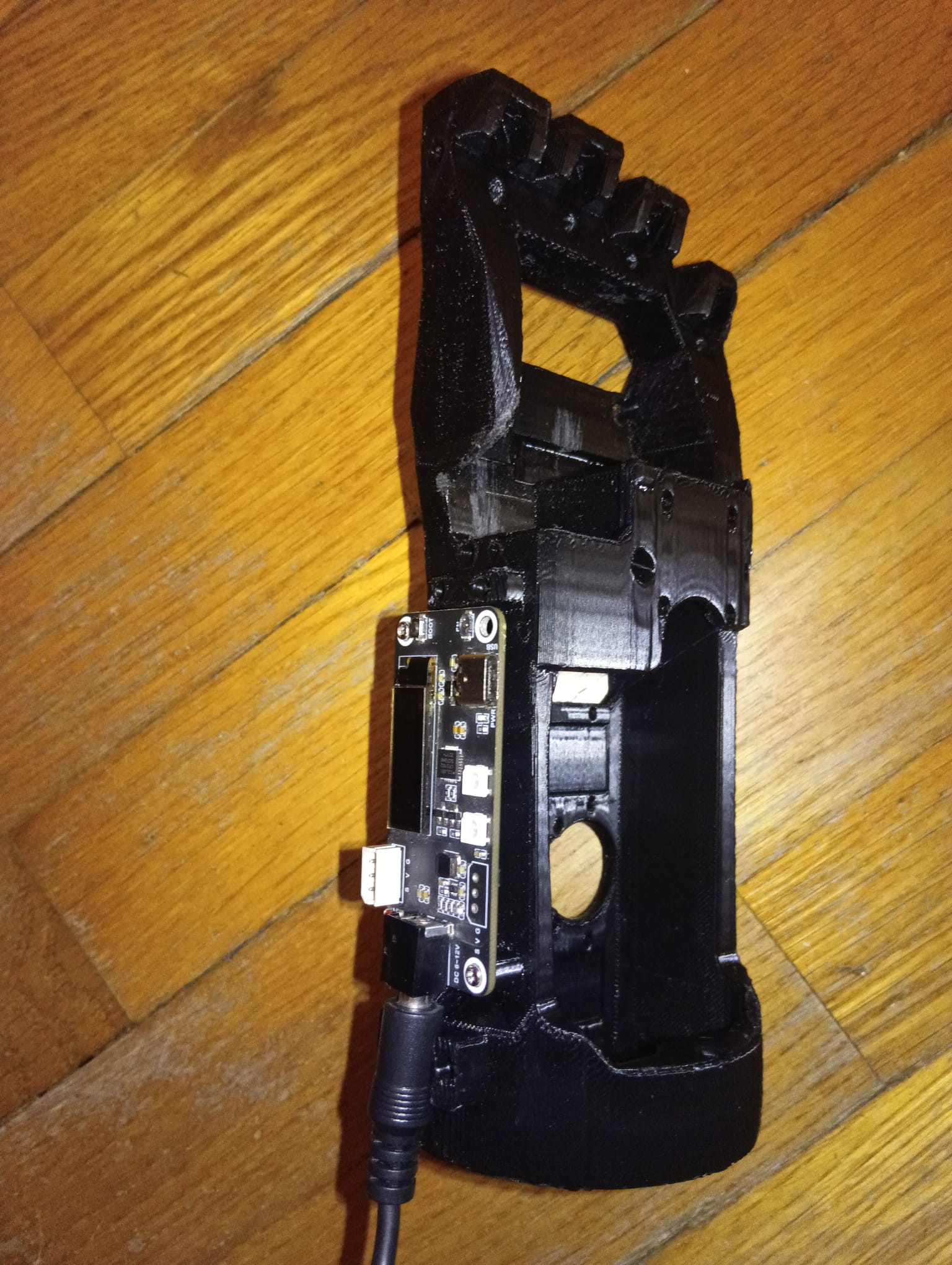

    Assembly : Initial Empty Skeleton
    The names of the holes and other parts are defined in the chapter Nomenclature of Parts.
    The assemblage consists taking the hand’s skeleton and to install on it all the components following a precise sequence.
    IMPORTANT: If the sequence is not followed correctly, all components already installed will have to be dismantled till the moment the sequence was modified, in order to resume again the proper order of the sequence because there are parts that cannot be assembled after others.
    Skeleton - front view
    Skeleton - back view

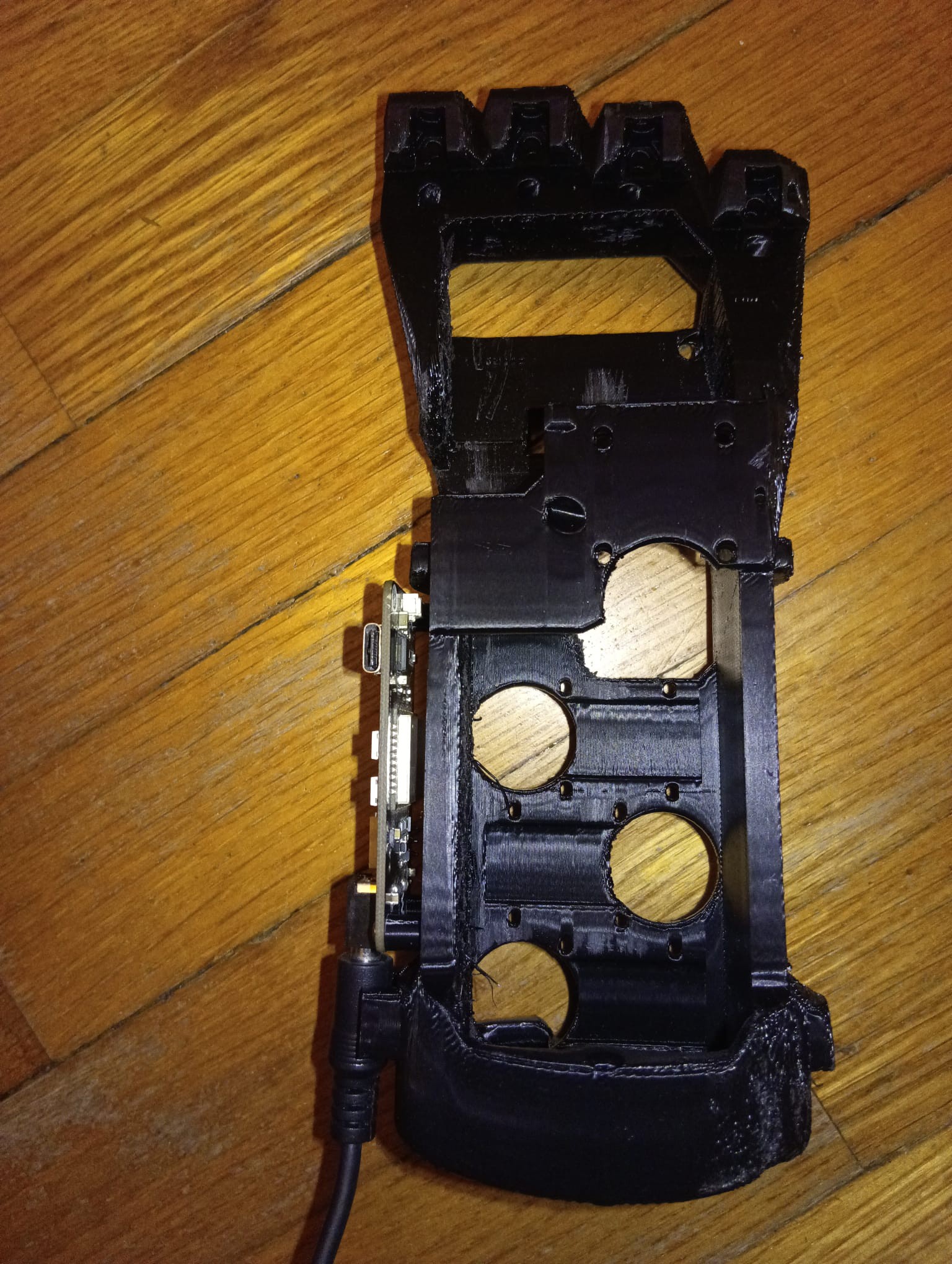

  • 2
    Assembly : Servomotors Installation
    Note: each servomotors must be secured in its slot using 4 screws M2, 8mm long. TBD
    1. Install the Thumb Rotation Servomotor in the SSTR slot (Holes: MTR1, MTR, MTR3, MTR4)
      ◦ Note: Position the motor with the flange facing down.
    2. Install the Thumb Flexion Servomotor in the SST slot (Holes: MTF1, MTF2, MTF3, MTF4)
      ◦ Note: Position the motor with the flange facing the front side of the skeleton.
    3. Connect the servomotor in the SSTR slot to the one in the SST slot.
    4. Install the Middle Flexion Servomotor in the SSM slot (Holes: MM1, MM2, MM3, MM4)
      ◦ Note: Position the motor with the flange facing the rear side of the skeleton.
    5. Connect the servo motor in the SST slot. to the one in the SSM slot
    6. Install the Ring Flexion Servomotor in the SSR slot (Holes: MR1, MR2, MR3, MR4)
      ◦ Note: Position the motor with the flange toward the rear side of the skeleton.
    7. Connect the servomotor in the SSM slot to the one in the SSR slot
    8. Install the Index Flexion Servomotor in the SSI slot (Holes: MI1, MI2, MI3, MI4)
    9. Connect the servomotor in the SSR slot to the one in the SSI slot
    Left Hand – Servomotors Built-in – Front View
    Left Hand – Servomotors Built-in – Rear View
