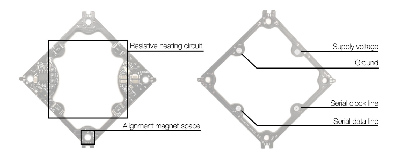

The overall system layout is: each robot/system has one primary microcontroller (ESP32-WROOM) that we can talk to over Wi-Fi from a central laptop that does all the path planning etc. This is networked to all the functional voxels/modules over an I2C bus. These periphery modules can provide a variety of functions, but in general they are all ATtiny412 based and contain one PWM enabled output and one analog input for free play, the I2C bus connections, and the resistive heating circuit. These receive regulated 5V power from an onboard linear voltage regulator, while the heating circuit (or any other output devices, e.g. hobby servos) receive the power rail voltage.
So, based on that, we transmit 4 lines between each voxel face: V_batt, ground, SDA, and SCL. For back-to-back connections, i.e. from block-to-block or between voxels, this is handled using the resistive heating circuit. For connections within a voxel or module, this is done using a soldered corner joint or using wiring.

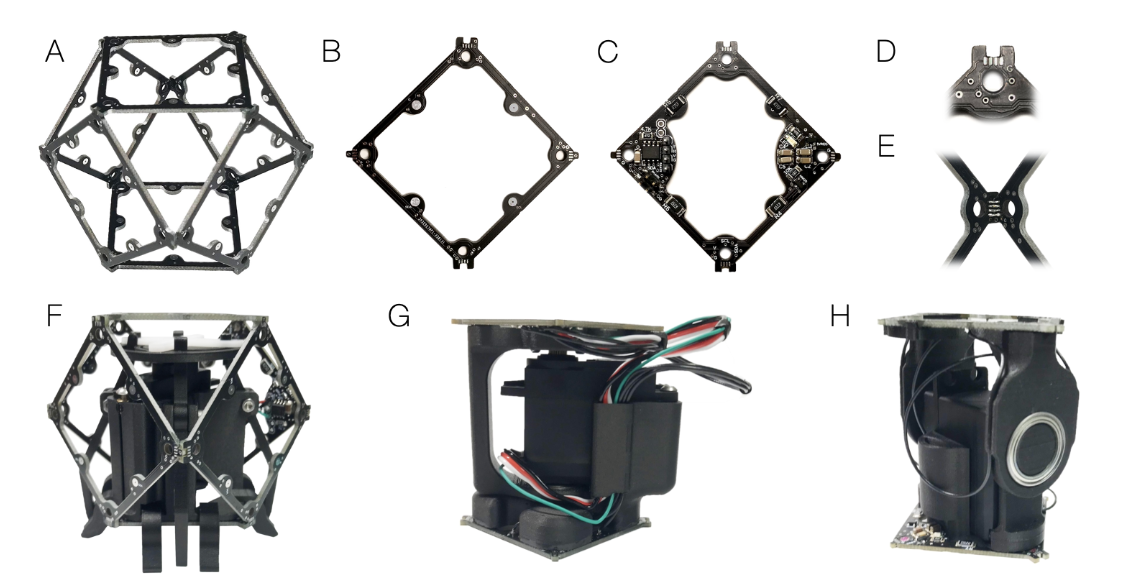

I used a 65 mm lattice pitch (the bounding box around the module is 65 mm side length). The PCBs are two layer boards from JLCPCB, with the routing as described above. B) Shows a passive face, where the four connection points are the spots on the middle of the beams. C) shows an active ATTiny412 based face, where the SMD resistors are visible. The empty holes at the corners are used for magnets, which help with fine alignment between the modules before the solder is reflowed. By adding actuation, we then get robot modules. F) is a gripper module for picking up/walking over existing blocks, while G) and H)...

    I like a manual solder paste-based workflow haha. These boards are all designed with 1206 components, so it's not too painful at all.
    For the printed parts, you want to be cognizant of how close you are to the low-melt solder reflow pads. If you give enough air gap (3mm or so), I haven't had any problems with PLA. You can get much closer (or even touching) with something like PC, but in general the resistors will get hotter than the softening temp, so watch out.
