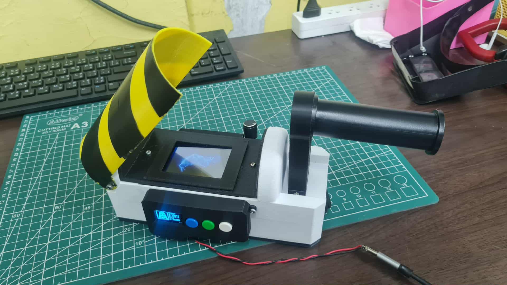

Step 1: Designed

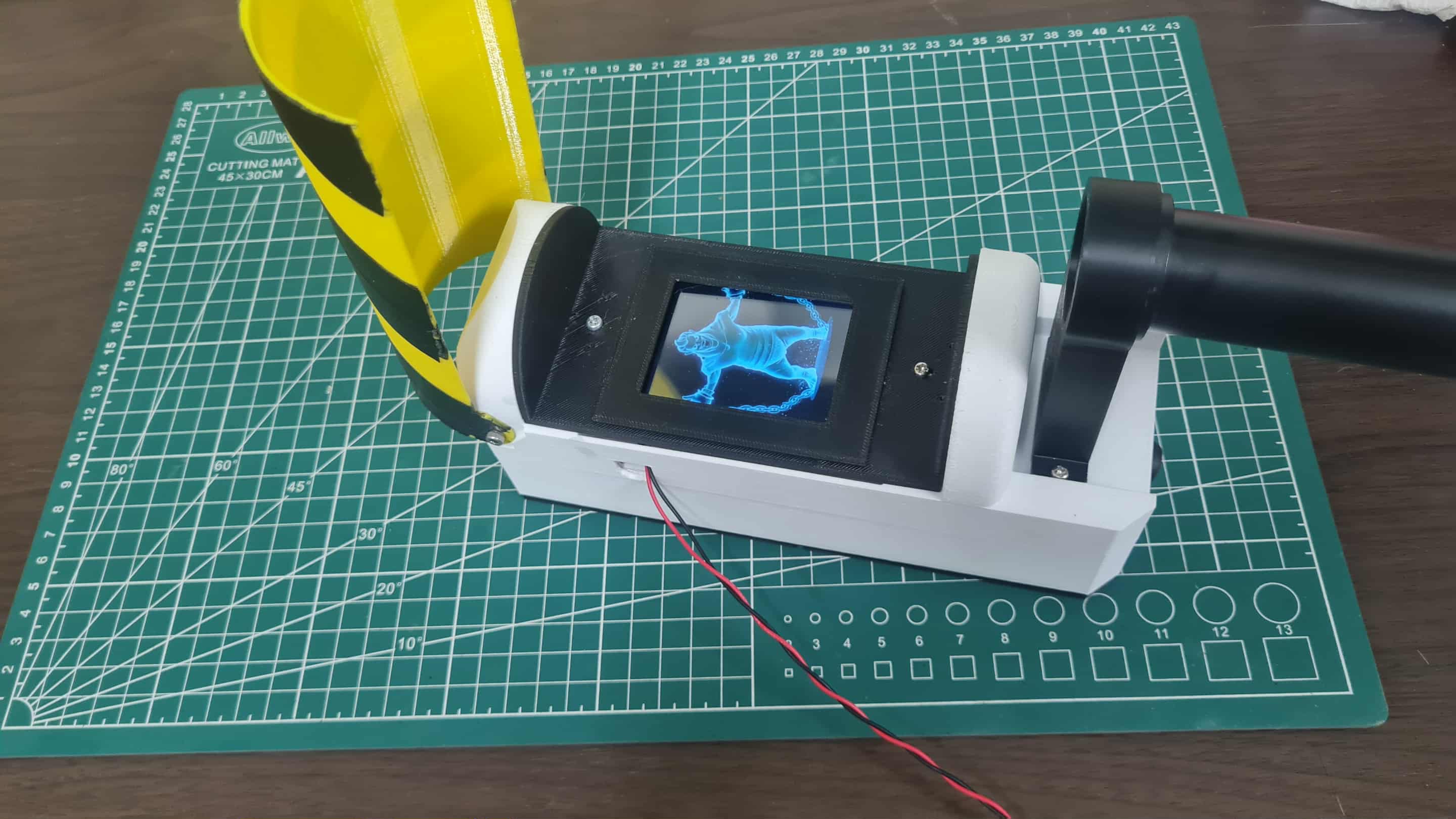

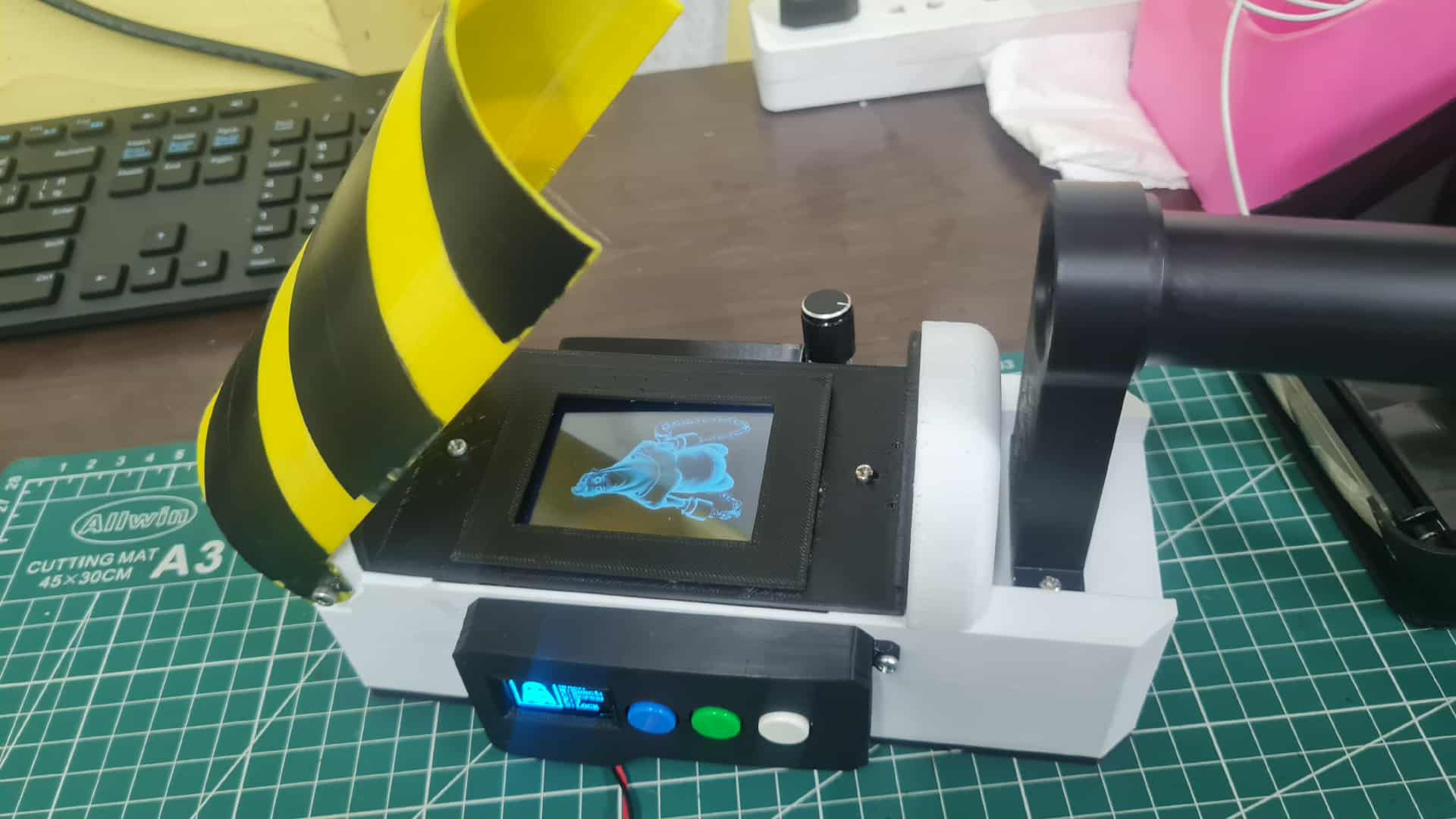

How It Works
- UNIHIKER, plays looping “ghost-in-the-box” videos using mpv.
- The transparent display creates the illusion of a trapped entity.
- RGB LEDs flash blue-red when the ghost moves.
- Eerie knocks and whispers come from the speaker.
- When the user touches the screen → the ghost calms down briefly before reappearing.

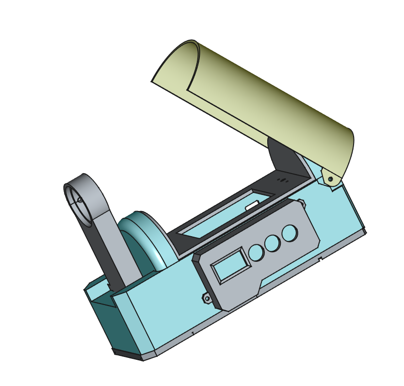

- 3D Print the Case
- Design in FreeCAD
- Include a viewing window to show the trapped spirit.
- Add engraved Ghostbusters logo or hazard labels.

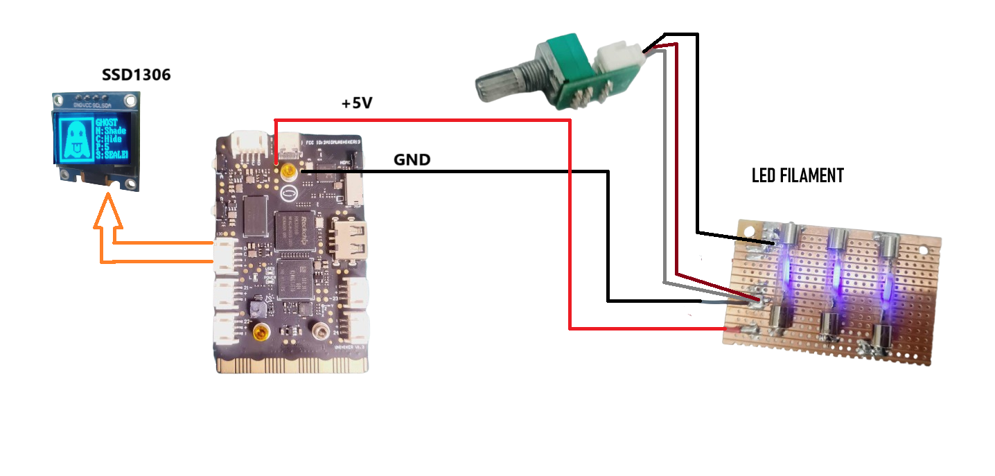

Step 2: Hardware
1.UNIHIKER M10 x 1
2.OLED SSD1306 x 1
3.3Dprint case
4.LED RGB WS2812

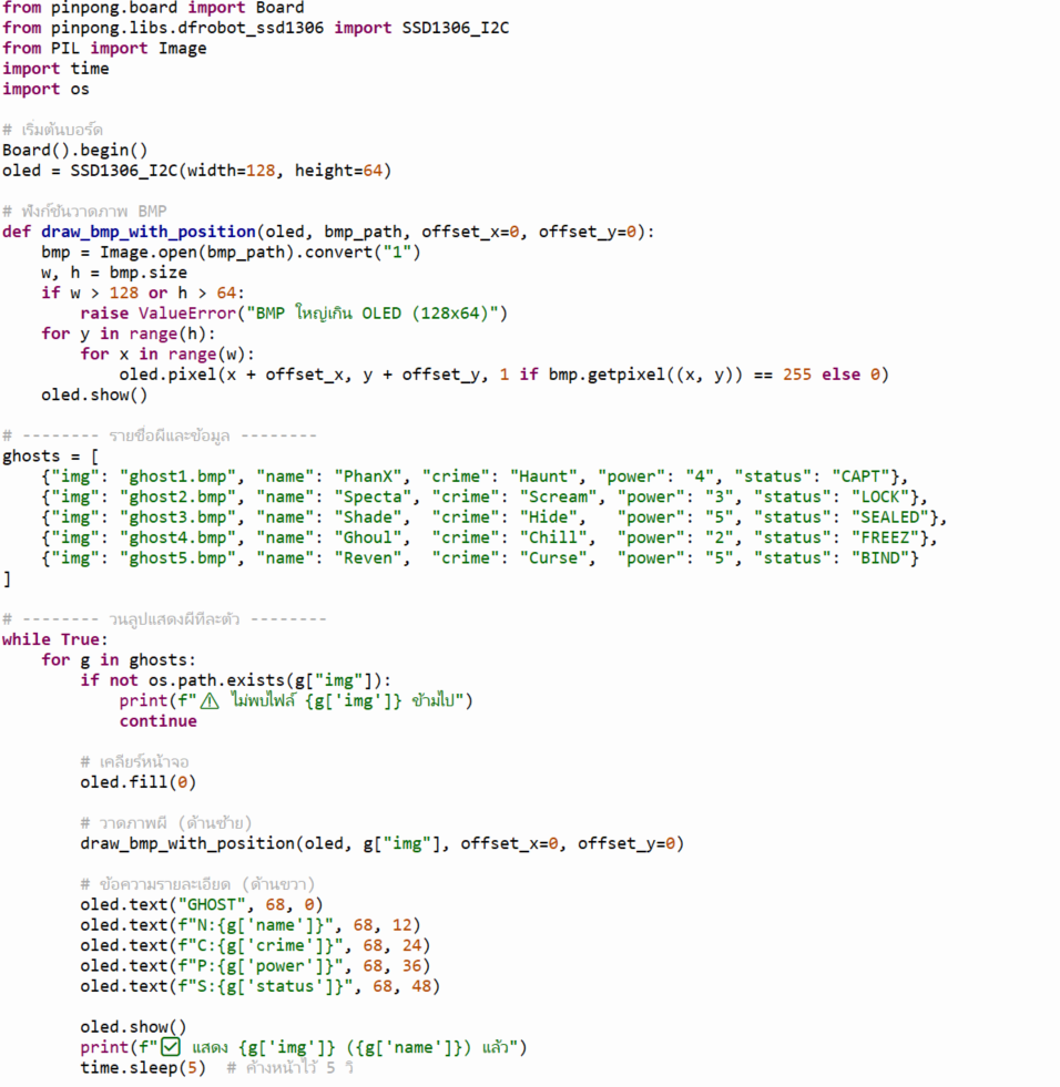

Step 3: Software
Python:
sudo nano ghost1.py
UNIHIKER,: Install
pip install moviepy
sudo apt install -y mpv python3-evdev
sudo XDG_RUNTIME_DIR=/run/user/$(id -u) python3 ghost1.py
sudo -E python3 ghost1.py
