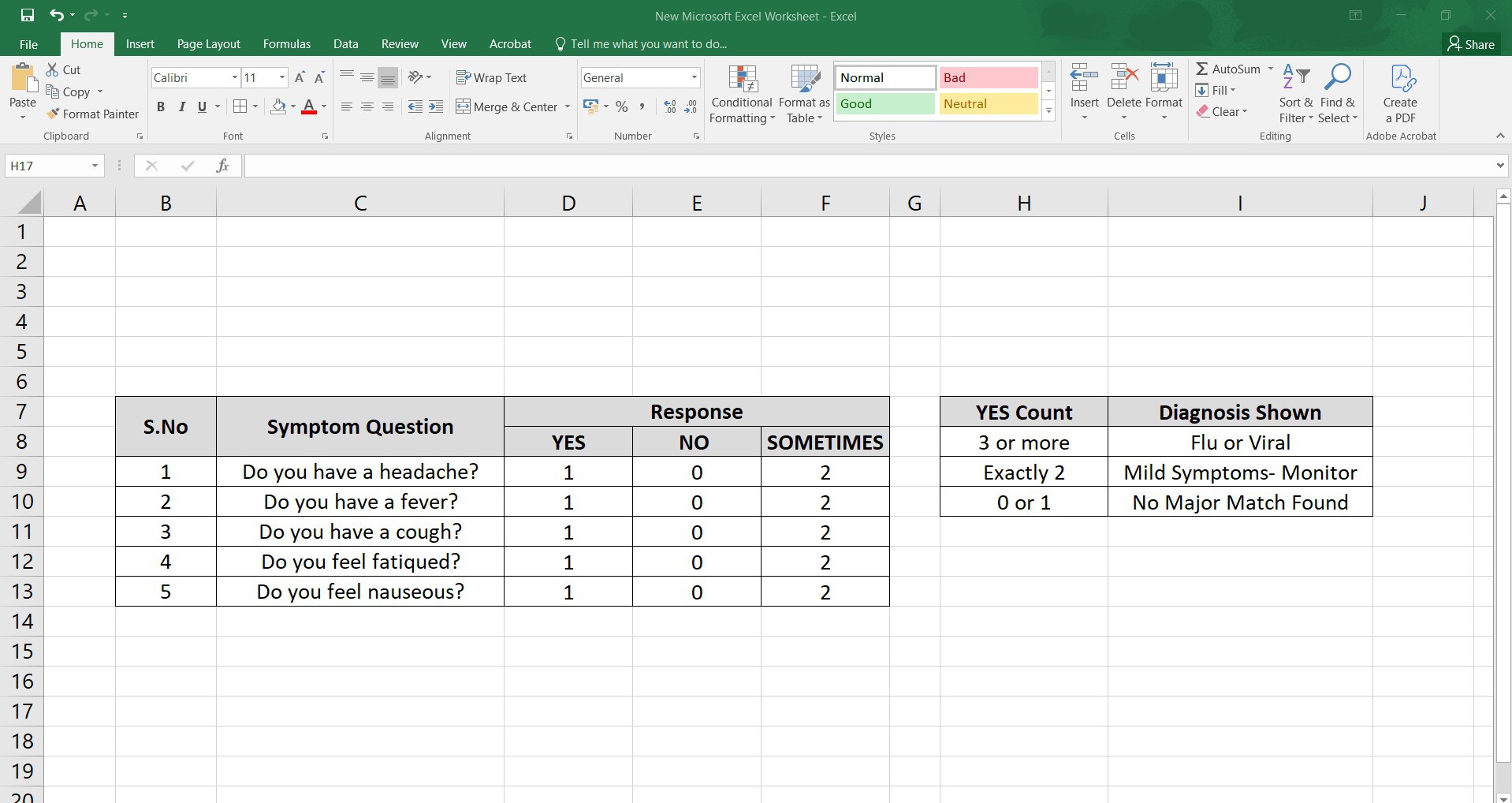

The idea came from observing how people respond to simple yes/no questions when describing how they feel. That’s where the logic started:
• Ask one symptom at a time
• Let the user respond with a button press
• Track the pattern of responses
• Offer a basic result or suggestion

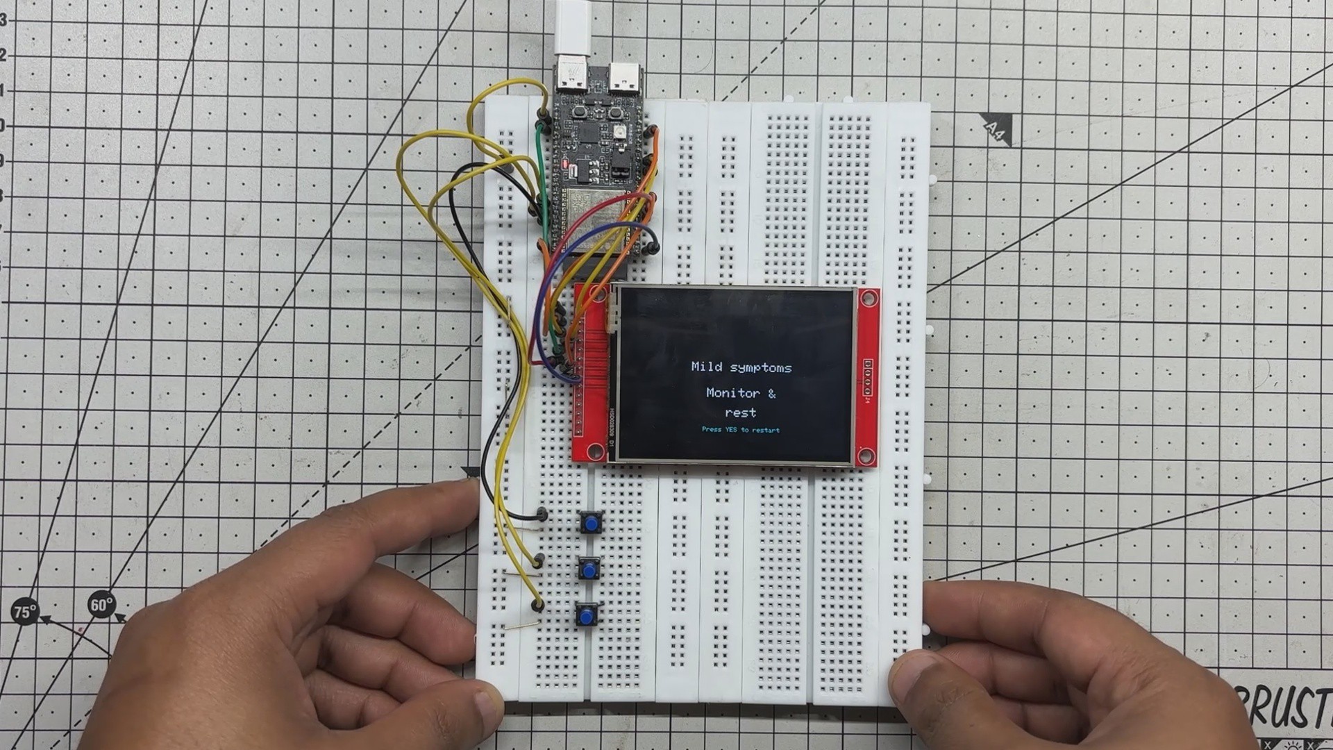

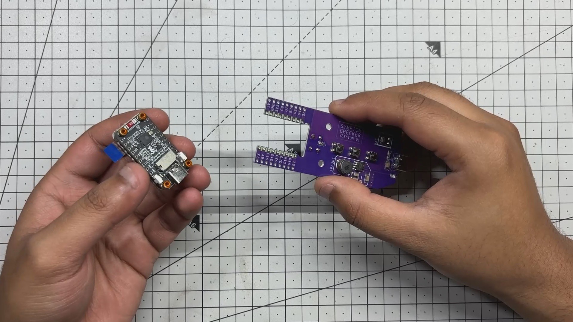

Basic Setup- ESP32 C6 Devkit Breadboard Edition
To get started with the electronics, I built a simple breadboard setup using the ESP32-C6 DevKit connected to a 320×240 ILI9341 display.
For user interaction, I added three tactile buttons—Yes, No, and Not Sure—mapped to GPIO pins. This setup served as our base model for testing the core logic and UI flow.
Once everything is working reliably, the plan is to shrink the entire system into a compact, handheld device using a custom PCB and a 3D-printed enclosure.

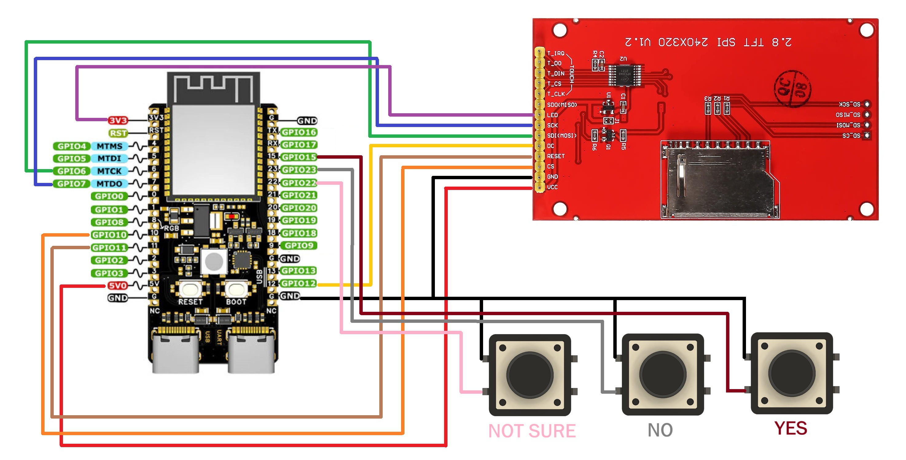

We started by placing the ESP32-C6 DevKit on a breadboard alongside a 320×240 ILI9341 display and three push buttons for user input.
Using the provided wiring diagram, we connected the display to the ESP32 Devkit in the following order.
  • DISPLAY's MOSI to GPIO6
  • SCK to GPIO7
  • Chip Select to GPIO10
  • Reset to GPIO11
  • DC to GPIO12
  • The LED Pin of Display goes to 3V3 of the DevKit.
  • VCC goes to 5V
  • GND to GND
This setup gave us a clean, testable base to test the UI and logic before moving on to a custom PCB and enclosure.

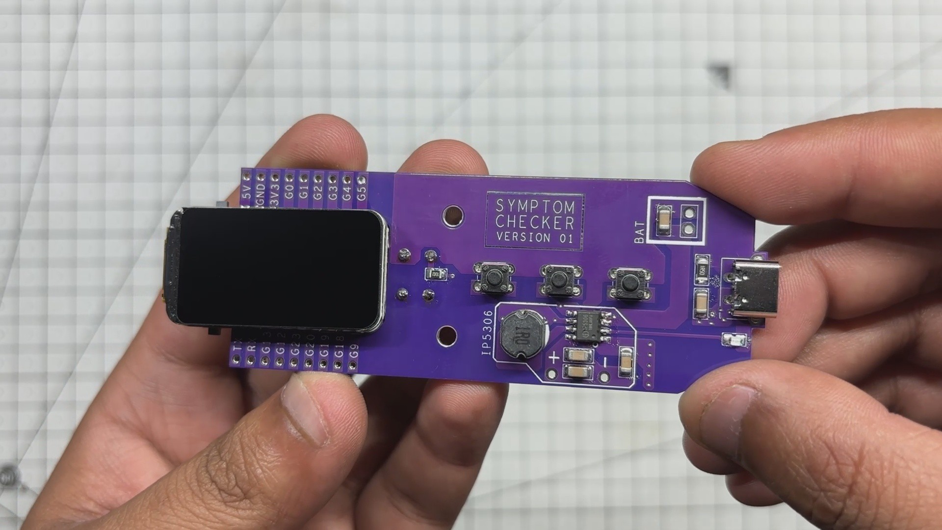

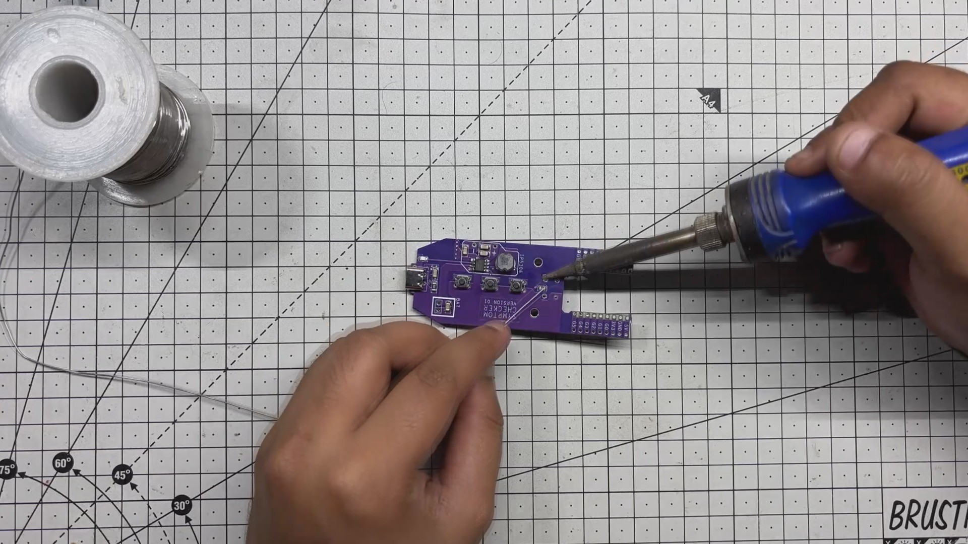

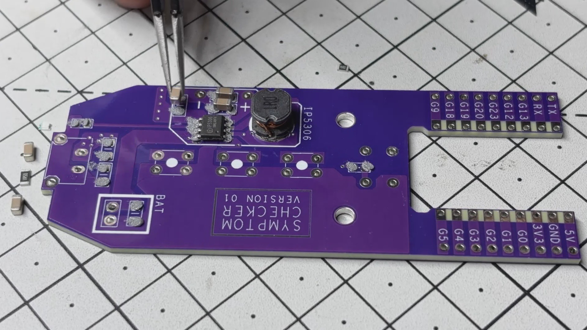

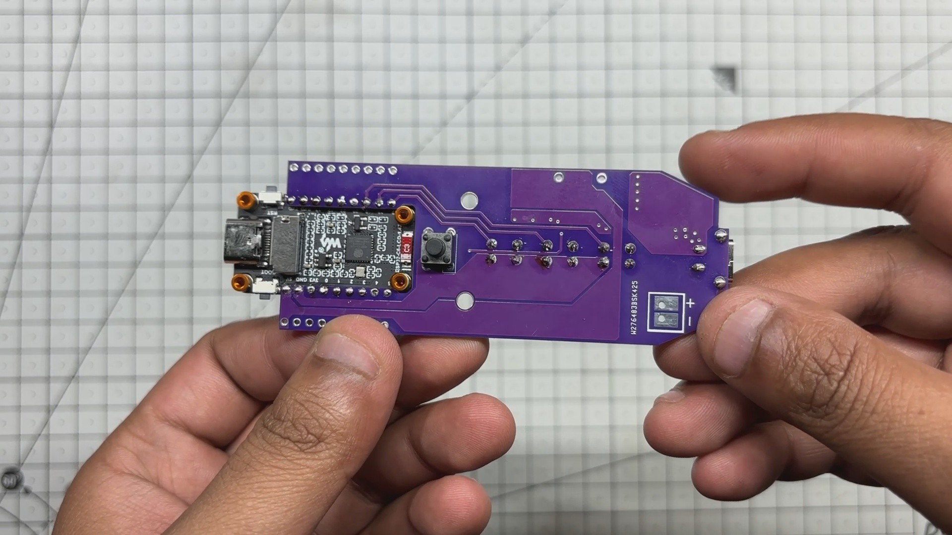

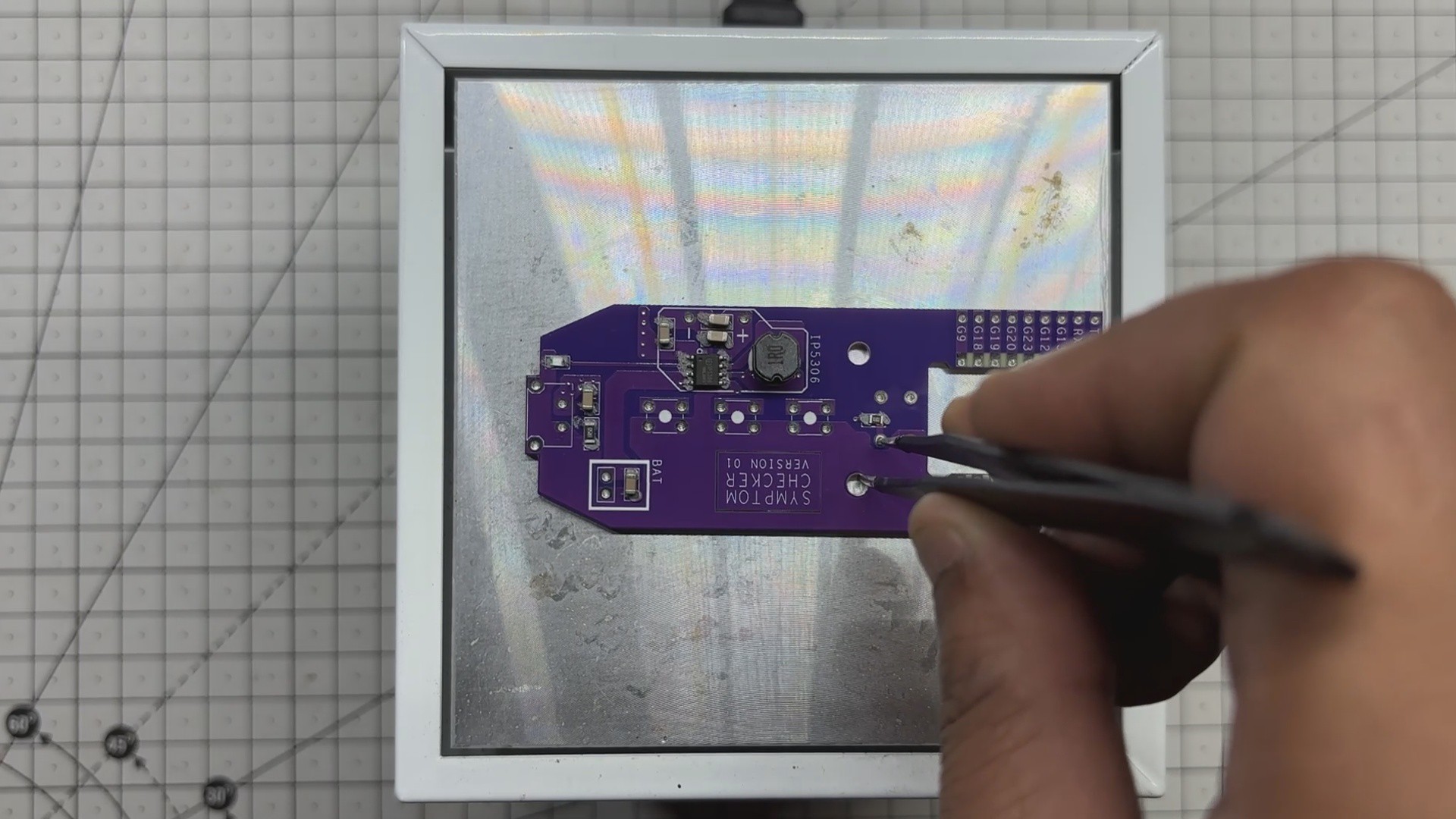

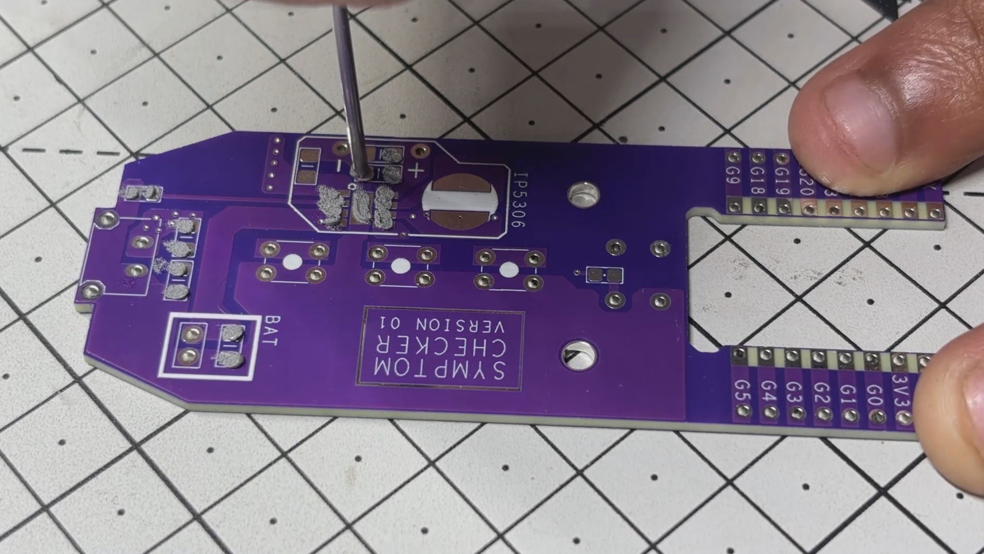

    PCB ASSEMBLY PROCESS
    • We start the PCB assembly process by applying solder paste to each SMD component pad using a solder paste syringe. We’re using 63-37 SnPb paste, which has a melting temperature of 200°C.
    • Next, we begin the pick-and-place process, which involves picking up SMD components using ESD tweezers and placing them in their designated locations.
    • Once placed, we lift the circuit and set it on our SMD reflow hotplate. The hotplate heats the PCB from below until it reaches the solder paste’s melting temperature. As soon as the PCB hits 200°C, the solder paste melts and secures the components to the board.
    • After that, we place a 6×6 tactile switch on the bottom side of the PCB and solder it in place using a soldering iron.
    • The rest of the through-hole components are added from the top side, including three 4×4 tactile switches and one Type-C port.
    • Finally, we place the Waveshare ESP32 board in its position and solder it using a soldering iron. We simply align it over the mounting pads and use excess solder on each pad to join the ESP32 board to the PCB.
  • 2

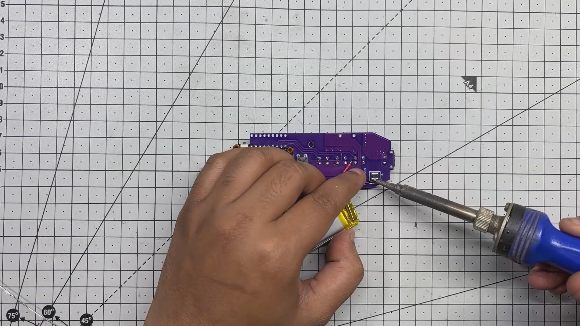

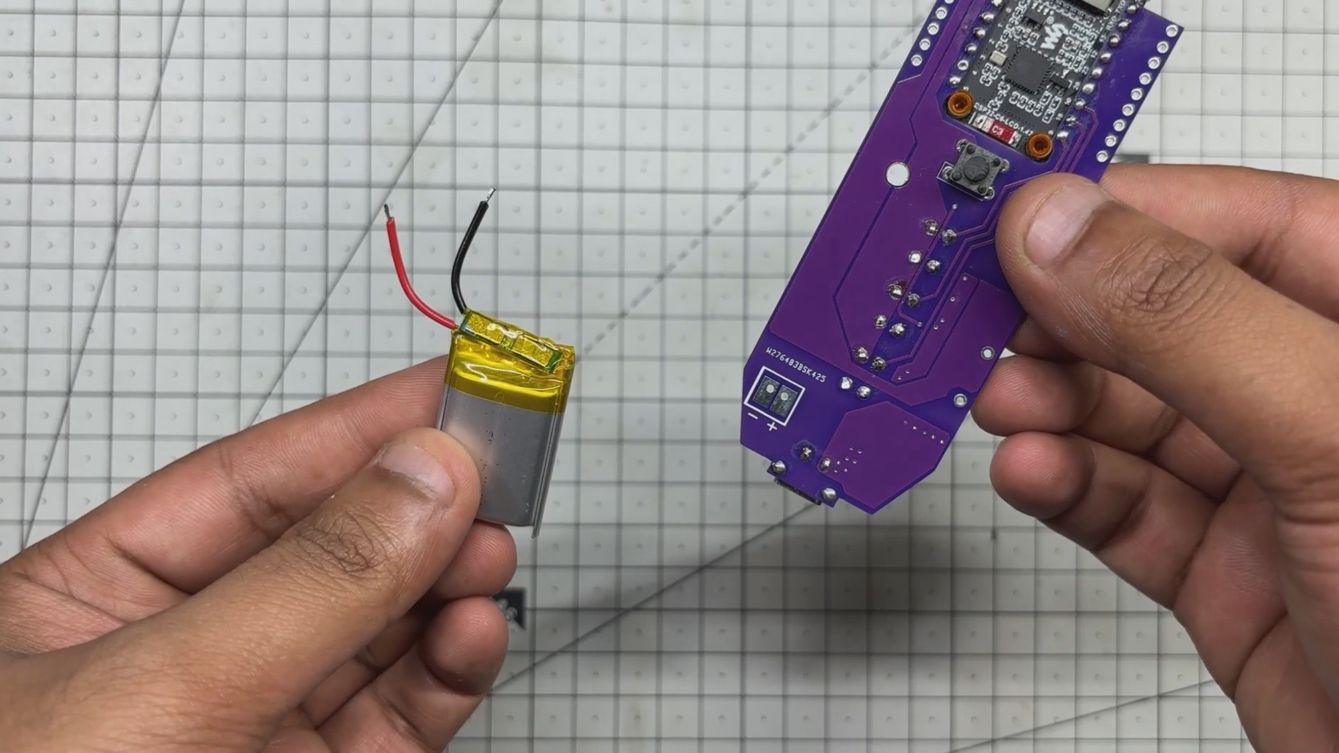

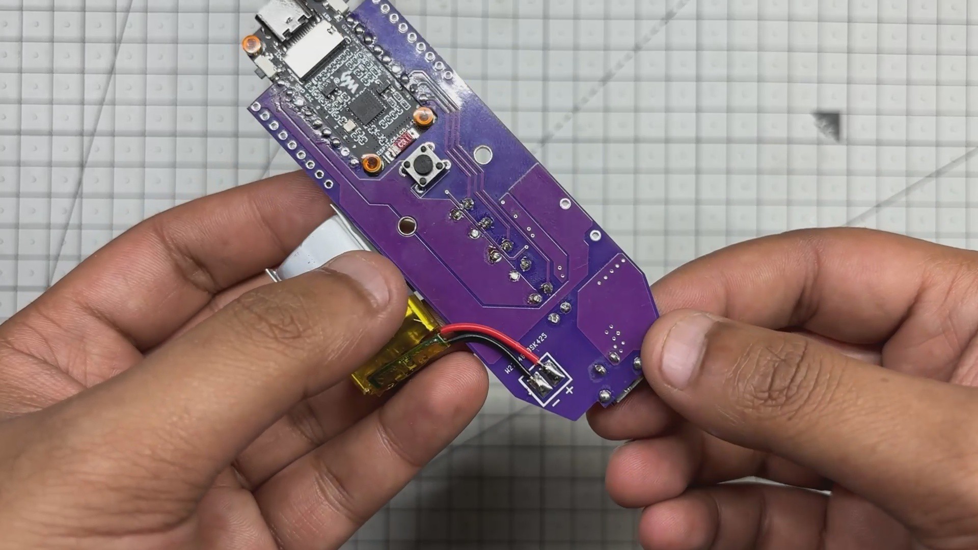

    POWER SOURCE
    For the power source of this project, we are utilizing a 3.7V 600mAh Li-Po cell, which can provide a total runtime of more than 10 hours, which is pretty decent, considering we won’t be using it continuously. After diagnosing, we can turn the device OFF, which gives us a backup of 2–3 days depending on usage.
    We solder the positive and negative terminals of the lithium cell to the battery connectors provided on the circuit.

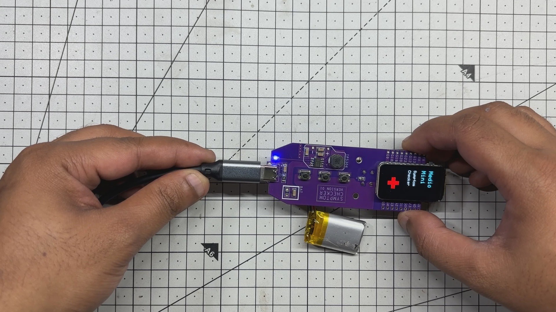

    By pressing the 6×6 tactile switch added on the backside of the circuit, the device turns ON. Double-tapping the switch turns the device OFF.
    We can also charge this setup by plugging in a 5V supply via the provided Type-C port. During charging, the indicator LED will blink, and it turns stable once the lithium cell is fully charged.
  • 3

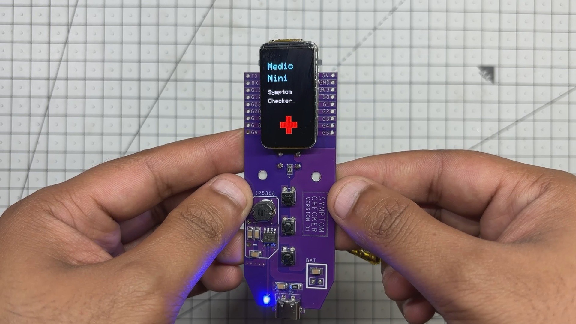

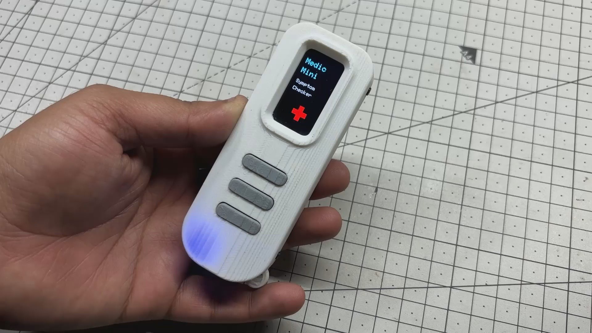

    CODE for Waveshare ESP32 C6 1.47 Display
    This is the finalized code running on the Medic Mini device. It differs slightly from our earlier demo sketch due to changes in the display and I/O configuration. The demo version used an ILI9341 display with the ESP32-C6 DevKit, which required a different set of GPIO assignments and library setup.
    In contrast, the final build uses the Waveshare ESP32-C6 1.47" display module.
    The below Breakdown highlights all the key differences introduced in this updated sketch.

    In our main sketch, we use the Arduino GFX Library to drive the ST7789 display.
    The following configuration sets up the screen dimensions, rotation, and offset parameters tailored to the Waveshare ESP32-C6 1.47" module.
    Arduino_GFX *gfx = new Arduino_ST7789(bus,LCD_RST,2,          // rotationtrue,       // IPS172,        // width320,        // height34, 0,      // X offset34, 0       // Y offset);
    We configured the pin mapping to match the default wiring of the Waveshare ESP32-C6 1.47" display. These assignments were based on the official Waveshare Wiki documentation.
    #define LCD_MOSI 6#define LCD_SCLK 7#define LCD_CS   14#define LCD_DC   15#define LCD_RST  21#define LCD_BL   22
    Next comes the button input.
    #define BTN_YES     9#define BTN_NO      18#define BTN_UNSURE  19
    The rest of the code logic remains unchanged from the previous demo sketch. The only modifications made here are the updated display configuration and revised input button mappings to match the final hardware.
    We uploaded the code into our ESP32 board and moved onto the next step, which was the enclosure assembly. From next, we cannot upload code into ESP32 because its USB will be inaccessible.
