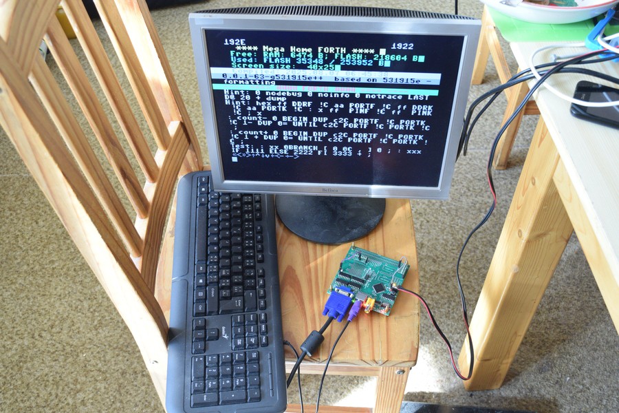

This 10 cm x 10 cm PCB will serve as Single Board Computer now, to develope software for display VGA/RCA based 40x25 character screen (and maybe later 320x200 graphics), managing PS/2 keyboard, SD card, USB Serial communication (with RTS/CTS flow controll) and maybe also other SPI and I2C periferials (like RTC). It will use external RAM and while developing it will also use FORTH as main system/language. Finally it will serve as graphic and I/O card for 8bit computer based on HD6309 processor. This is second PCB (so MHF-002), with more than 75 improvements over previous PCB (called MHF-001). PCBway.com generously sponsored manufacturing both those boards. Their work is flawless, easy to use, easy to solder/desolder and repeatedly resolder chips while testing different configuration and software options. Those improvements are result of actually using the MHF-001 board and adress discovered flaws in my design. Even with lot of reworks no trace nor pad was damaged during the tests
Current status:
MHF-001 proved, that VGA signal can be generated clean and stable. Due bad PORTs assignment was characters little distorted, this should be fixed on this new card. Also I failed to solder the external RAM perfectly, due footprints oriented for machine work, not hand soldering, so it sometime worked, sometime not and preesig it by hand improved the chace for right results. New version have much longer pads on footprints, which I can solder reliably.
More similar improvements was discovered over time, but basicaly I was able somehow confirm all wanted features.
Software needs be rewritten for new port usage and for better functionality. It is just matter of time and effort.
FORTH helped very much, as it allows interactivelly program the atmega over keyboard or serial line, without recompiling and uploading everything from start for any and every action wanted.  Interactivity simply rules :)

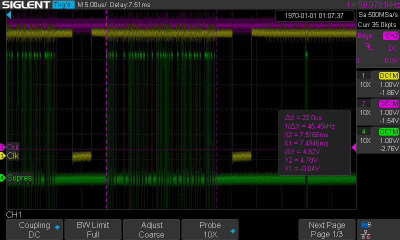

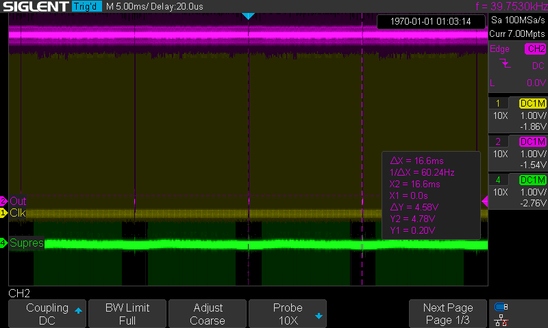

    VGA need Vertical Sync (at start of each screen), Horizontal Sync (at start of each line) and Signal (inside the line, it is the pixels).
    Vertical Sync is generated by timer on pin PE4 (every 16.64 mS ~ 60 Hz)
    Horizontal Sync is generated by timer on pin PB6 (every 32 uS)
    VGA signal is generated in interrupt on timer overflow (every 32 uS = each 512  clock ticks)
    Here are some osciloscope snaps, the magenta line is VSync, yellow line is HSync and green is Signal (sorry for wrong naming in picture)
    (4 screens at 60Hz)(1 line with pixels, 32uS)

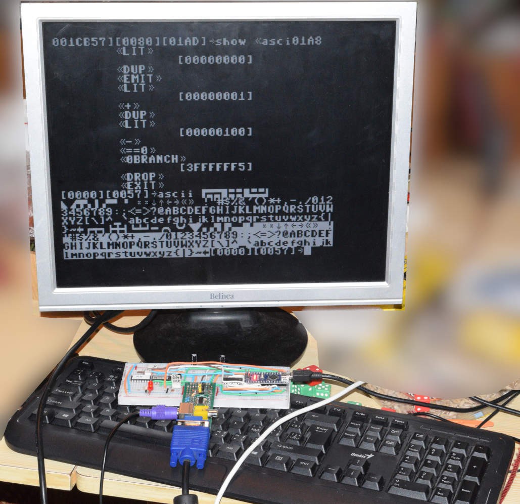

  • How it started
    Gilhad7 days ago 0 comments

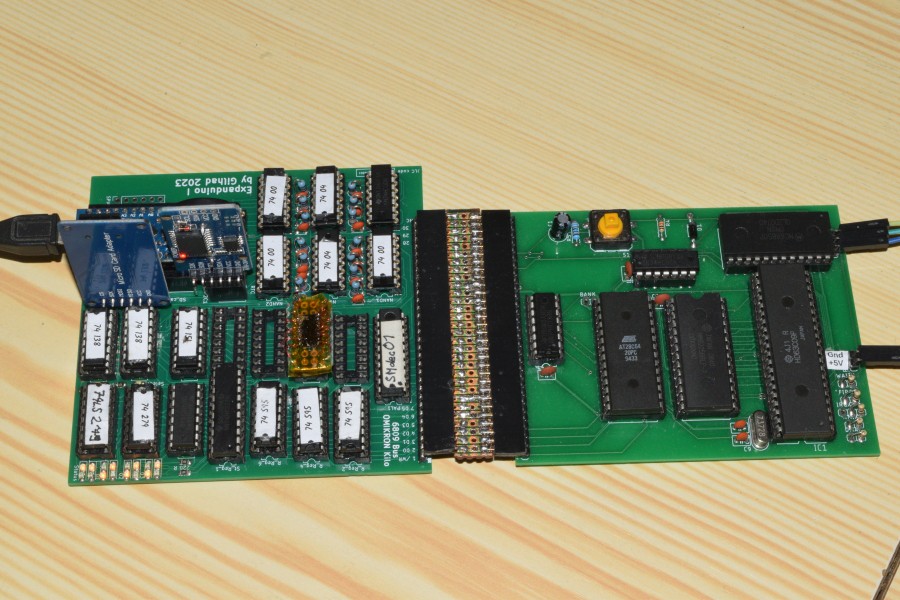

    Many years ago I bought  Omen Kilo (SBC with HD6309) and start to play with it. It worked, but did not anything visible (does it even run?), just communicated over Serial.
    So I invented and constructed card for 8 serial channels and called it Expanduino (pages in Czech only and incomplete), as it was Arduino based.
    It worked somehow, but was mechanically unreliable, slow and did not allowed for more extensions.
    So I decided to make my own design from the start and make it simply extensible, so it culd have everything a computer needs - output to some monitor, input from keyboard, filesystem to store and load data and programs, ports and so on and so on. This was not SBC anymore.
    I also found Composite video from Arduino UNO from ceptimus and Squeezing Water from Stone 3: Arduino Nano + 1(!) Logic IC = Computer with VGA and PS/2 from slu4coder which looked like solution for the video output. I use their ideas (and many others) and reworked it to system, which can switch between VGA and RCA even on runtime. This looked as good foundantion for videocard I wanted.
    First public presentation was on 2024 Maker Faire in Prague, in form of Computer at price for dinner as proof of concept.
    I then expanded it to FORTH driven breadboard computer NanoHomeFORTH and started work on even better version with more RAM and power.
    I called the project MegaHomeFORTH, as it was based on Arduino Mega, but then I discovered, that the most importaint pin (16MHz clock) is not accessible on Arduino Mega, nor on Arduino Mega Pro, so I went to make my own board, where it will be all included.
