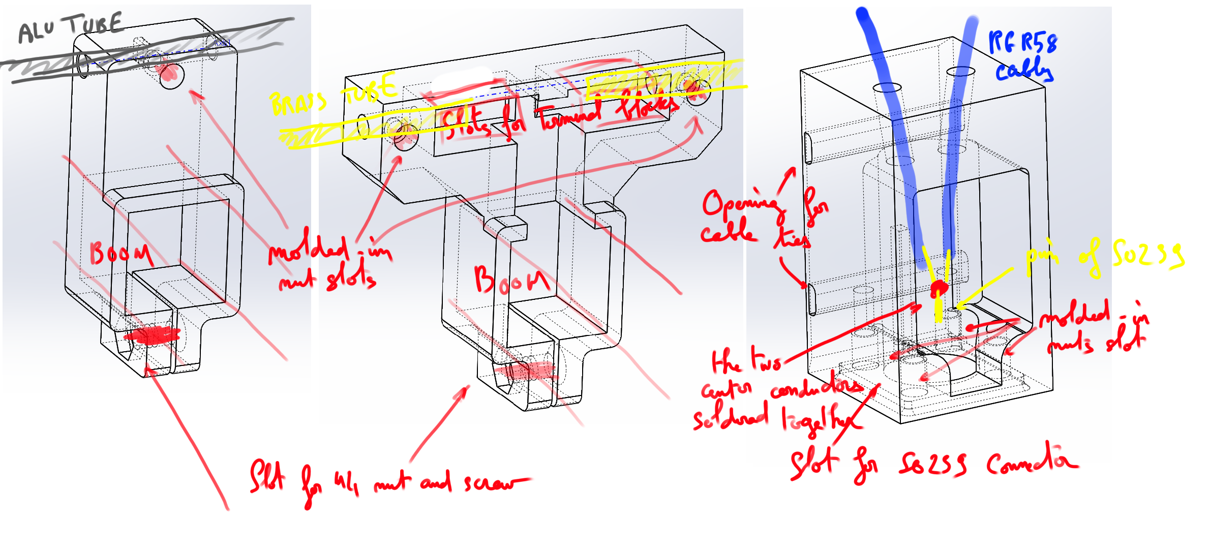

3D printed holder

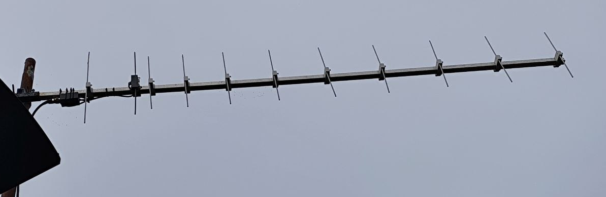

Here is a view of the three parts to be 3D printed in PLA (it would also work with ABS or PC, but the antenna shown in the photo above has been installed outdoors for two years, is still working, and has survived two summers).
The AMF files are attached in the files projet.
From left to right: passive element holder, driven element holder, and the "case" used to secure and protect the SO239 connector.
You can see the recesses for M4 countersunk screws and the matching hex slots for the nuts, which allow precise and secure positioning of the holders on the boom.
On the "case," you can see the two openings for cable ties, used to attach the enclosure to the boom, between the driven element and the reflector.
