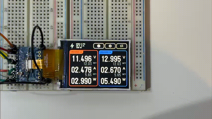

First UI demo running on the Embassy embedded framework, written in Rust!
Side thing: I love programming. Rust had popped up on my radar a while back, and I've been searching for an excuse to use it since. I found...

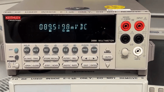

    A Keithley 2000 in the ELAB at DESY particle accelerator. Hamburg, Germany. I had a short chance to take a few measurements with it...
    Now, with 6 and 1/2 digits acquired, let's move on to some actual testing. Its (surprisingly) loud fan accompanies the tests hereafter.

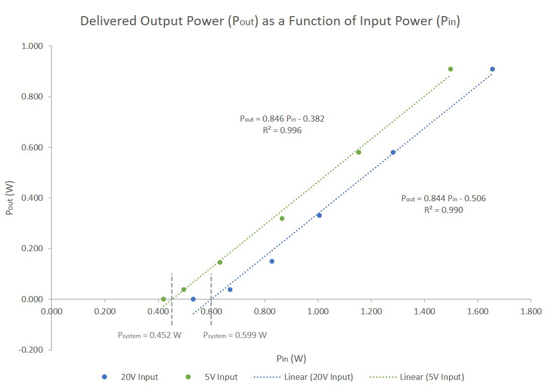

    With different loads attached (<1W) to the output, and measuring both the input and output power, voltage and current, I can do a little graphing.
    Fig. 1. Delivered output power to the load as a function of USB Type-C Power Delivery input power supplied by a standard 100W phone charger.
    Pretty neat, and pretty linear. 84.6% efficiency at a 5V input; 84.4%, 20V. Calculating the x-intercept yields the minimum power required for the MCU, display, and control systems to run. Pretty happy with <1W consumption for those, considering the MCU needs to run a whole power supply system, and its user interface.
    Higher power tests will definitely come after. I've just gotten around to get it to output 24.918W at 11.995V output, and 27.06W USB Type-C at 19.53V input, as a short test. (That's the values shown on the first image of this update.) Subtracting the 0.599W needed at 20V to run the system, and dividing yiels 94.2% efficiency! That's not too bad at all. Definitely, I'll need to get a variable electronic load to sweep through a range of output powers to test further.
