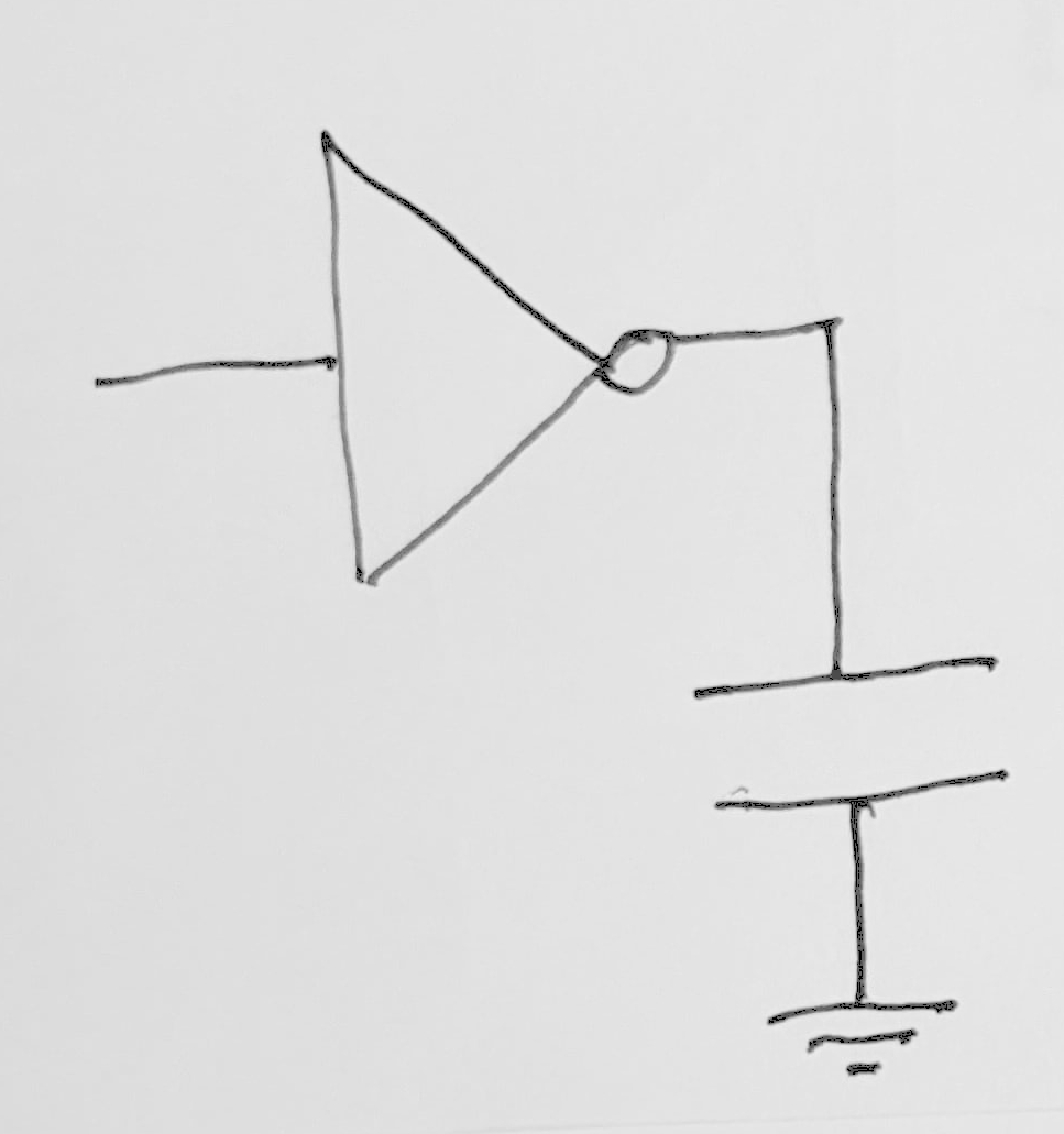

Digital Logic Design Rule 1:
Don't load outputs with large capacitances - it slows the edges and can cause metastabilities.

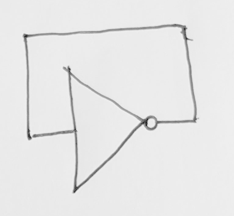

Digital Logic Design Rule 2:
Don't connect a logic gates output to its input.

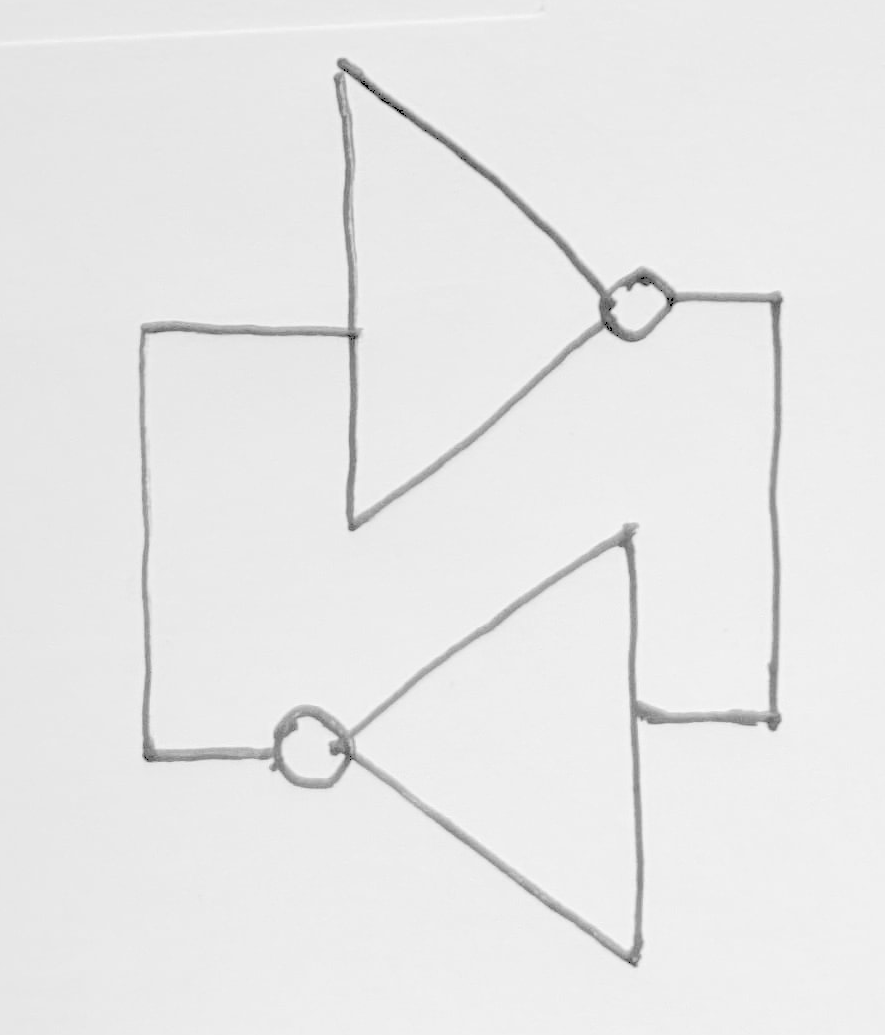

Digital Logic Design Rule 3:
Don't connect gates in a loop unless you have inputs to control the latching.

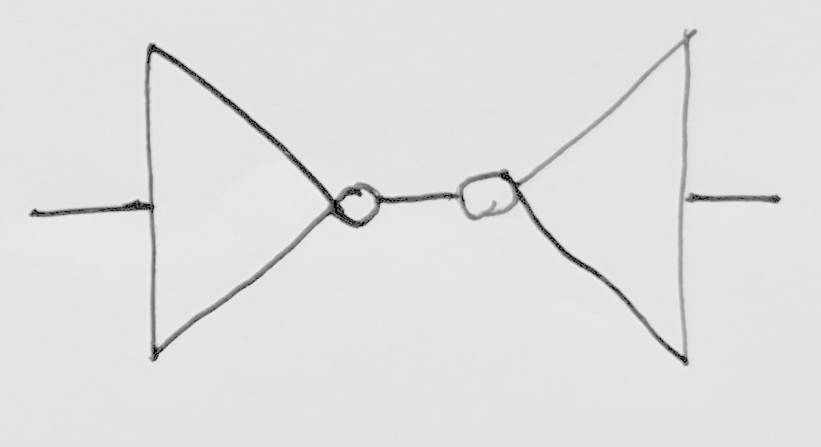

Digital Logic Design Rule 4:
Never connect outputs to each other.
