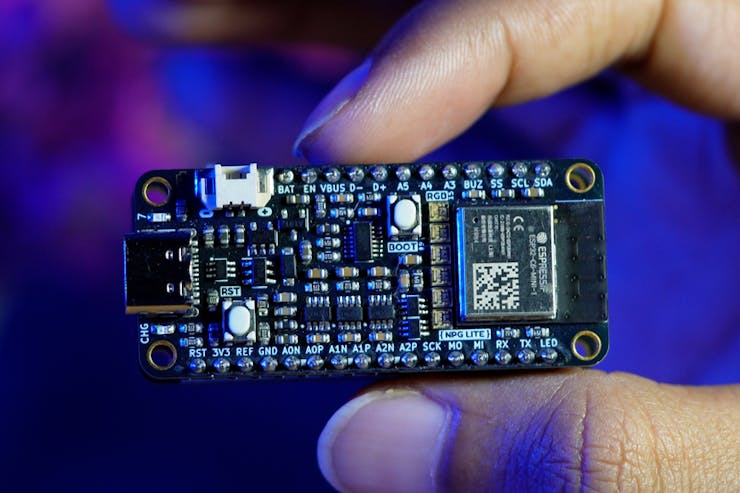

Powered by the NPG Lite Device
Neuro PlayGround (NPG) Lite is a compact Adafruit Feather form factor, a multi-channel wireless biopotential signal amplifier designed for EMG, ECG, EOG, and EEG recording.
It offers Wi-Fi, Bluetooth, Zigbee, and Thread connectivity, along with patient protection, LEDs (User LED, charging LED, six addressable RGB LEDs), buttons (Reset and user button), LiPo battery charging, and USB-C with ESD protection. Its lightweight and user-friendly design makes it perfect for research, education, and wearable applications.

Neuro PlayGround Lite (NPG Lite)

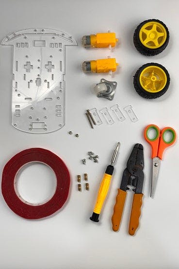

Car Chassis Kit
Car Chassis Kit

  • NPG Lite Device
  • Snap cables + electrodes (or alligator clips)
  • Nuprep + alcohol wipes
  • USB-C cable

  • Robotic chassis (e.g., VoidBot)
  • 2 × geared DC motors (6V–12V)
  • Motor driver: MX1508/ MX1616
  • XIAO ESP32C6 board (receiver)
  • LiPo battery
  • Slide switch
3. Tools
  • Soldering iron + wires
  • Screwdriver

    Step 1: Hardware Assembly
    A. Build the Robotic Car
  • 2

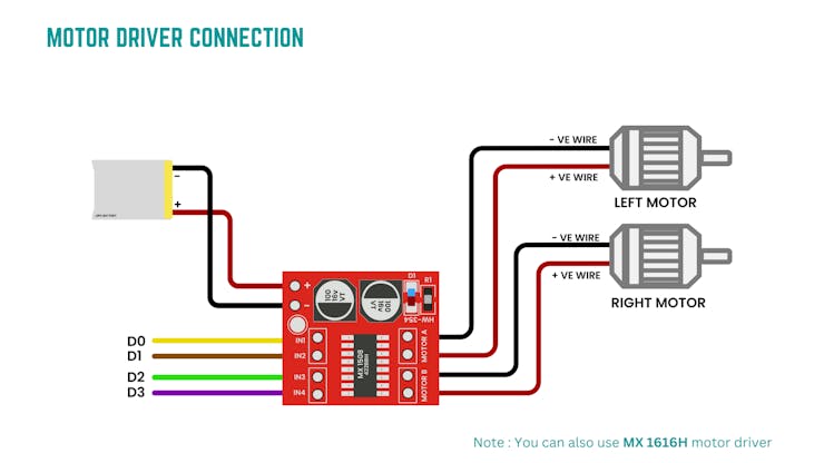

    Step 2: Motor Driver Connection
    • Connect motors to the driver: Motor A → Left wheel, Motor B → Right wheel.
    • Power the motor driver MX1508/ MX1616
    • Wire the motor driver inputs to the XIAO ESP32C6 receiver pins.

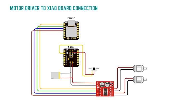

  • 3
    Step 3: Motor Driver to XIAO Board Connection
    • Secure all wiring and components to the chassis like this and the final setup should look like this.
