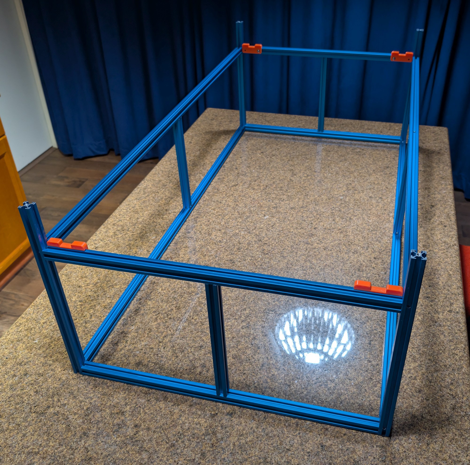

Structure
I made a support frame from blue anodized 2020 t-slot.
Arrakis 3.0 support frame
Arrakis 3.0 support frame corner detail
Arrakis 3.0 support frame corner detail showing 3D printed TPU rest for the mechanism frame

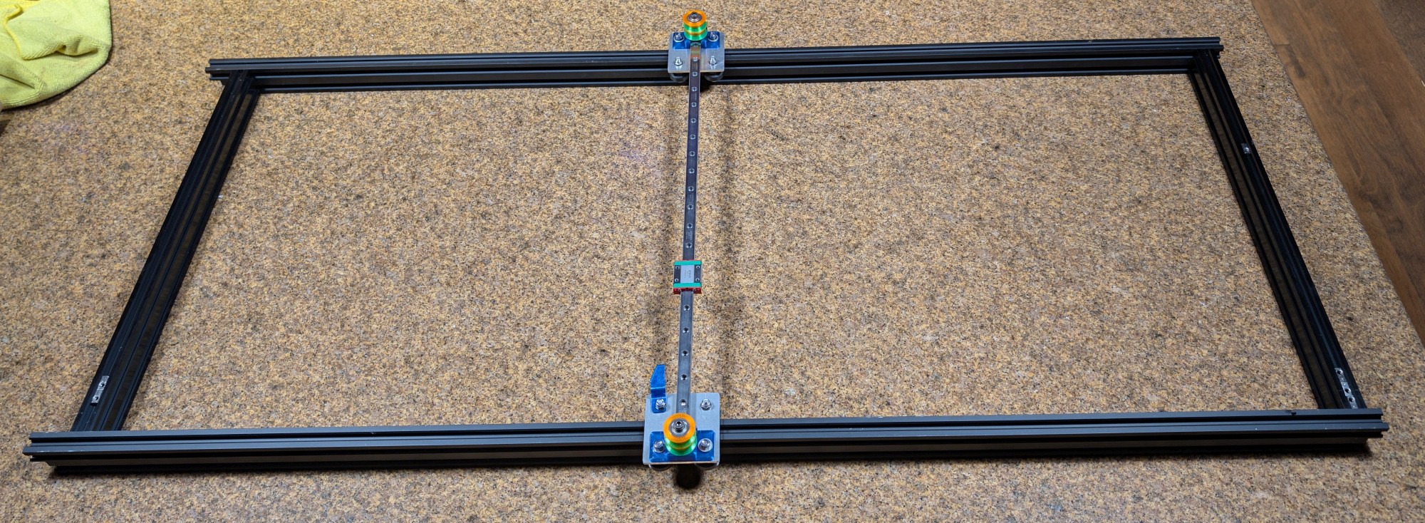

The mechanism frame is made from black anodized 2040 v-slot and drops into the support frame, resting on 3D printed spacers that center it in the frame.
Arrakis 3.0 mechanism frame
Arrakis 3.0 mechanism frame made from 2040 v-slot
One of the mechanism frame corners. The cut-out allows the frame to hang on the support frame.
Arrakis 3.0 mechanism frame mounted in the support frame
All the t-slot and v-slot pieces were milled square and tapped, and screw directly to each other without any corner braces.

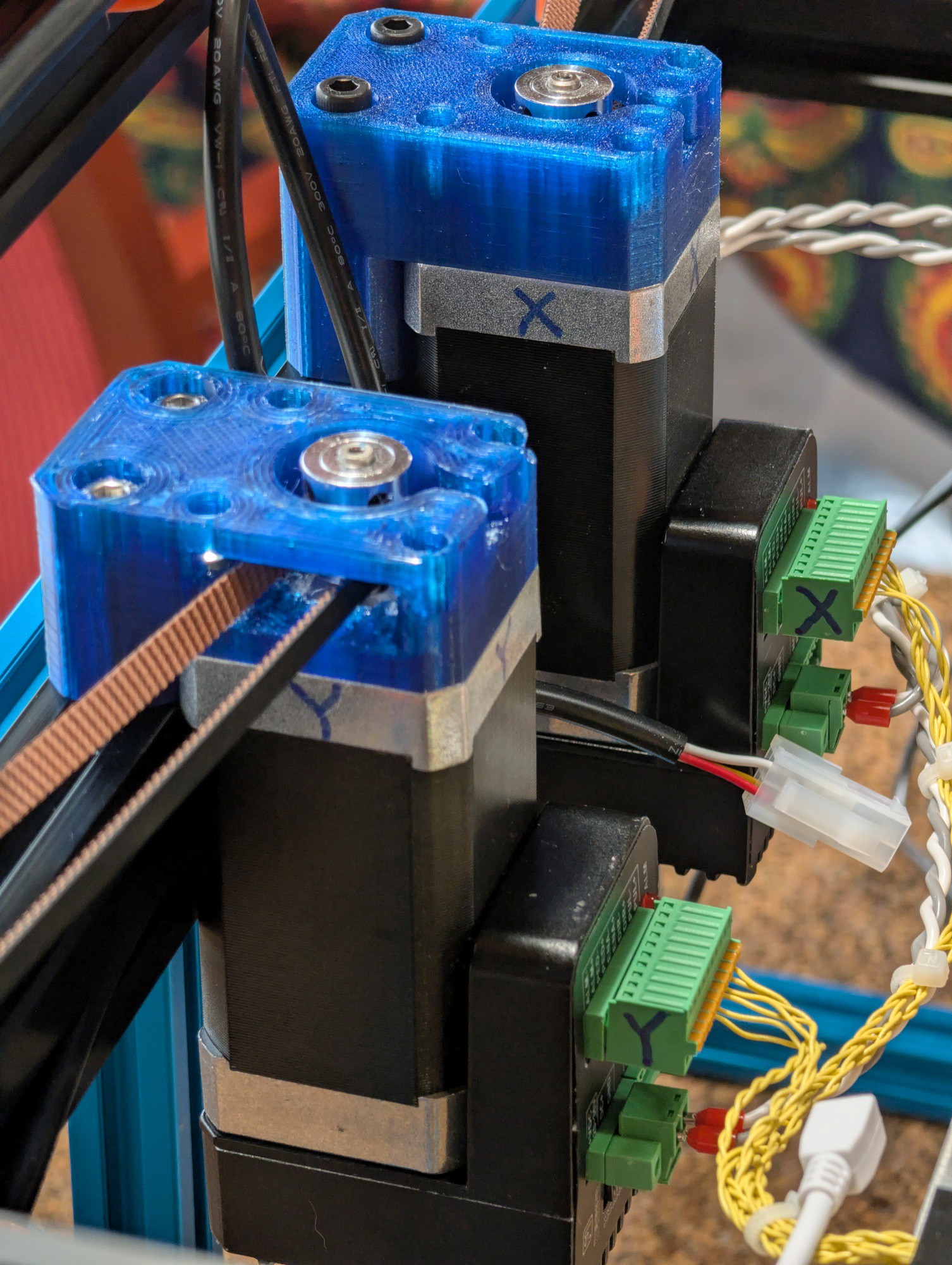

The mechanism is a stacked belt coreXY type driven by cheap, Chinese-made iHSV servomotors with 20 tooth pulleys. Belts are 6mm wide 2GT type commonly used in 3D printers. The motors are mounted on 3D printed mounts at one end of the mechanism frame with a twist in each belt so that the belt teeth touch only the drive pulleys, helping to keep noise down. The idler pulleys are made using stacked F625 bearings in 3D printed concave flanges that prevent the belts from squeaking.
The Y axis (the long one) uses wheeled carriages that roll on the v-slot frame. The X axis is a 12mm linear guide with each end screwed to the wheeled carriages.

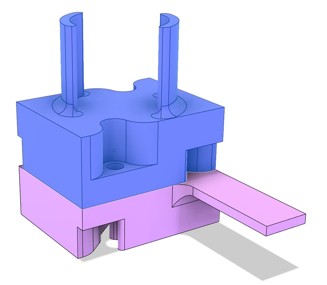

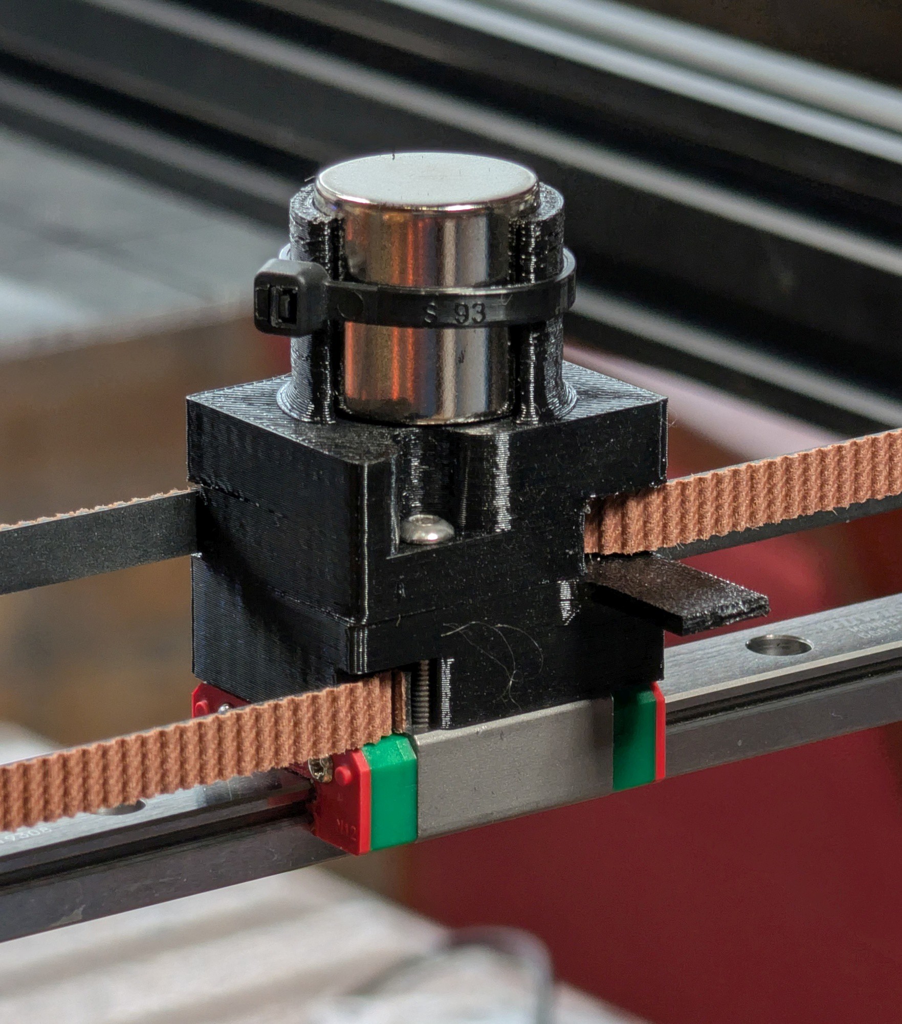

The magnet is a 20 x 20mm cylindrical N52 neodymium type. The magnet carriage/belt clamps are 3D printed parts that screw onto the bearing block on the X axis linear guide. The belt clamps hold the ends of the belts with the teeth interdigitated in narrow slots that don't allow the ends to separate. There is a 3mm air gap between the magnet and the bottom of the sandbox.
Arrakis 3.0 magnet carriage/belt clamps
3D printed PETG magnet carriage/belt clamps. I printed the X flag extra long and trimmed it to size once it was installed in the table.
Belt clamps/magnet holder CAD render.
Lower belt clamp showing how the ends of the belt fold back on themselves. The upper clamp works the same way. I printed the flag extra long then trimmed it to size after installing it in the table.
Belts are tensioned by sliding the motor mounts along the slots in the frame.
3D printed PETG motor mounts, bolt to the mechanism frame using t-nuts. The mounts are designed with clearance so the belts never contact them.
