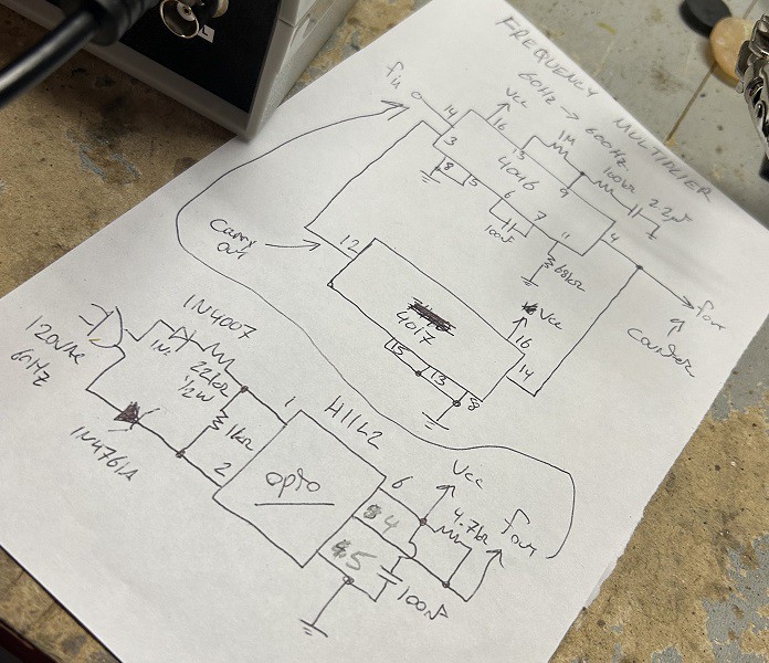

The initial test after the conversation came as a PLL frequency multiplier driven by the line via an opto-coupler and connected to a TTL frequency counter I had previously built. I had wanted to experiment with PLLs so this was a good application to use one and add another digit to the frequency measurement.

The other end of the "AND" gate (created by the two NAND gates) is fed from the final version of the PLL circuit

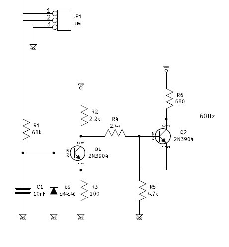

The last thing was I planned to power this with a low voltage transformer and tap the frequency off of one side of the winding. I wanted to use a Schmitt trigger to clean this signal up before multiplying it. I didn't want to add a CD4093 and use only a 1/4 of the IC. I recalled hearing about building a Schmitt trigger from discrete transistors, so I looked that up and decided this was a perfect project to implement it in. I found this wonderful write-up by John Hearfield (https://www.johnhearfield.com/Eng/Schmitt.htm). With a few tweaks, I drew up a circuit that cleaned up the AC signal and make a very clean square wave for the multiplier.

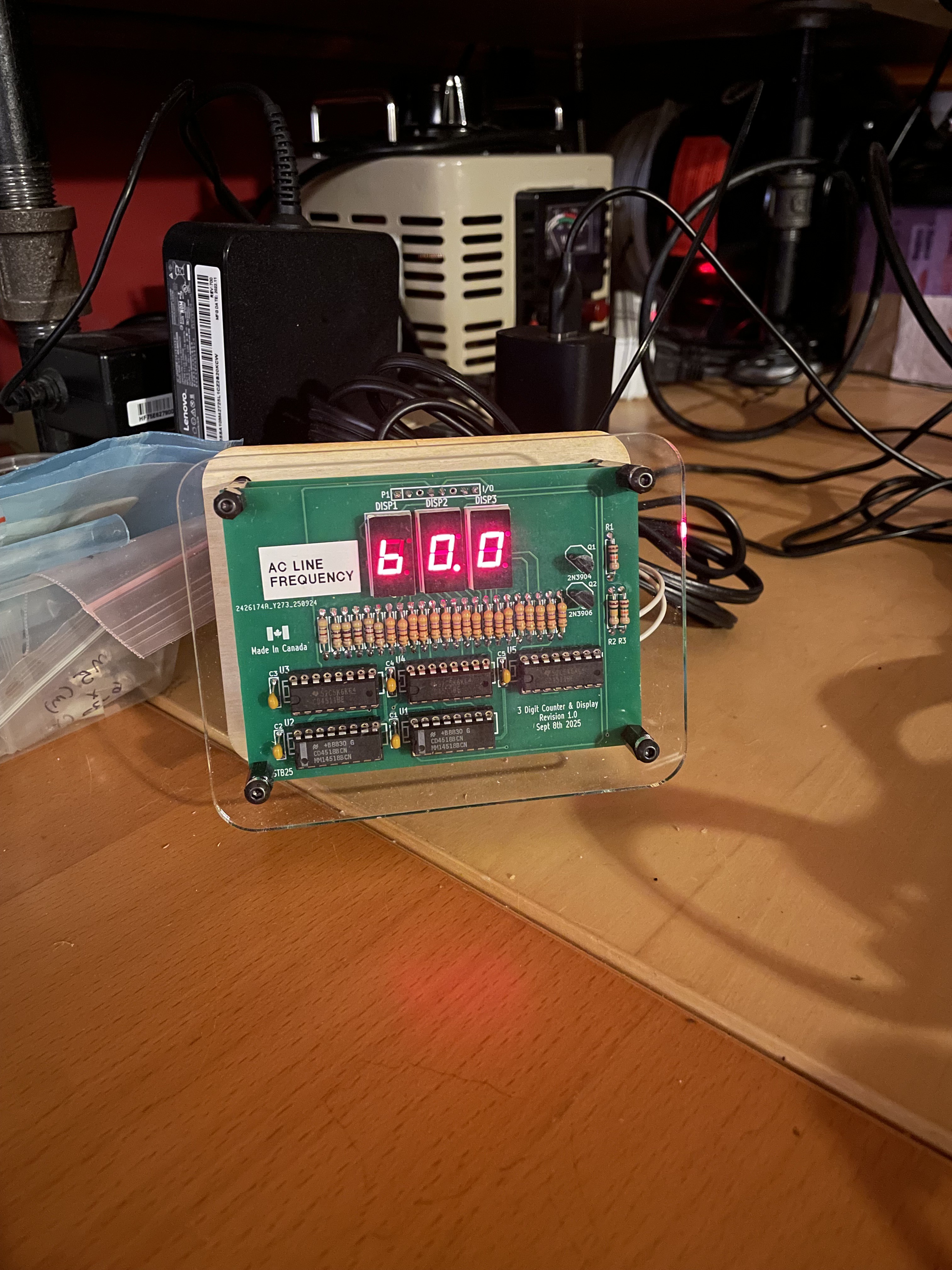

In terms of the display for his device, I built a counter/display board that uses two CD4518 Dual BCD counters (using only 1.5 of them) and then three CD4511 display drivers with integral latch. It worked out quite well, but made for a much more complicated implementation than the TIL306/7 units.

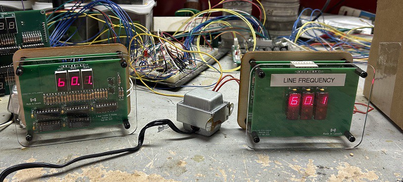

Here is both devices on my bench before I sent one out. The displays used on the unit for my friend were some new old stock MAN71 units.
Honestly at this point these will be more eye candy on the bench than anything else. But they were fun to build and I enjoyed exploring a few different circuits in the process.

    Update! Here is the unit I sent to my friend running on his bench. It will be interesting to see if over time we notice differences between our grid stability.
