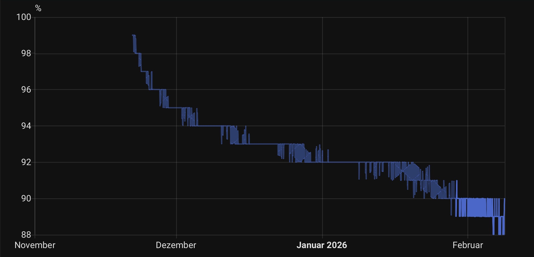

    Over the past few months I have been using the Zicada boards with HomeAssistant. So far, the results looks promising but are a little ambiguous. On two sensors, the battery life seems great with 88% charge left after rougly 3 months. These batteries should last for another year before needing to be recharged. But a third sensor, which has been running for the same duration, is now at 60% already. I am pretty sure this is not a hardware issue and the sensor might be performing better after a reset.
    There are a few little other issues or bugs left, where I am not sure whether this is due to my design or just Zigbee's overall complexity. For example, devices might take a few tries to complete their interview. Or some attributes are not reported at all, requiring a reset of the device. But usually, once everything work with a particular sensor, it stays that way.

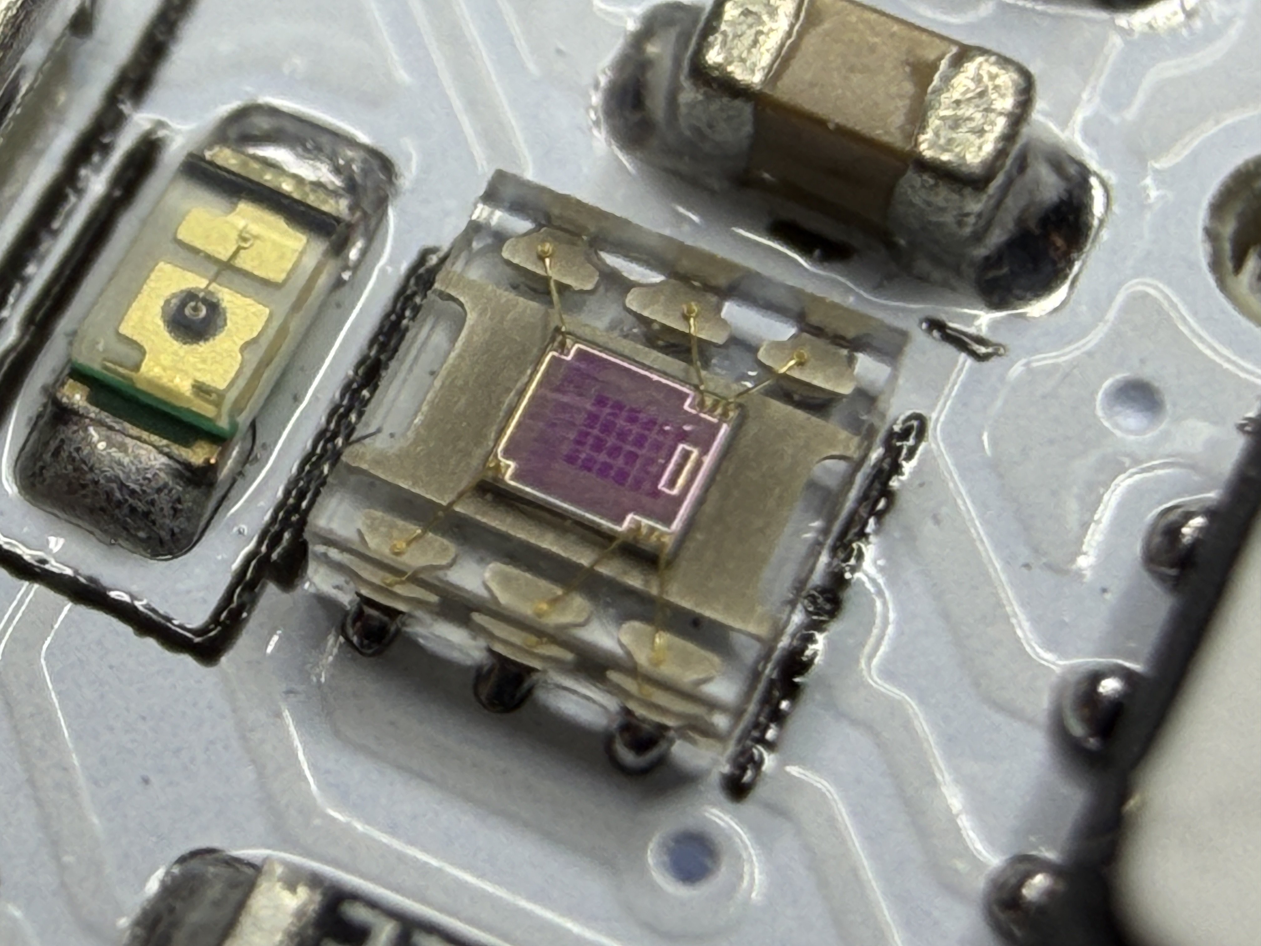

    Since I wanted to order a few more PCB for myself, I wanted to include another feature, that was mentioned a few times: A light sensor. On the PCB, there was just enough space near the button for a TI OPT3001 brightness sensor. This little sensor uses the existing i2c bus on the board for communication, so no more pins or routing were needed. This sensor looks really gorgeous with its translucent case, measuring only 2x2mm.
    The firmware needed some updates to read the sensor and to integrate the Zigbee illuminance cluster. Luckily, Zephyr comes with a driver for the OPT3001, so the sensor was up and running in no time. One problem with the driver was, that it forced the sensor in a continous mode, where it adds around 4µA to the power draw (the battery voltage is stepped up, so the sensor actually only draws 2uA @ 2.2V). Instead of modifying the driver, I am just overwriting the mode setting by writing to the register directly via i2c. The sensor now only wakes up when is needed. This got the power draw of the entire board down to 7.2µA, only 1µA more than before the addition of the light sensor.
    The reset button already has a translucent center since it used for the status LED. I increased the size of the button to let more light in. The button is directly above the light sensor so this should be enough to get a relative estimate of a room's brightness. Of course, this will not be a very precise measurement, since the 3D-printed button still absorps some of the light.

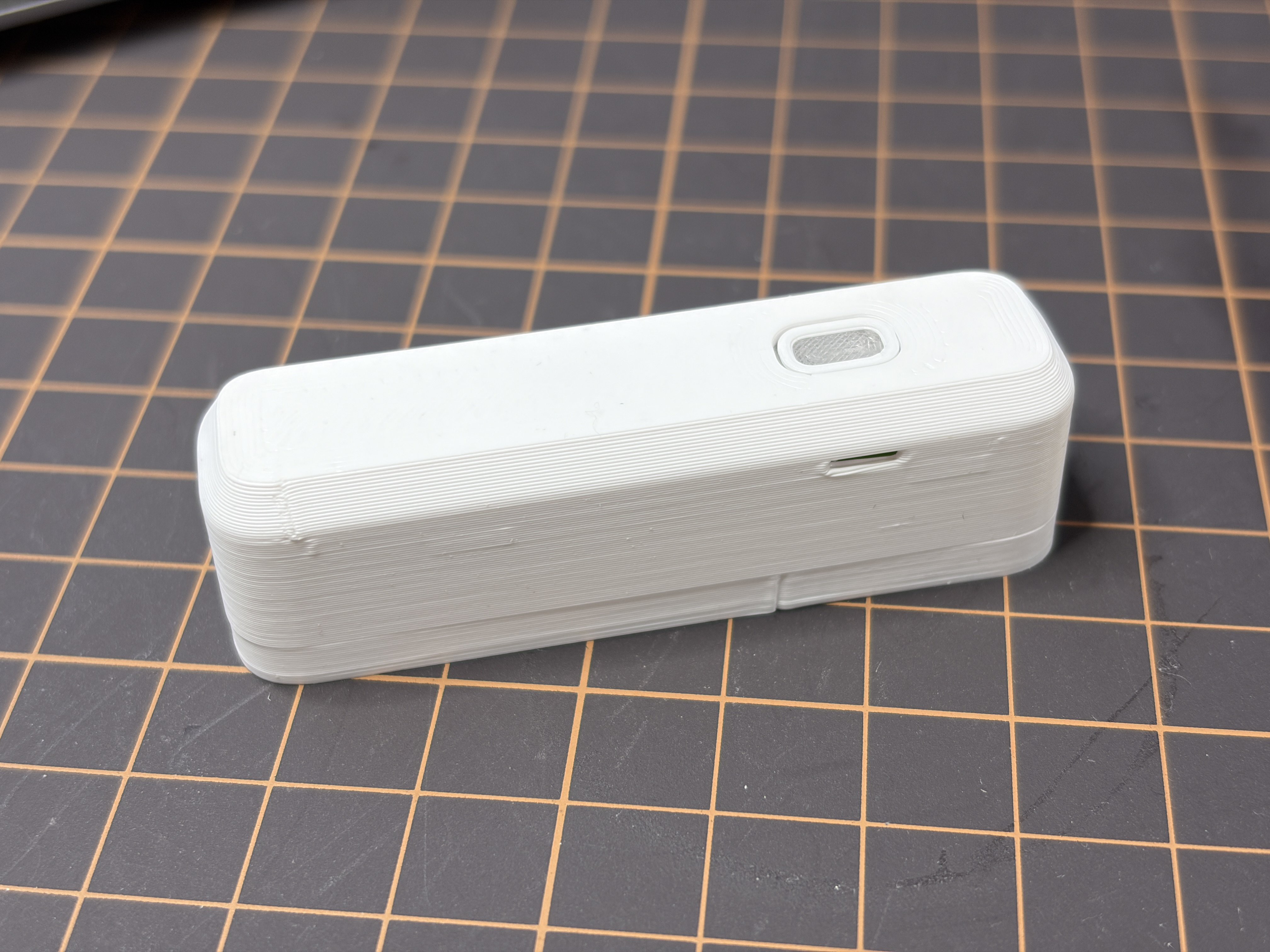

    In terms of design, smart home sensors are usually simple, unobtrusive devices and I wanted to keep it that way by using a white, 3D-printed case. Since the device can function as a contact sensor, it had to be small enough to be attached to a window or door frame. To figure out the necessary dimensions, I first searched for a suitable battery holder. Many common AAA holders consist of a plastic tray with two contacts, such as the Keystone 1020. However, since the case will be 3D-printed anyway, the whole plastic tray would take up unnecessary space. I ended up choosing the Keystone 56, which uses individual SMT-solderable spring contacts that add almost no length or height to the AAA cell. These sheet metal contacts are inexpensive and available from multiple manufacturers.
    With two of these contacts mounted to one side of a PCB, the other side could be fully used for the electronic components. This means that the overall size of the device is defined by the AAA cell, the battery holders and a standard 1.6mm PCB. There was just one more important consideration: the antenna. It needs to stick out from under the battery to work efficiently. To keep the cost and size down, I opted for a quarter-wave trace antenna which adds around 6 mm to the PCB length. The negative antenna terminal sits right next to the antenna and becomes part of the RF ground.
    The case mainly consists of two snap-fit shells that can be opened to replace the battery. Inside the front shell, there is another 3D-printed piece for holding the PCB in place and guiding the battery to its contacts. This inlay piece is also essential to ensure that the AAA cell can only be inserted the correct way. This is achieved by recessing the positive terminal slightly.
    Zigbee Devices require some mechanism to start the pairing process, so there is a hole in the case for a pushbutton. This button is attached to the case via a small hinge. By changing the filament mid-print, the button gains a transparent window to the status led beneath it.
    Another mini-version of the main device houses the magnets for contact sensing. I am using a set of six 2x5mm magnets, which seem to be strong enough to trigger the Hall effect switch.
    Both the sensor and the magnet case can be mounted to a window or door frame using double-sided tape. When it’s time to replace the battery, the main part of the case can simply be pulled off.
