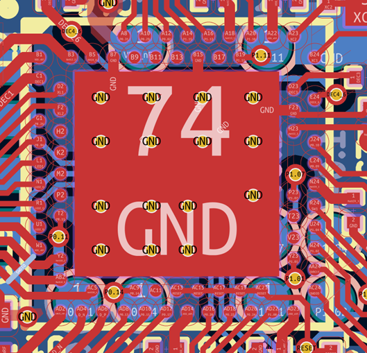

One of my design goals was using a standard 1.6mm PCB. The nRF52840 uses quite a wild 7x7 mm QFN73 package with two rows of pins. Because of the density, not all of its pins are accessible without using plugged vias and a 4 layer PCB. This would not be an issue for this project since only few I/O pins are necessary - as long as none of the inaccessible pins need is essential. Unfortunately, one of these pins is the reset signal, which is quite important. I was almost considering switching to a different microcontroller before discovering Nordic’s nRF52840 Dongle, which also uses a low-cost 2-layer PCB. How did they solve this issue? I checked the design files and found that the reset-signal was simply routed through a few unused IO-pins. This seems a bit sloppy but if the manufacturer does it, so can I. The Dongle design also integrates a compact 2.4 GHz trace antenna that happenes to match the width of my board, so I used their antenna layout as a starting point. In general, there’s nothing unprofessional about copying antenna designs from evaluation boards. Nordic even recommends this specifically, since these are proven and certified designs.

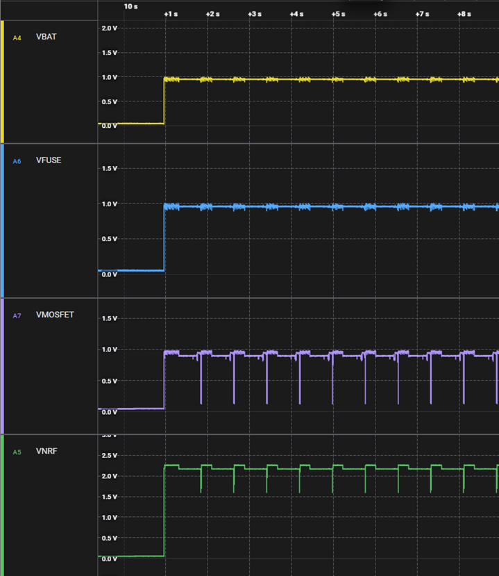

The TPS61098 is directly supplied by the AAA battery. Out of habit, I initially included a p-MOSFET between the TPS and the battery for reverse polarity protection for the first revision of the PCB. This is usually a simple way to block current if the battery is inserted the wrong way but it only works if the battery voltage is higher than the MOSFET’s gate-source threshold voltage. For a NiMH-based cell, the voltage is not enough and would require a MOSFET with an extremely low threshold voltage. Otherwise, the MOSFET’s resistance causes a voltage drop that prevents the boost converter from starting. The trace below shows the battery voltage (yellow), the voltage behind the input fuse (blue), the voltage behind the MOSFET (purple) and the 2.2V supply voltage (blue):

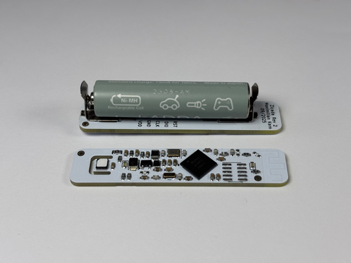

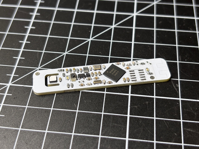

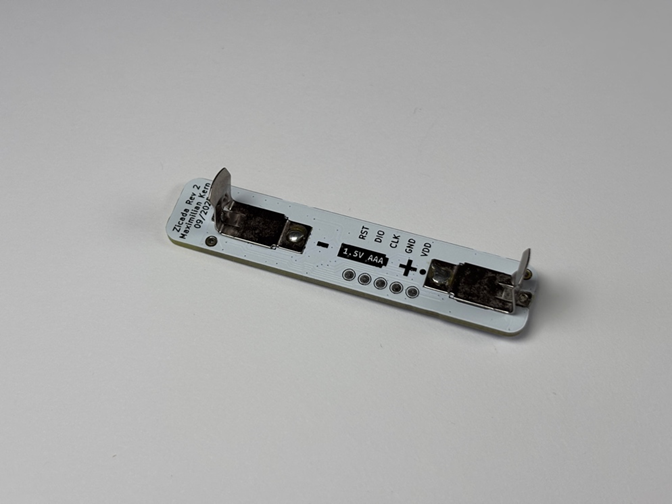

Overall, there aren’t many parts on the board and placing them on the PCB was not too difficult. I even had room for a 2x5-pin JTAG connector which came in very handy during the software development. The total part cost is also well below my original design goal of 10€. Here is a short rundown of what the parts currently cost, when ordering 10+ units:
