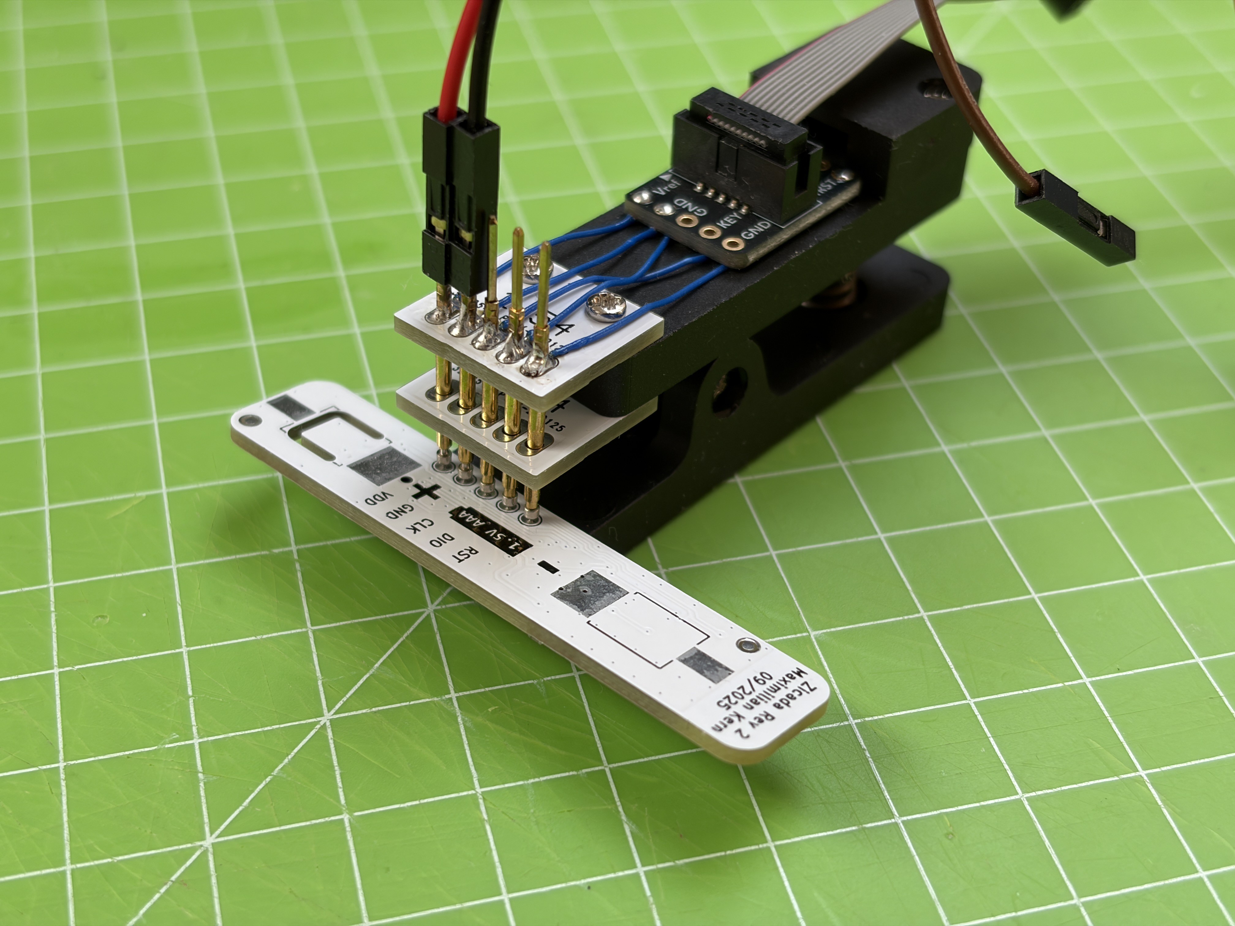

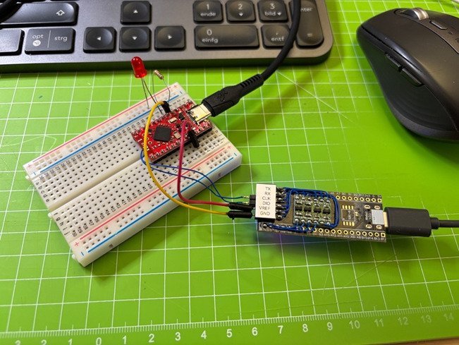

There are several options for SWD debuggers, depending on the budget. The cheapest approach is buying a black pill STM32F4 board and flashing it with the Black Magic Probe (BMP) firmware. This turns the STM32 into a SWD debugger that can program the nRF52840. The BMP can then be selected as a debugger in VS Code. To support my board’s 2.2V logic, I added a level shifter to the STM32 board:While this was a working solution for basic flashing, I found it to be unreliable and inconvenient. I later bought a Segger J-Link mini for around 60€. It’s by far the cheapest fully-fledged JTAG debugger, provided you only use it for non-commercial projects. And although the documentation doesn't state it, the J-Link works perfectly fine with a 2.2V target. I also bought a super-cheap pogo pin clamp that uses the test pads on the back of my PCB, so I don't have to solder on connector to every single board.

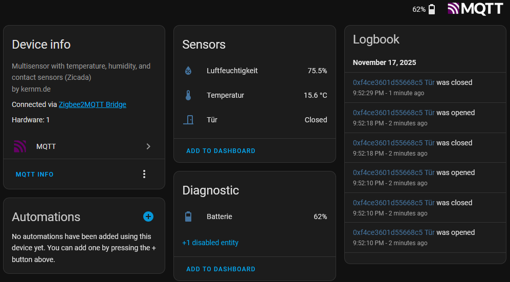

There can be many routers and end devices in a network but only one coordinator. The coordinator can be a USB adapter running software like Zigbee2MQTT or Zigbee Home Automation (ZHA), which is part of Home Assistant. If all of your clusters are correctly defined and your device conforms to the standards, it will be able to join the network. During this joining procedure, the coordinator interviews the device to find out what clusters it is using and what attributes it can report. In a home automation software like Home Assistant the device will then be displayed correctly with its attributes and controls.
Debugging cluster definitions and figuring out the correct configuration was tedious. There are few examples on the internet and Nordic’s documentation for the ZBOSS stack is very limited. For example, I had the problem that the On/Off cluster for the door sensor is not directly recognized in Zigbee2MQTT. A better alternative would be the IAS Zone cluster, which is mostly meant for security systems. But this cluster need a specific IAS zone enrollment, separate from the regular joining procedure. After trying for a couple of hours I gave up on this, as there seem to be issues with Nordic’s implementation. The workaround is a custom converter, which tells Zigbee2MQTT that is should treat the on/off cluster as a contact sensor. Fortunately, ZHA supports the On/Off cluster natively without any modifications.

To test my software, I have a few of the Zicada sensors running in my home automation network for the past few weeks. The software seems quite stable and I am very happy with the power consumption. During standby, the entire device runs on around 6uW. With temperature and humidity reporting happening every 5 minutes, the average power consumption is less than 17uW. In comparison, Ikea’s Parasoll sensor uses an average of around 22uW in standby alone.
