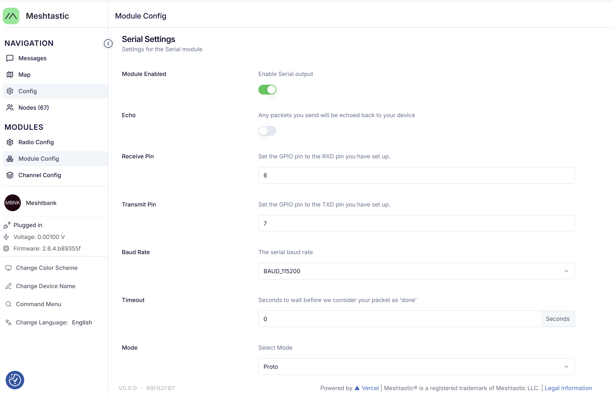

The circuit consists of mounting the SX1262 shield onto the Xiao nRF52840, then wiring jumper connections for 3V3 and GND. Connect FireBeetle pin 17 to Xiao pin 7, and FireBeetle pin 16 to Xiao pin 6. It’s a good idea to remove the plastic housings from the jumper cable tips and lightly crimp the connectors going into the SX1262, since the headers are very thin and jumper cables often fit poorly. LCD screen is connected using a GDI cable, so no worries about pins.

After flashing, connect the USB cable, visit https://client.meshtastic.org, choose serial mode, and configure the module: set region, set the main channel name to Meshtbank, set the Serial module to Proto mode, and assign pin 7 as TX and pin 6 as RX.

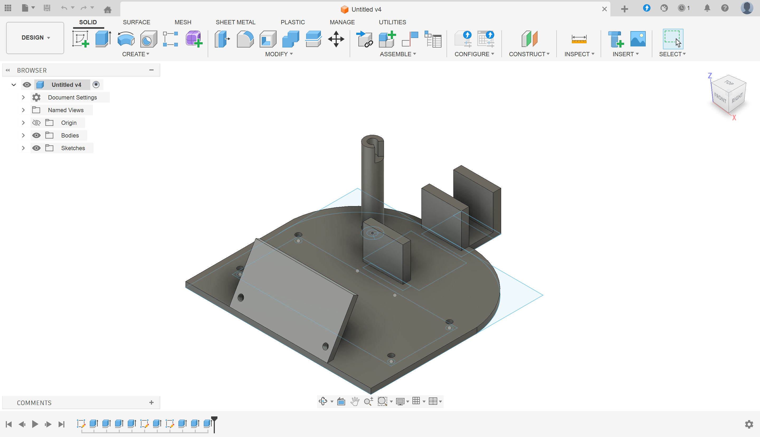

3d files https://cults3d.com/en/3d-model/gadget/meshtbank-experimental-meshtastic-baking-node
