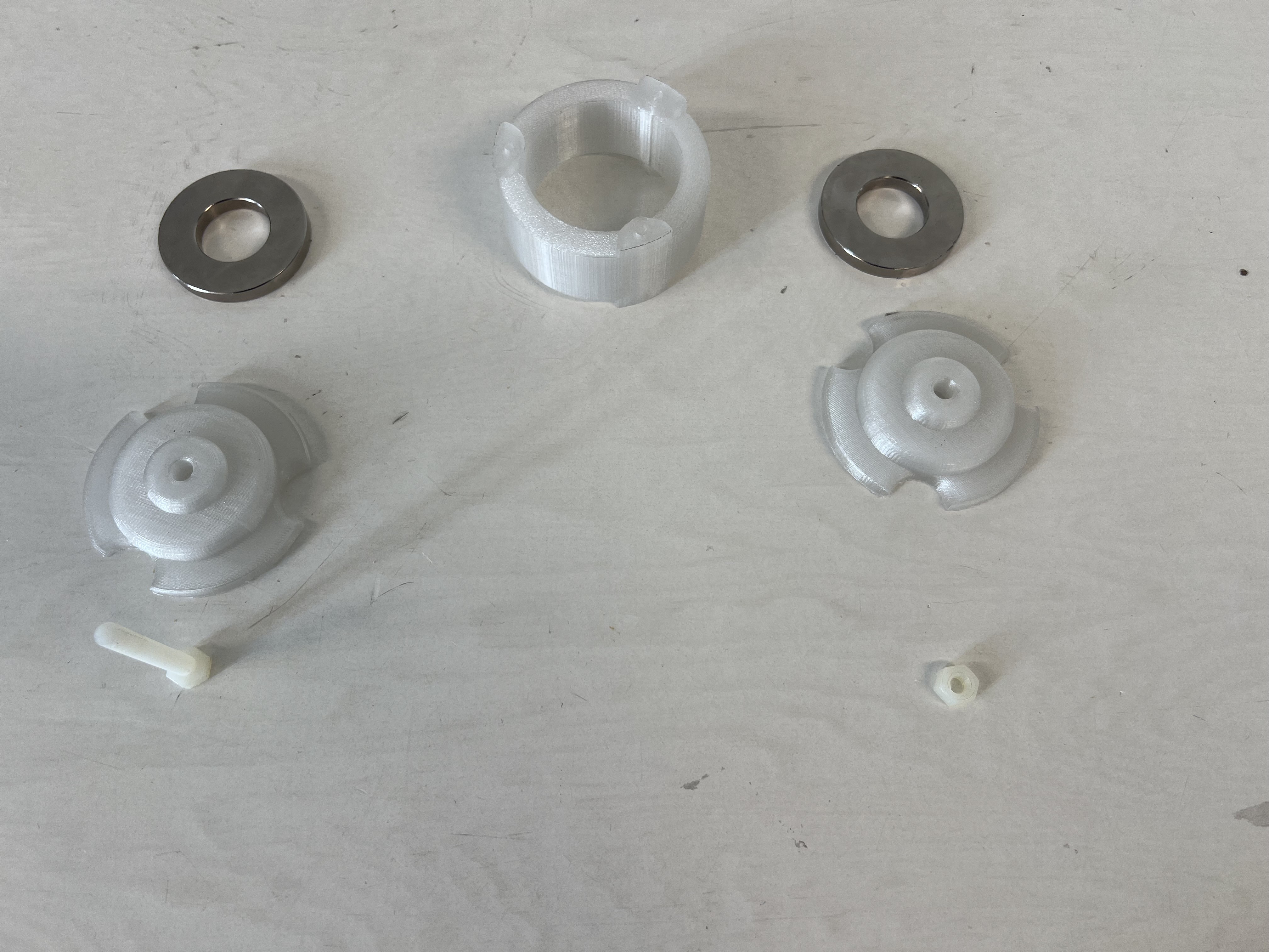

We purchased two neodymium ring magnets and forced them together with a 3D printed casing that was secured with a bolt.

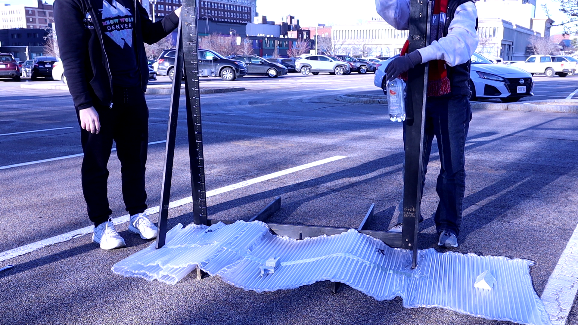

This assembly was tied to fishing wire and suspended from a pulley system, on the other side of the pulley we have a plastic bottle filled with water that acts as a counterweight. We repeated the test at least 50 times in each arrangement while recording with a camera.

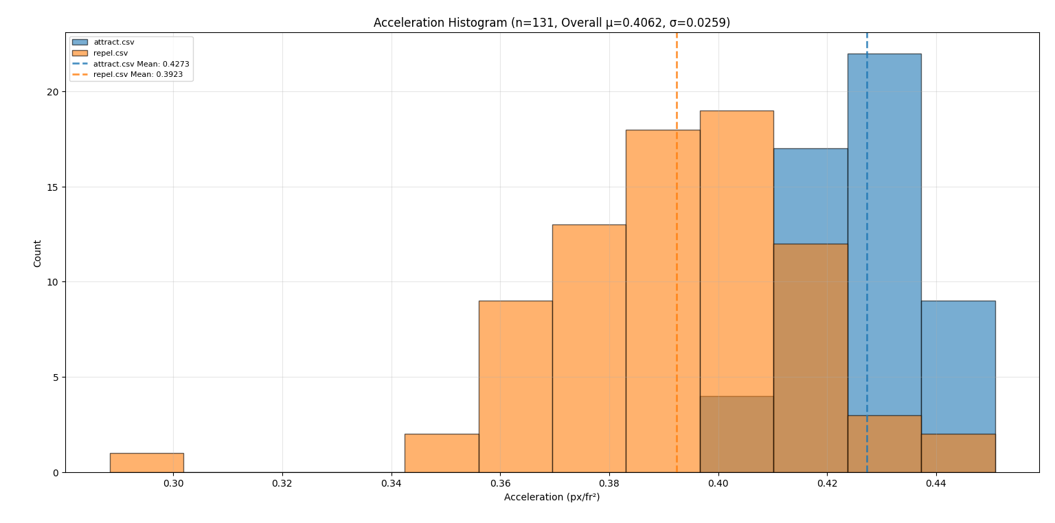

A python script analyzes the video and detects the position of the assembly in each frame which is then fit to a parabola versus time for that drop to get the acceleration. Code found here.

The external assembly is made entirely of non conductive or magnetic materials and the experiments were done in a parking lot where a metal detector was used to verify that no metal objects were nearby. The bolt securing the magnets is conductive and may be necessary for the effect, it does not move relative to the magnets and therefore makes no effect on the acceleration of the assembly according to existing understanding.

We found that the attracting magnet assembly had an acceleration 10.5% greater than the repelling magnet assembly. A T-test indicates a 16-sigma statistical difference between the two datasets. We are currently investigating if this could be due to systematic error in our measurement process or a fundamental change in gravitational attraction. Data and analysis procedures found on github.

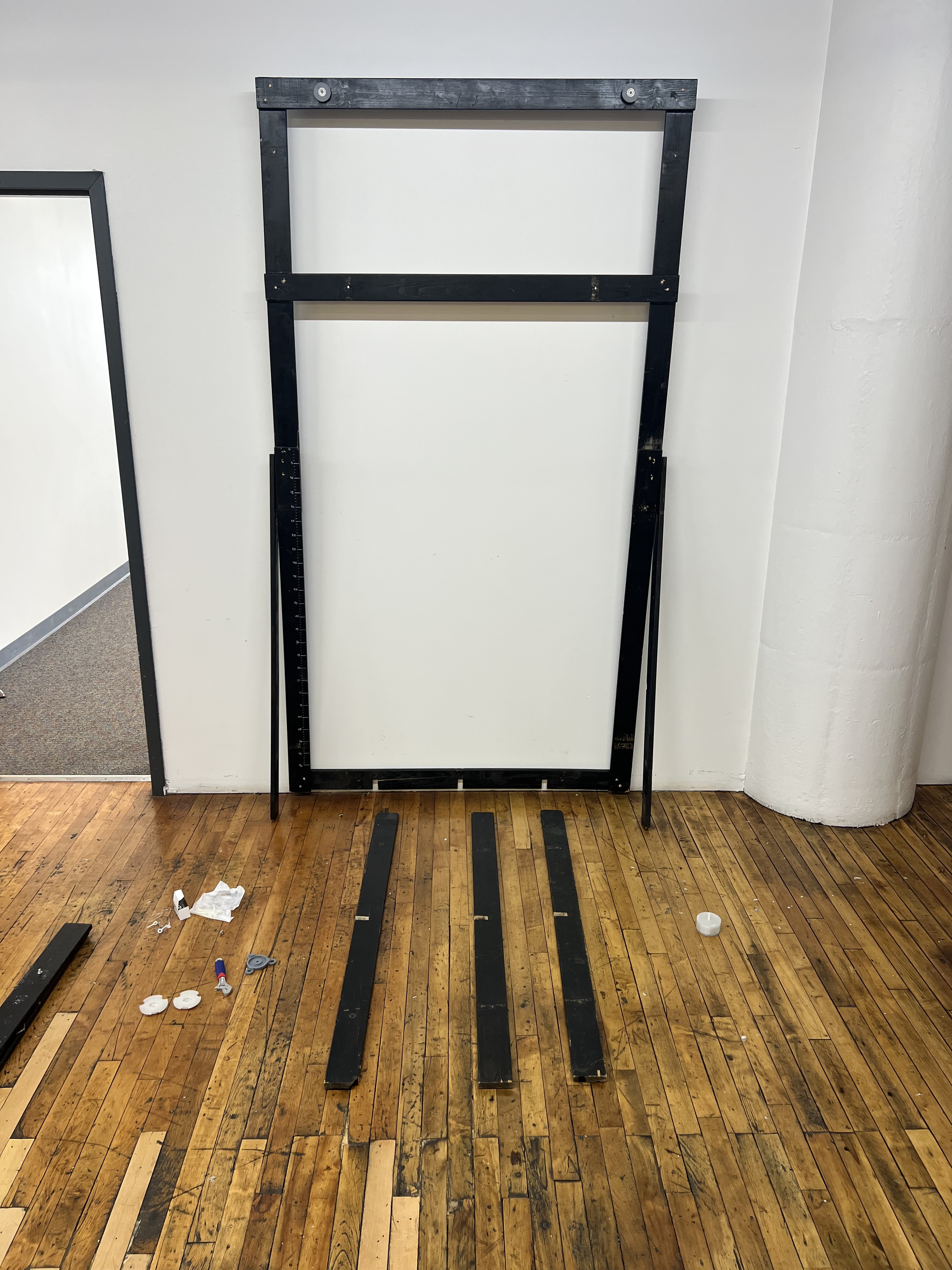

    Assemble the Frame
    We constructed a tall rectangular frame (two boards high, one board wide) with a cross-beam near the top to support the pulley system. The exact dimensions can be modified, but the goal is to create a stable structure that leans at approximately
    10 degrees to allow the weight to hang freely without hitting the supports.
    Prepare the Base: Cut three grooves into the bottom of one of the 1x4 boards. These grooves should be as wide as the board's thickness and go halfway through the depth. This board will serve as the anchor for the base.
    Construct the Uprights: Arrange 6 of the 1x4s to form the vertical structure (see images). For each connection point, drill two holes through both boards, apply wood glue, and press-fit wooden dowels to secure them. Allow the glue to cure fully according to the manufacturer's instructions.
    Install Bearings: On the top crossbar, drill two holes to accept the mounting dowels for your ceramic bearings. Ensure these are horizontal to minimize friction. Press-fit the dowels and mount the bearings.

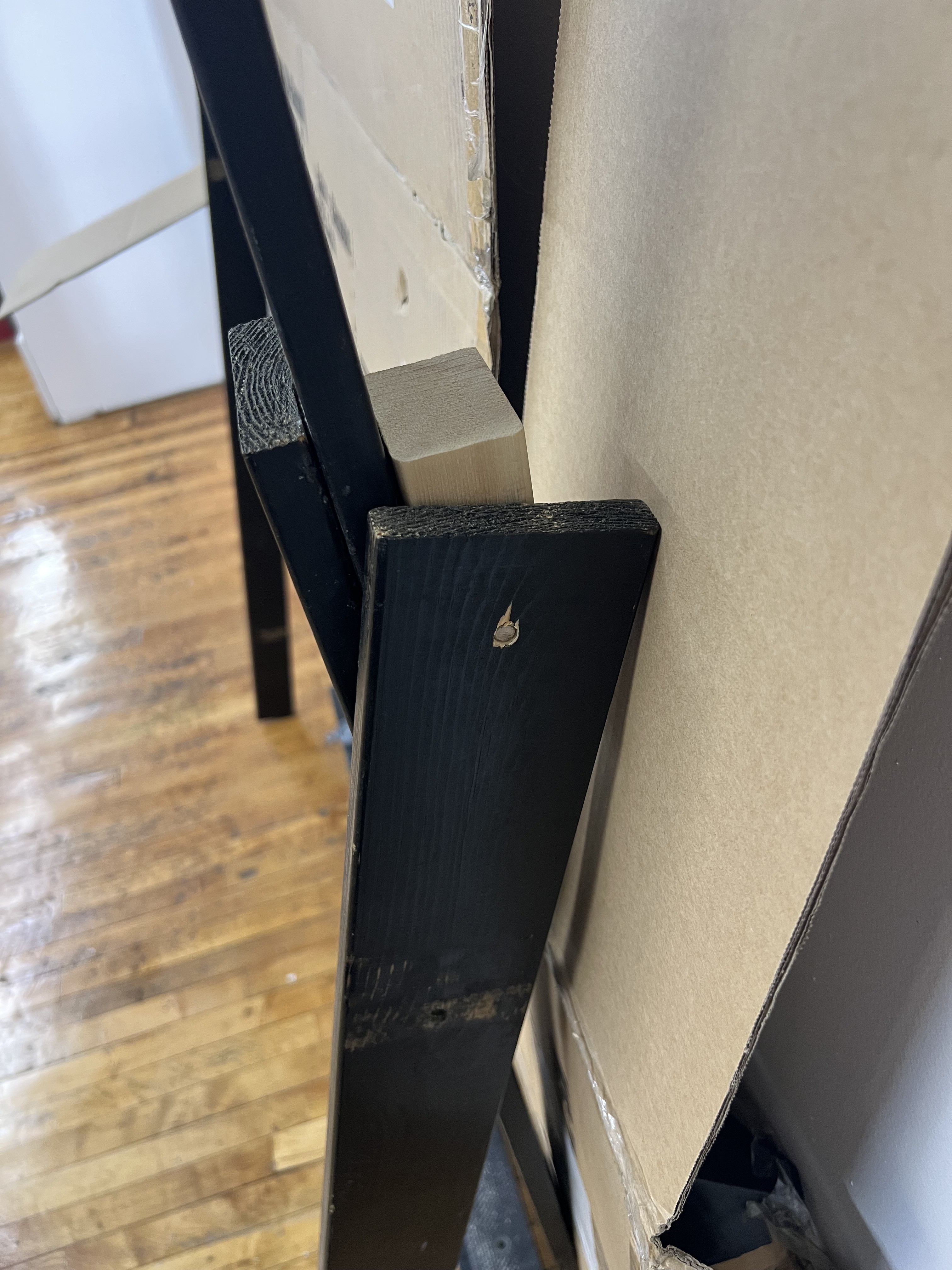

    Create the Tilt Mechanism:
    • Cut notches in the middle of 3 additional boards to mate with the base notches.
    • Attach a wood block to the back of the frame using dowels.
    • Connect a final 1x4 to the side of this block using a dowel without glue, creating a hinge that allows the leg to swing freely.
    Final Assembly: Slot the three base boards into the bottom of the frame and lean the frame back on the swinging support legs until it sits at a stable ~10-degree angle.

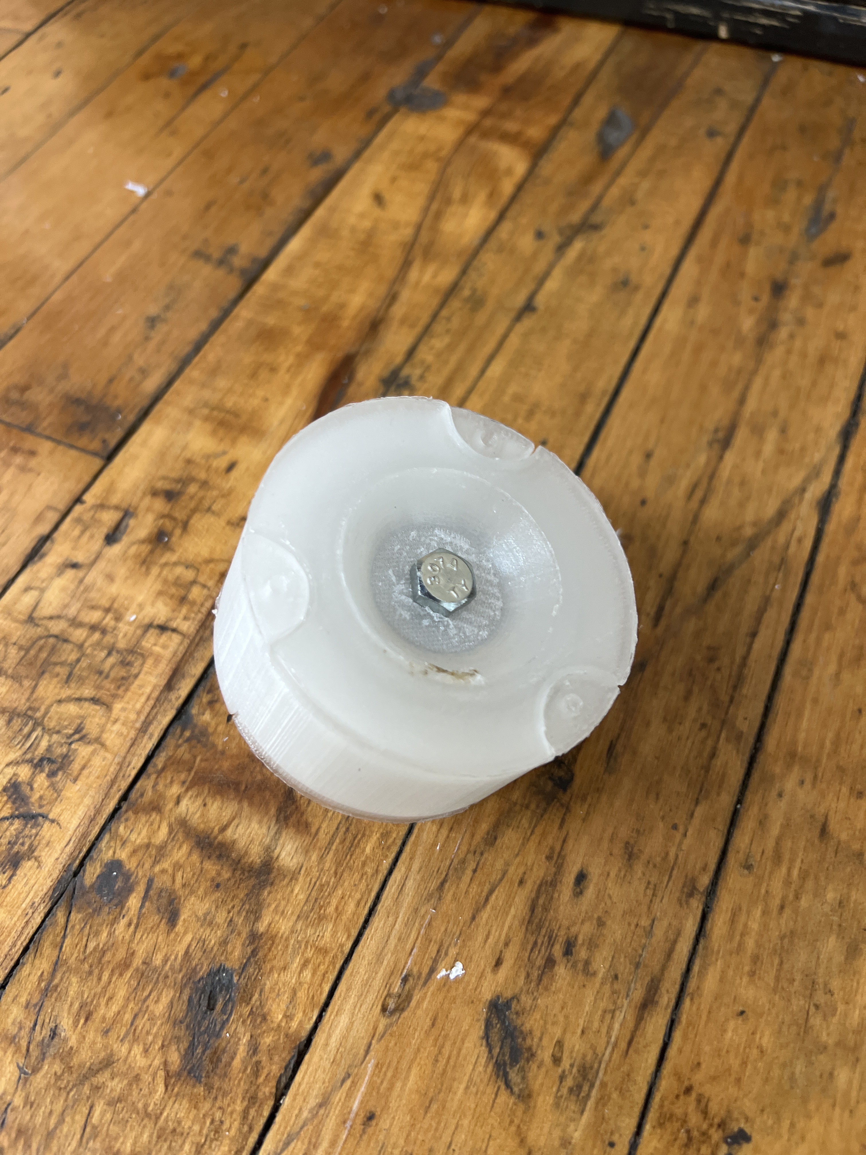

    Magnet Assembly
    1. Insert the two neodymium ring magnets into the 3D printed casing.
    2. Orient them in either Attracting or Repelling mode.
    3. Secure the casing using the ¼-20 screw and bolt. Ensure the nut is tight enough to prevent the magnets from shifting during the drop.
