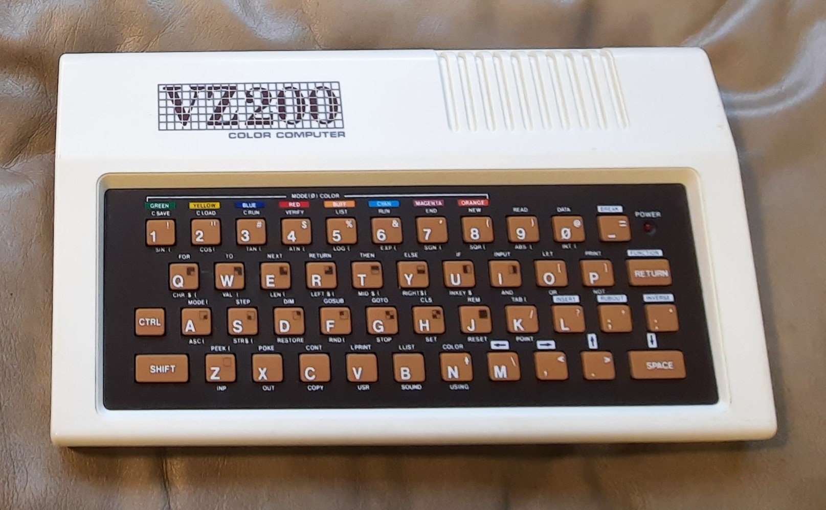

Sometimes, VZ-200 repairs go really bad - if you have to remove the 6116 SRAM or ROM chips during a repair due to faulty RAM / ROM, chances are that you are going to cause damage to the motherboard, as the PCB quality is very low. So far, everybody attempting to remove the ROM chips from the board has a least lifted a couple of pads and/or damage some PCB traces, resulting in bodge-wires.
In my case, the PCB got damaged so badly that I opted to create a daughter board replacing the entire memory (RAM, ROM) sub-system with a plugin daughter board - else, I would have needed two dozen of bodge wires, and the chances of resurrecting the machine were close to zero. However, the daughter board, replacing the entire memory sub-system, brought my VZ-200 back to life!
