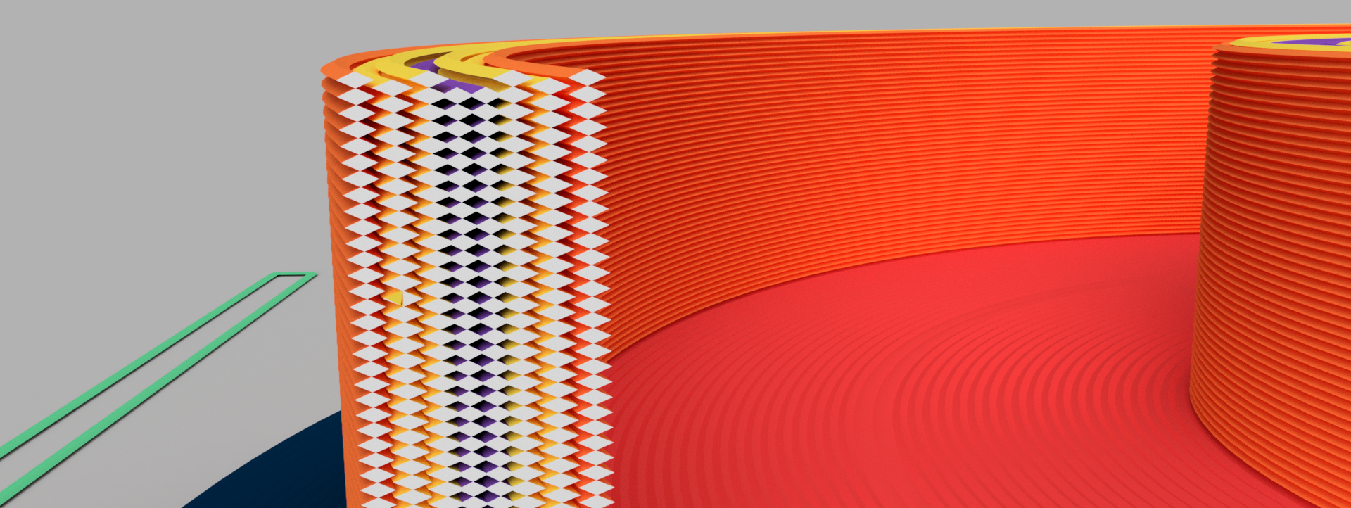

The Solution: Bricklayer (Staggered Perimeter) Printing
Bricklayer printing introduces a Z-axis stagger of half a layer height between internal perimeter shells. This simple modification results in two critical improvements:
  1. Increased Contact Area: Just like a brick wall, the staggering significantly increases the physical contact area and packing efficiency between adjacent shells.
  2. Removal of Weak Interlayer Surfaces: The weakest surfaces, which run straight through the entire wall thickness in standard prints, are broken up.

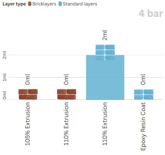

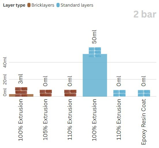

1. Initial Bricklayer Test (2 Bar)
The first test with default flow settings at 2 Bar (20m) saw slight leakage (only 3ml of water absorbed, and a little audible sloshing). This is 10 times less than the best untreated hull using standard printed layers performed last time
2. The Crucial Optimization (The Hack!)
Inspired by strength testing that Stephan from CNC kitchen did a few months ago, I adjusted the internal perimeter extrusion flow multiplier (testing 1.05 and 1.10) to account for the increased packing efficiency and ensure zero voids.
3. The Definitive Result (4 Bar)
The optimized Bricklayer prints (using ASA, 3mm hull, and both 1.05 and 1.10 extrusion multiplier) achieved NO measurable mass gain at 2 Bar or 4 Bar pressure.
This matches the performance of only the most robust solution tested previously: an epoxy-coated hull. Bricklayers achieve this result solely through slicer settings.
