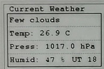

- In the upper left part of the screen there is the basic information about the current weather. In the first line we have descriptive information about the weather condition, then the temperature in degrees Celsius with one decimal place, then the air pressure value and the air humidity expressed in percent. Next we have the label UT (Update time) which tells us at what time the data was last downloaded.

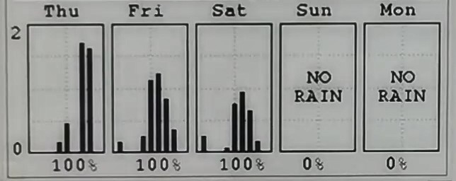

- The lower half of the display contains the forecasts for the next 5 days of the week. Analogous to the previous description, the day is indicated at the top, and the POP value in percentage at the bottom. The amount of precipitation is expressed on the far left, but now the maximum value is dinamicly adjusted depending on the maximum predicted amount of precipitation throughout the next five days.
Now in this case each day is divided by four horizontal and two vertical lines. The horizontal lines serve for a more precise visual assessment of the amount of precipitation,...
