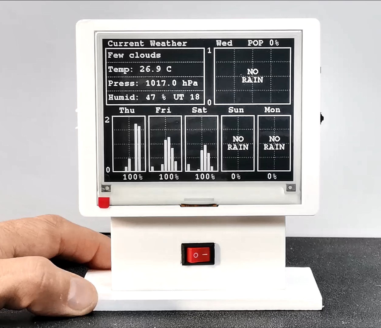

   At first glance, you can see that I didn't pay special attention to the visual part of the display, in the sense that there are no advanced graphic shapes and images, but only rectangles that represent the days, so the required information can be determined very fast and easily.
   Now let's explain how it works and describe the information displayed on the screen.
- In the upper left part of the screen there is the basic information about the current weather. In the first line we have descriptive information about the weather condition, then the temperature in degrees Celsius with one decimal place, then the air pressure value and the air humidity expressed in percent. Next we have the label UT (Update time) which tells us at what time the data was last downloaded.
- In the upper right part there is a space where the current situation regarding rainfall is indicated, as well as the forecast until the end of the current day. The space is divided by horizontal and vertical dashed lines. The vertical ones show the time (24 hours) midnighth, 6AM, noon, 6PM and midnight. The horizontal lines serve for a more precise orientation for the predicted rainfall amounts in mm. The numbers on the left edge show the value of this parameter. It is very important to emphasize that for better visibility this value is variable and depends on the maximum amount of precipitation in a 3-hour period, which is predicted for that day.
So as I mentioned, the amount of precipitation is predicted at a distance of 3 hours and is expressed through vertical bars. At the top is the day of the week as well as the POP symbol, which in translation means probability of precipitation and is indicated in the unit Percentage.
- The lower half of the display contains the forecasts for the next 5 days of the week. Analogous to the previous description, the day is indicated at the top, and the POP value in percentage at the bottom. The amount of precipitation is expressed on the far left, but now the maximum value is dinamicly adjusted depending on the maximum predicted amount of precipitation throughout the next five days.
 Now in this case each day is divided by four horizontal and two vertical lines. The horizontal lines serve for a more precise visual assessment of the amount of precipitation, and the vertical line indicates the time: midnight, noon, and midnight. As before, precipitation is represented graphically with vertical bars. With the free API key from openweathermap we get precipitation data with a resolution of 3 hours.If no precipitation is predicted for a particular day, then the message NO RAIN appears in the middle of the rectangle indicating the particular day.

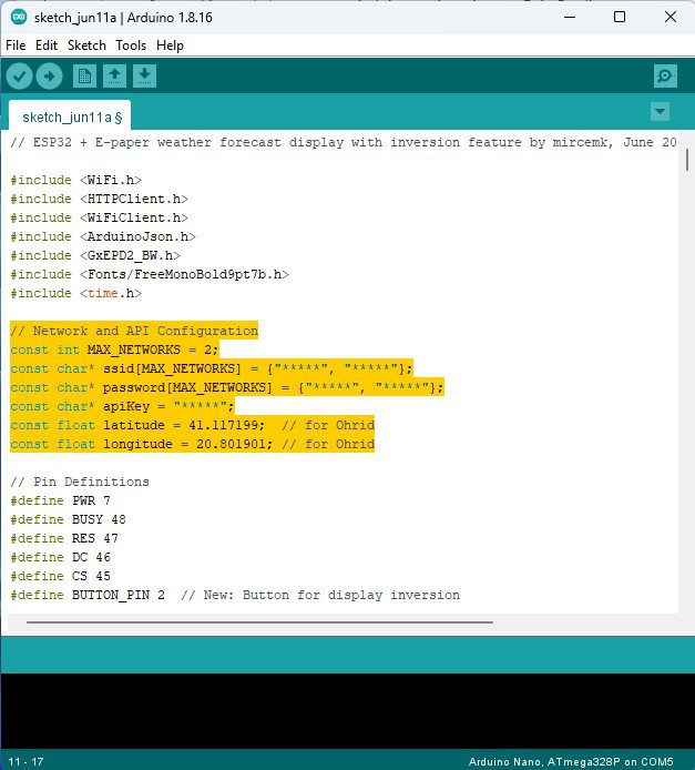

  Now a few words about the code and some settings in it: Before uploading it, we need to enter some into the code. First, we need to enter the credentials of the local Wi-Fi network. I specifically use the device in two places with different Wi-Fi networks, so in order not to change the credentials constantly, I made this part of the code in a way that the data from the two available networks is entered, and the device connects to the currently available Wi-Fi network. In fact, this is a very practical option, and you can enter any number of wireless networks.

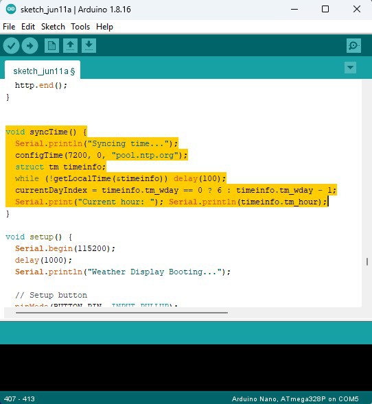

Then we enter the previously generated API key for the specific location from the openweathermap site, as well as the coordinates (latitude and longitude). Also in the "void syncTime" function in the "config time" line we need to enter the difference between UTC and local time in seconds. (For my location, local time is UTC + 2h, so I put 7200 sec).

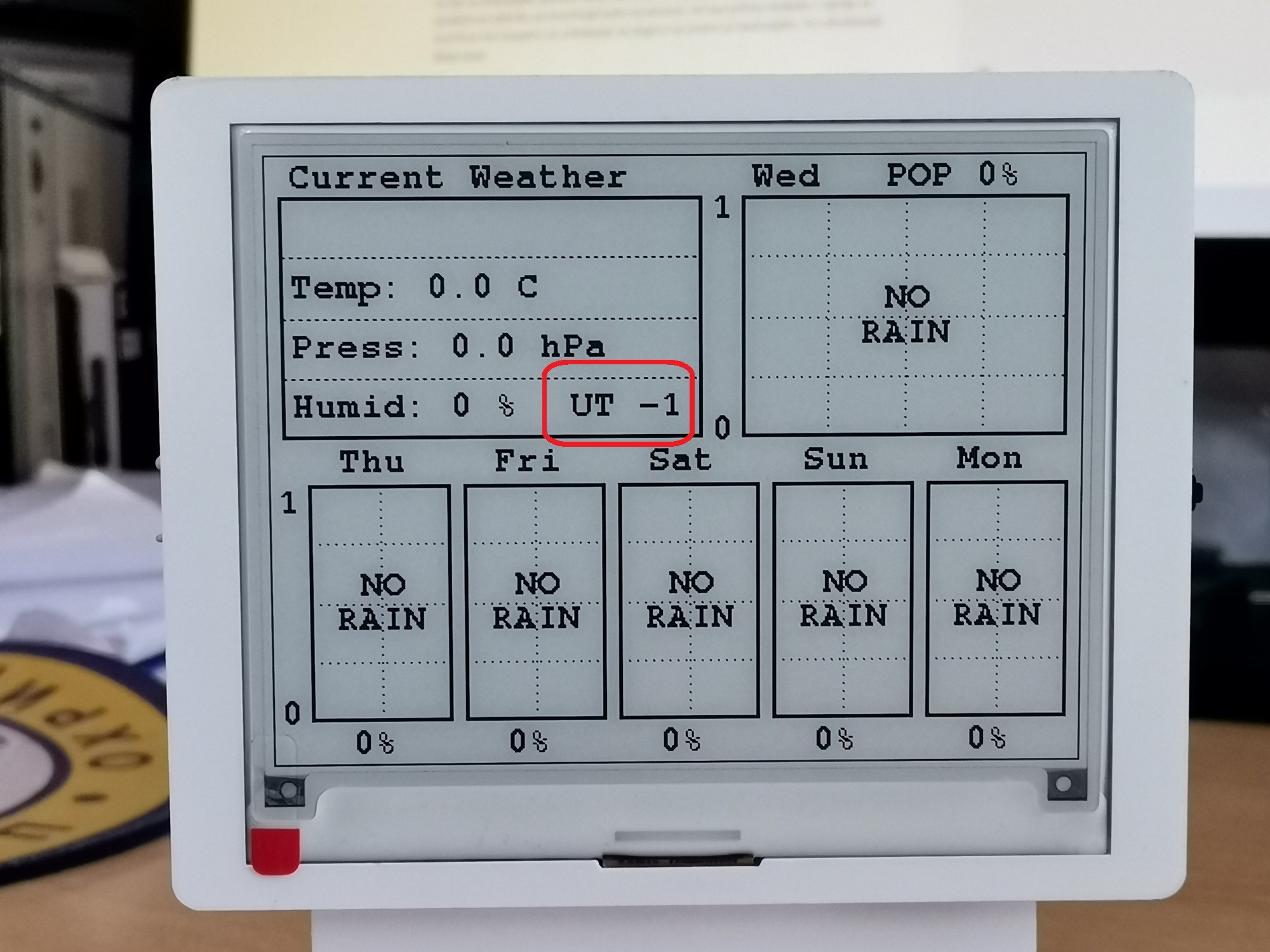

 If for some reason the data from openweathermaps is not downloaded, all data is 0.0 and "-1" appears on the Current Weather screen in UT, which is a sign of an unsuccessful download. The data will be downloaded in next 15 minutes, or immediately, if we press the reset button or the off/on switch.

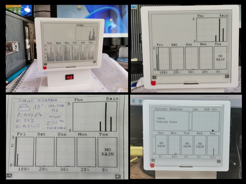

  Now let's briefly see how the device works in real conditions. When turned on, we can follow the entire boot process on the serial monitor and determine if there is any error. If it passes without errors, the data is printed on the screen and the weather station enters DEEP SLEEP mode for the next 15 minutes. Below are several screenshots from different time periods and at different stages of the device's development.
