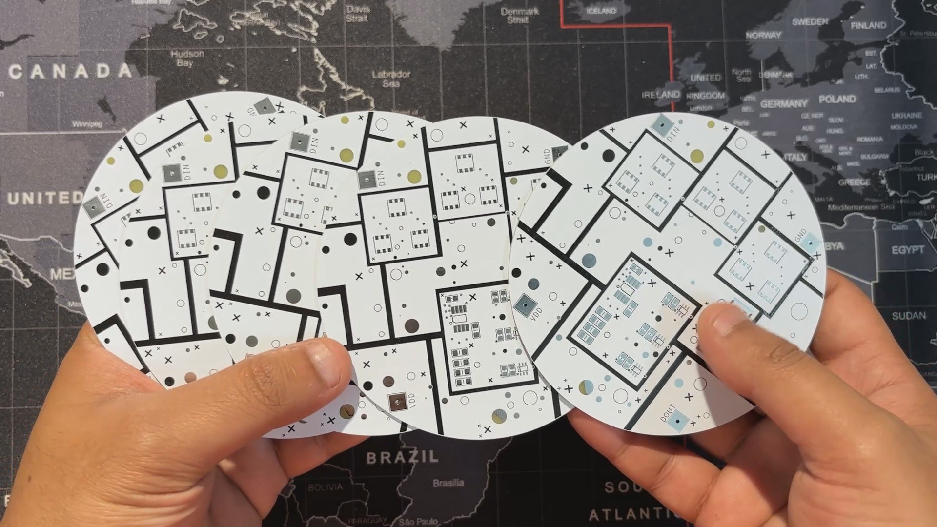

PCB DESIGN
We started the PCB design process by preparing the schematic for this project. The circuit uses the minimal configuration of the WS2811 IC, paired with three MOSFETs used as switching stages. For the MOSFETs, we selected the 8205S N-channel dual MOSFET IC, which we used to control the red, green, and blue channels.
Our design includes nine 5050 RGB LEDs. All LED anodes are tied to VCC, while their cathodes are grouped by color:
- All Red cathodes are connected in parallel to the first MOSFET
- All Green cathodes are connected in parallel to the second MOSFET
- All Blue cathodes are connected in parallel to the third MOSFET
The gates of the three MOSFETs are driven by the R, G, and B outputs of the WS2811 IC, each connected through a 10 kΩ gate resistor. Using MOSFETs allows us to drive much higher currents than the WS2811 could handle directly, which makes the entire LED assembly significantly brighter.
We added a CON1 connector with four pins to access VCC, GND, DIN, and DOUT, giving us complete support for daisy-chaining multiple Giant Neopixels if needed. To protect the LEDs and regulate brightness, we also placed current-limiting resistors between VCC and the anodes of the RGB LEDs.
Once the schematic was finalized, we exported the netlist and created the PCB layout. Using the dimensions from our CAD model, we traced the outline and placed all nine LEDs exactly in their assigned positions. After routing the connections and arranging all components, we completed the board by adding decorative elements on both the solder mask and silkscreen layers to give the PCB an artistic and polished look.
JLCCNC SERVICE
Once the board design was finalized, I chose a purple solder mask with a white silkscreen and uploaded the Gerber files to JLCPCB’s quote page. I usually stick to white or black for most builds, but this time I wanted to switch things up—and the purple option looked too good to skip.
I’ve tried PCB services from different manufacturers over the years, and this time the boards arrived in under a week with a clean finish and sharp silkscreen. Everything aligned perfectly with the design, and the purple solder mask really made the PCB stand out.
