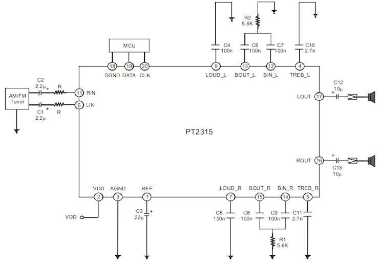

Circuit diagram:
I have taken the reference from the circuit given in the datasheet. Here, you can see that the IC has 2 channels. We need 2 inputs and 2 outputs.The input is directly fed without referencing ground but using a 2.2 μF coupling capacitor in the signal path. The output resistance and coupling together behaves like a filter arrangement. Because the circuit is fixed, the only controlling input to the IC is the I2C bus, allowing us to connect any microcontroller.

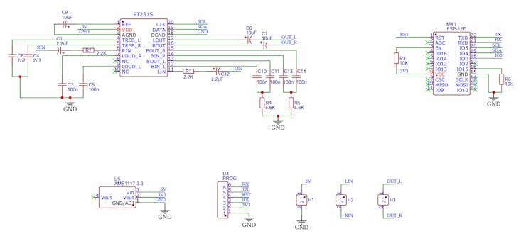

Now, here is the circuit diagram I used for the IC. Since we have only one I2C bus, the ESP8266 supports this protocol, and it has Wi-Fi, so we can utilise these features. There are a lot of revisions you will find on the internet using the same code and libraries for this DSP. But now with this microcontroller and web server, we have eliminated a lot of components. No need to print the data on screen, and no need for external push buttons. However, there is always an option to do this because most of the microcontroller's GPIOs are available.
