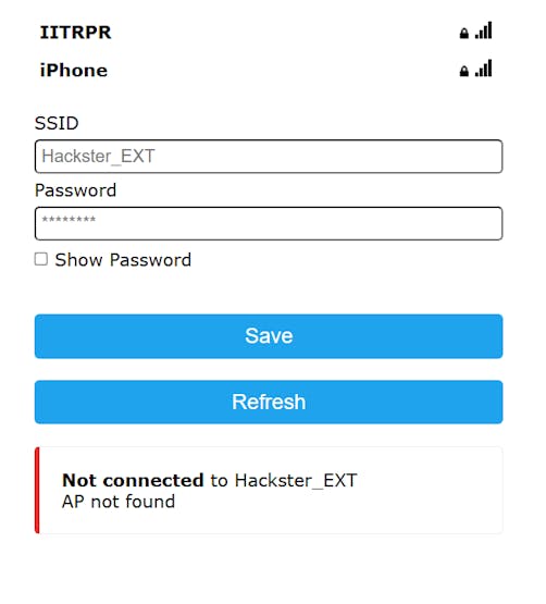

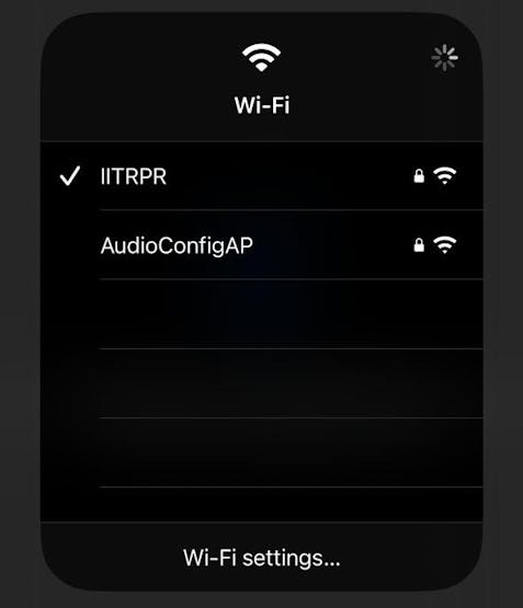

It is the HTML-coded part in the programming section, where all the GUI and I2C logic is implemented. After uploading the code to the ESP, open your mobile phone WiFi and connect to AudioConfigAP.
It will open a webserver through which you can connect to available WiFi in that range. After the successful connection message is displayed on the serial monitor.
Connecting a network:
And finally give you an IP address. After opening this IP in the browser connected to the same network, you will get this interface:
