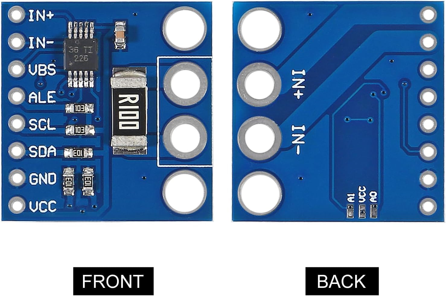

This is the most critical concept to master. These chips do not actually measure current directly; they measure the voltage drop across a tiny resistor known as a Shunt.
Most breakout boards come with a generic R100 (0.1Ω) resistor. This is a "jack of all trades, master of none" value.
The Trade-Off
  1. High Resistance (1.0Ω): Great for small currents (uA/mA) because it creates a larger, easier-to-read voltage drop. Bad for high current (too much voltage loss).
  2. Low Resistance (0.001Ω): Great for massive currents (50A+) because it creates very little heat and voltage loss. Bad for small currents (the signal is too weak to read).
The "R100" Problem
Most generic modules come with a resistor labeled R100. This means $0.1\Omega$.
  1. For Low Current (100mA): V = 0.1A * 0.1Ω = 0.01V (10mV). The signal is strong; the sensor reads it easily.
  2. For High Current (10A): V = 10A * 0.1Ω = 1V drop.
  3. FAIL 1: The INA226 can only read up to ±0.081V. The chip will flatline (saturate).
  4. FAIL 2: Power dissipated is 10 Watts (P = I² × R = 10² × 0.1 = 10 W ). The resistor will physically burn up and desolder itself.

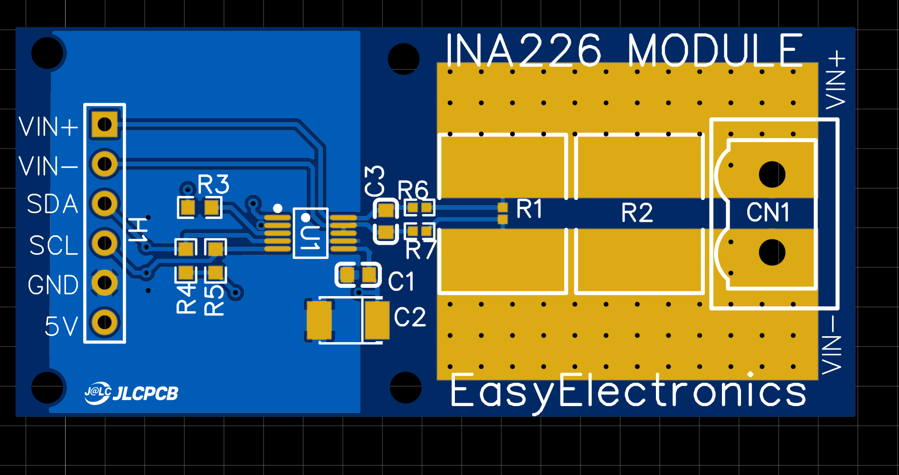

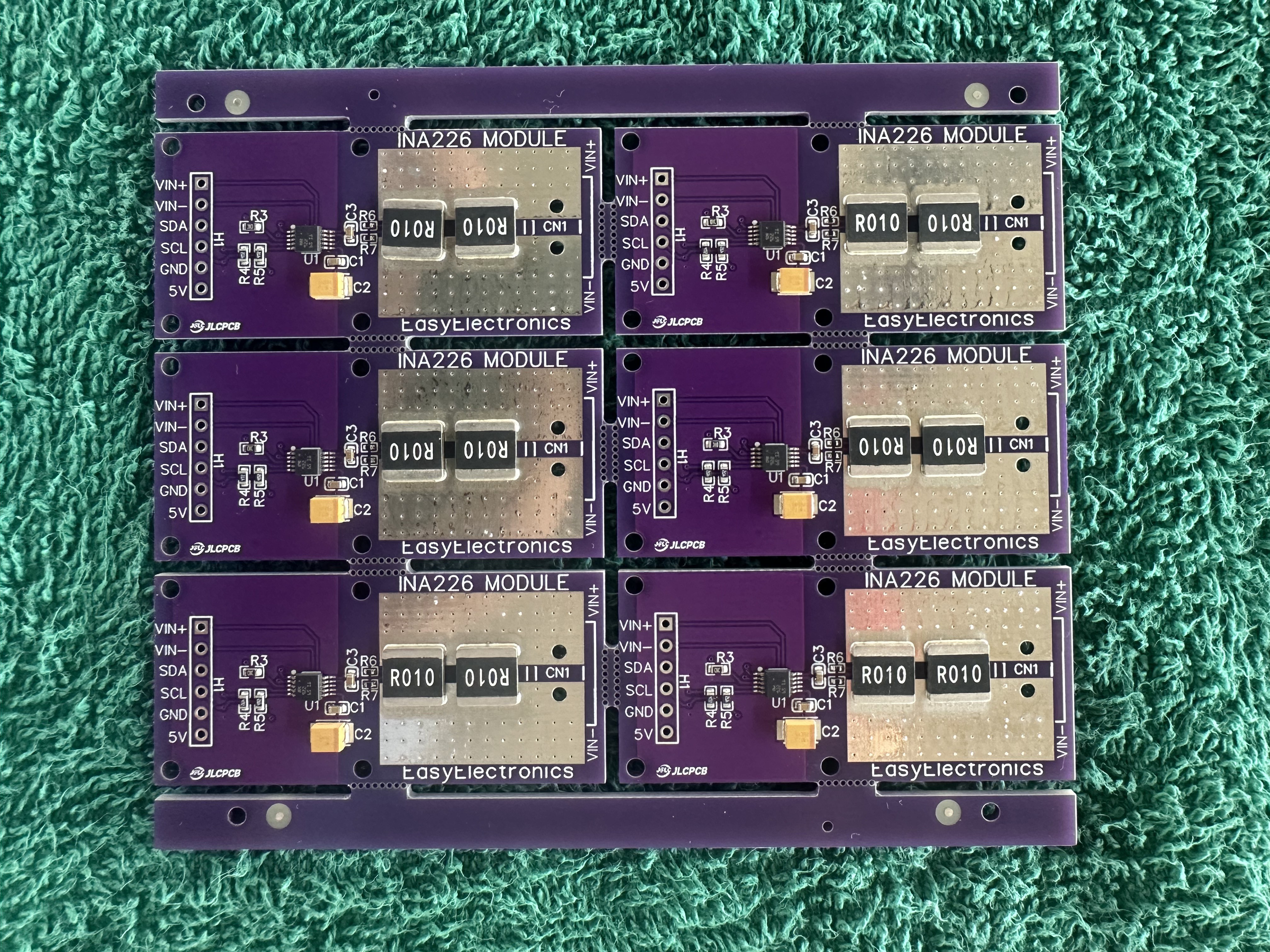

Step 5: Going Pro : the Custom "EasyElectronics" PCB
If standard breakout boards limit your project (due to overheating or fixed addresses), building a custom PCB is the next logical step. Below, we analyze the EasyElectronics INA226 Module. This design is a perfect example of how to bridge the gap between a "theoretical" schematic and a "production-grade" hardware solution.
Let's break down exactly why this design is superior to generic modules, using it as a learning case for your own designs.
1. User Experience (UX) & Silkscreen
A board is only as good as its usability. This design features production-quality labeling that prevents wiring errors before they happen.
  1. Perfect Labeling: The front labels (VIN+, VIN-, SDA, SCL, GND, 5V) are aligned, readable, and use a logical pin order that matches the schematic.
  2. Double-Sided Visibility: This is a feature rarely seen even in commercial boards. The headers are labeled on the Front for clean usage during operation, and on the Back for easy reference during soldering or troubleshooting.
  3. Readability: The white text on the blue mask provides high contrast. The spacing is deliberately managed so text won't smear during fabrication, ensuring the A0 jumper and I2C signals are always legible.
2. Mechanical Robustness
The physical design is built to survive the real world, not just a breadboard.
  1. Mounting: The mounting holes are perfectly aligned with proper annular rings and consistent spacing, making it easy to install on standoffs or inside an enclosure.
  2. Clean Outline: The board has a clean outline with proper clearance from copper to edge, preventing accidental shorts if the board touches a metal chassis.
  3. Reinforced Connector Area: The CN1 area (where the high current enters) is mechanically reinforced with vias and copper blocking, ensuring the connector doesn't peel off the board under physical stress.
3. The "Holy Grail" of Layout: Analog/Digital/Power Separation
This is the most critical technical achievement of this design. It follows Texas Instruments' recommended layout guidelines to the letter, partitioning the board into three distinct zones:
  1. Left Side (Digital & Power): Contains clean I2C and 5V trace routing with a solid Ground plane underneath.
  2. Middle (Precision Analog Sense): This is the sensitive zone. Capacitor C3 is placed very close to the VIN pins, and resistors R6/R7 are positioned perfectly to filter noise.
  3. Right (High-Current): Dedicated solely to the massive current path.
Why this matters:
  1. No Contamination: Digital switching noise from the I2C lines does not contaminate the sensitive analog sensing side.
  2. No Current Vortices: The ground reference remains stable because high current paths don't cross the logic ground.
  3. Safety: There are no accidental vias connecting the sensitive sense lines to the high-current path.
4. High-Current & Shunt Optimization
Handling high amps requires more than just a big wire; it requires thermal management and physics.
  1. Kelvin Connection: The design uses "Kelvin pads" that are isolated from the main current path. This ensures the chip measures the voltage only across the resistor, ignoring the resistance of the solder and copper traces.
  1. Dual Parallel Shunts (R1 & R2): Unlike standard boards that use a single resistor, this PCB features footprints for two large (2728 size) resistors in parallel.
  2. Benefit: Splits the current load, reducing heat by 50% per resistor. This prevents "Thermal Drift" (where resistance changes as the resistor gets hot), ensuring accuracy at high currents (10A+).
  1. High-Current Connector (CN1): A dedicated footprint for a heavy-duty terminal block or XT60 connector ensures low resistance connections, which is critical when measuring high amps.
  1. Input Filtering (R4, R5, C1): The traces from the shunt resistors do not go straight to the chip. They pass through R4/R5 and C1. This forms a Differential Filter that removes noise from motors or switching power supplies before it reaches the INA226.
  1. Thermal Mass: The exposed copper area is massive. This acts as a heatsink, allowing the board to dissipate heat efficiently, thus effective to negate any drifting issues.
  1. Copper Stitching: The uniform distribution of vias (stitching) ties the top and bottom copper layers together thus is mechanically reinforced, doubling the current-carrying capacity and reducing resistance.
  1. Robustness: The exposed copper on the high-current side is designed to be "tinned" (coated with extra solder), which further increases the current rating of the board.

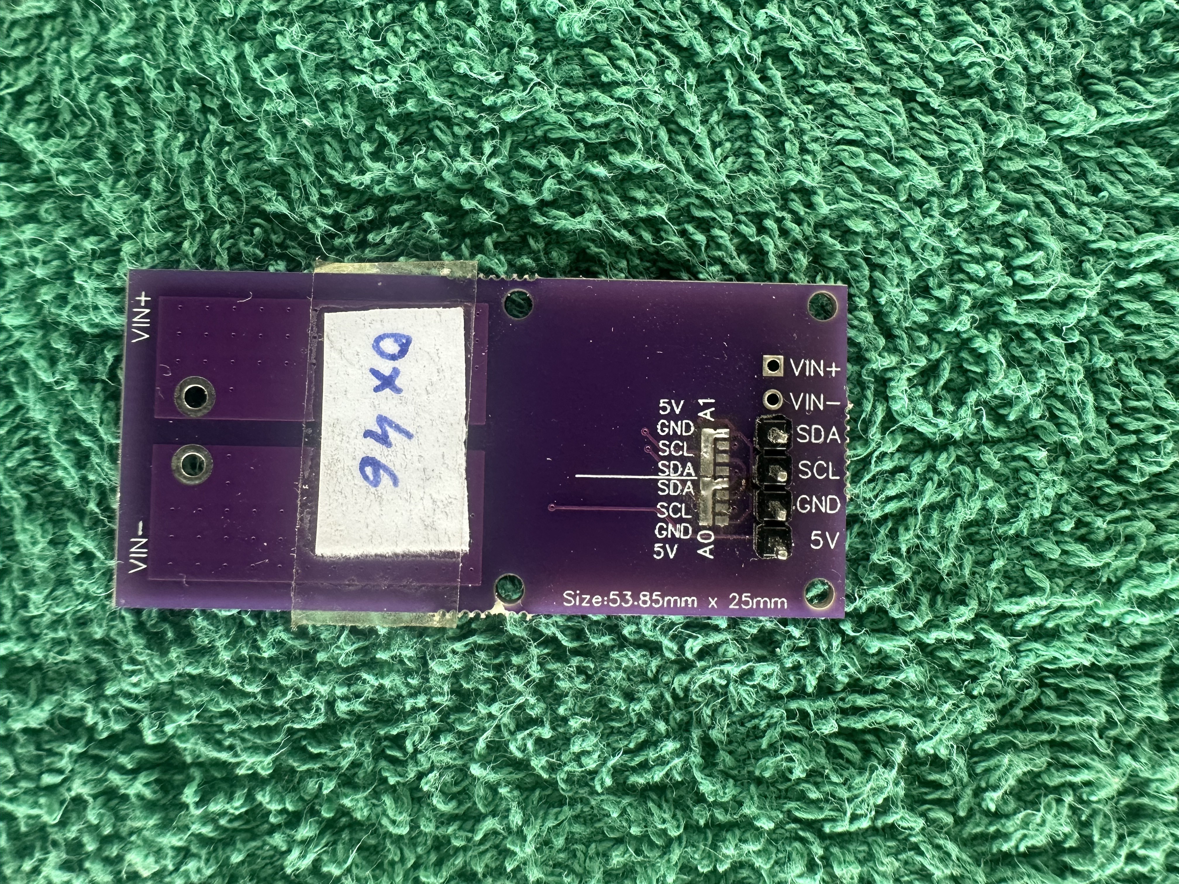

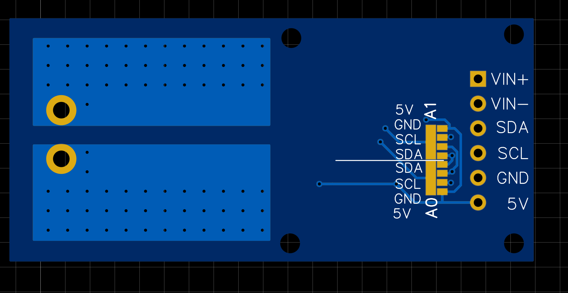

  1. Bottom Layer: Note the solder jumpers (A0, A1) for address selection.
Address Select
Address Select
