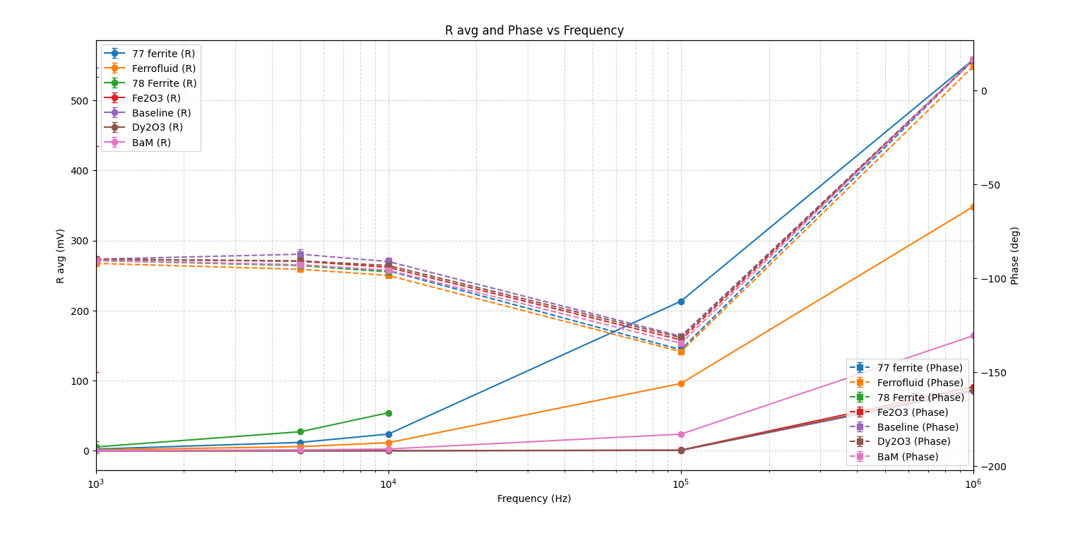

The signal from our Dysprosium Oxide (Dy2O3) calibration standard is extremely weak—hovering at just a few microvolts below 10 kHz, which is barely indistinguishable from our 6 uV noise floor. It also appears to be inaccurate to compare samples of different volumes. We compared the Dy2O3 powder against an Iron Oxide (Fe2O3) sample with 5x the volume. Based on standard molar susceptibility values, density, and volume, the Fe2O3 signal should be roughly one-third the strength of the Dy2O3. However, experimental data shows the Fe2O3 magnitude is 5x stronger—a ~15x deviation from prediction. The results for the samples are below:

The ordering is accurate except for the iron oxide which is inaccurate likely due to the volume correction error.
The baseline is also quite large, 6 uV, this may be due to poor common ground noise from our outlet, em radiation noise or other sources. At higher frequencies the parasitic capacitance between the driving and pickup coils becomes significant, this limits the frequency range of the device.

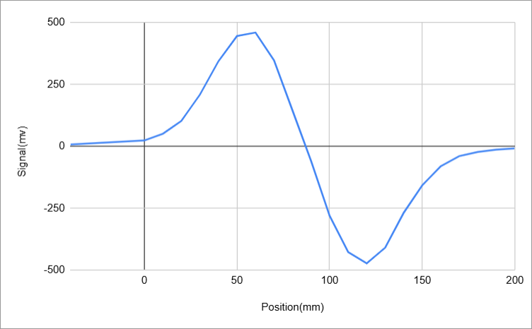

    7. Verification: With the pickup coil fixed, slide a sample through the center of the device taking measurements along the way. It should look like the image below. If one of the humps is greater than the other you need to adjust your pickup coils to have the same inductance. 3D printing a sample holder to get it centered in the pickup will help your measurements especially at higher frequencies.
