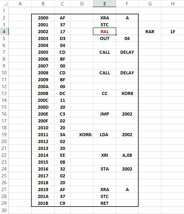

After assembly of the code starting from 2000H will look like this
 After loading the code in to the RAM starting from 2000H we are sure, at location 2002H will have 0x17 which is the opcode for RAL. We can also have RAR as the starting value.  It works.
But once we give command to execute starting from 2000H, the content of 2002H will change to 0x1F if there is a CARRY FLAG and again changes back to 0x17 if the CARRY occurs again.  This process repeats forever.

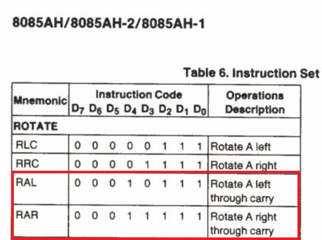

MCS-85 ROTATE INSTRUCTIONS:
There are 4 ROTATE instructions available for MCS-85 family.
  1. RLC(0x07)
  2. RRC(0x0F)
  3. RAL(0x17)
  4. RAR(0x1F)
We are using RAL and RAR instructions in our program
  • RAL = 0001 0111 = 0x17
  • RAR = 0001 1111 = 0x1F
Flip D3 to change RAL to RAR instruction
So if the D3 bit is 0 then Left rotate and if the D3 bit is 1 then Right rotate operation performed.
