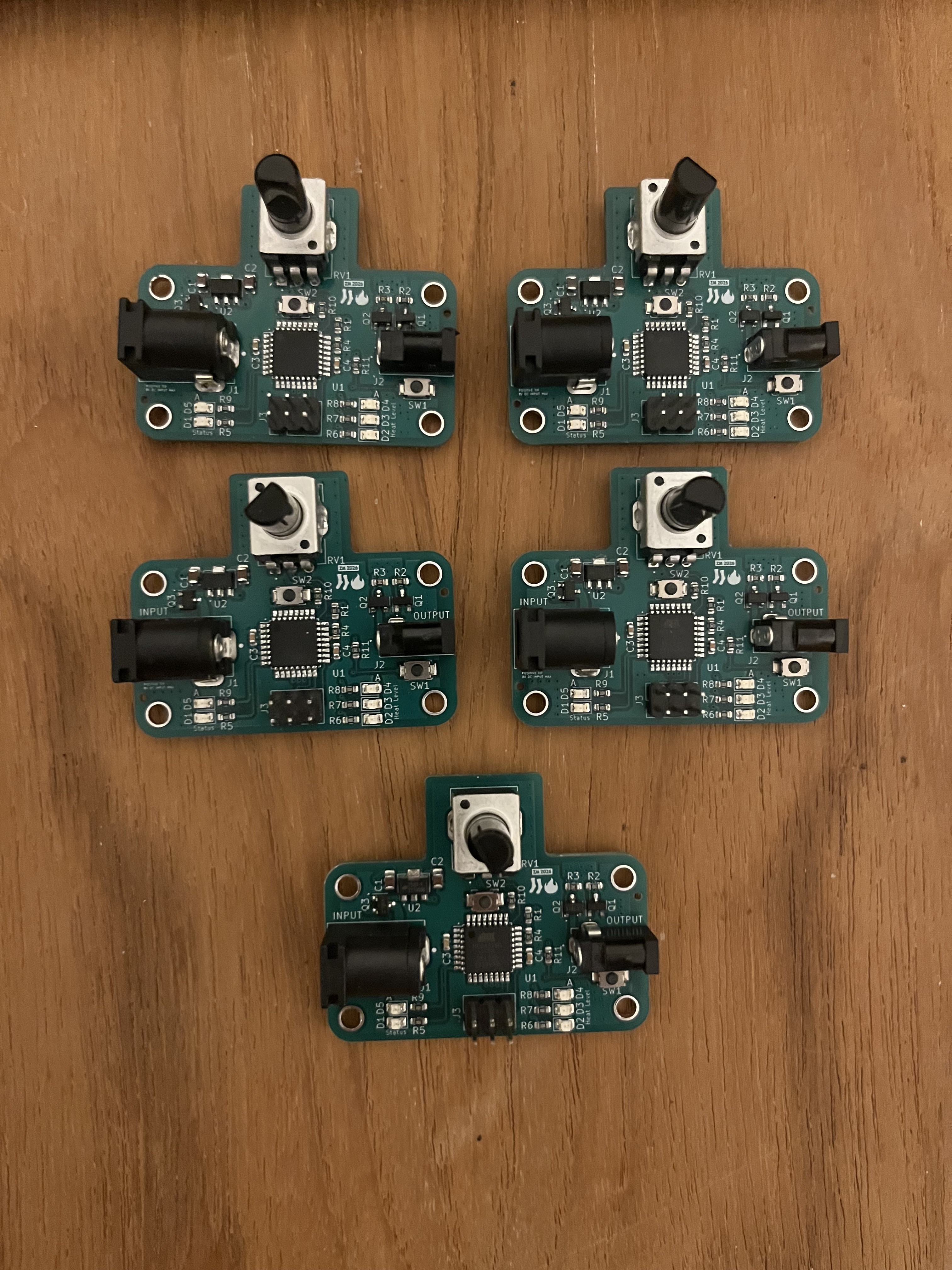

  • Assembled PCBs and wrote prototype firmware
    Zachary Murtishi01/16/2026 at 02:02 0 comments
    I assembled the through-hole components (potentiometer, jacks, and ISP programming header) onto the PCBs and was able to write a quick program to implement the core functionality I was aiming for. A 7.5V/3.2A wall wart supplies power to the module and the heated sock that plugs into it.
    The ATmega328P program works like this:
    1. On bootup, check the input voltage through J1 (barrel jack) and verify it is between 6V and 8V using the MCU ADC. This is to prevent overheating of the sock and verify that the voltage is sufficiently high to remain above the dropout voltage of the Holtek 3.3V linear regulator. If it detects an out-of-range voltage, the MCU lights an LED and ends the program in a while(1).
    2. In the MCU's ON mode, the potentiometer's position is read by the MCU using its ADC. The 10-bit ADC reading is shifted right by 2 to divide by 4 to normalize the 10-bit value to an 8-bit number so that it can be used directly with the ATmega328P PWM module on Timer0 (an 8-bit PWM generator). The PWM module will output a square wave with a duty cycle equal to the position of the potentiometer, driving an NMOS transistor which in turn drives a PMOS transistor to heat the sock. The heat level is indicated to the user by a three-level LED display: three LEDs on indicates high power, two medium power, and one low power (of course, this simply means PWM duty cycle >=66%, high, 66>PWM>=33% medium, PWM<=33% low).
    3. Pressing SW1 will put the MCU into OFF mode. This will switch off the PWM output by changing the output pin to an input and lighting an LED. Pressing SW1 again will put the MCU back into ON mode.
  • Received partially assembled PCBs
    Zachary Murtishi01/11/2026 at 15:26 0 comments
    I received the shipment of five partially-assembled PCBs from JLCPCB. It's a 4-layer design in a small footprint and I'm pleased with the manufacturing quality. The SMD components are all assembled, but the boards still require hand assembly of THT components (power jacks, potentiometer, and pin header). Preliminary bench testing shows that the reverse polarity protection and 3.3V linear regulator circuits function as designed. Once the final THT components are installed, I can start developing the firmware for the device
