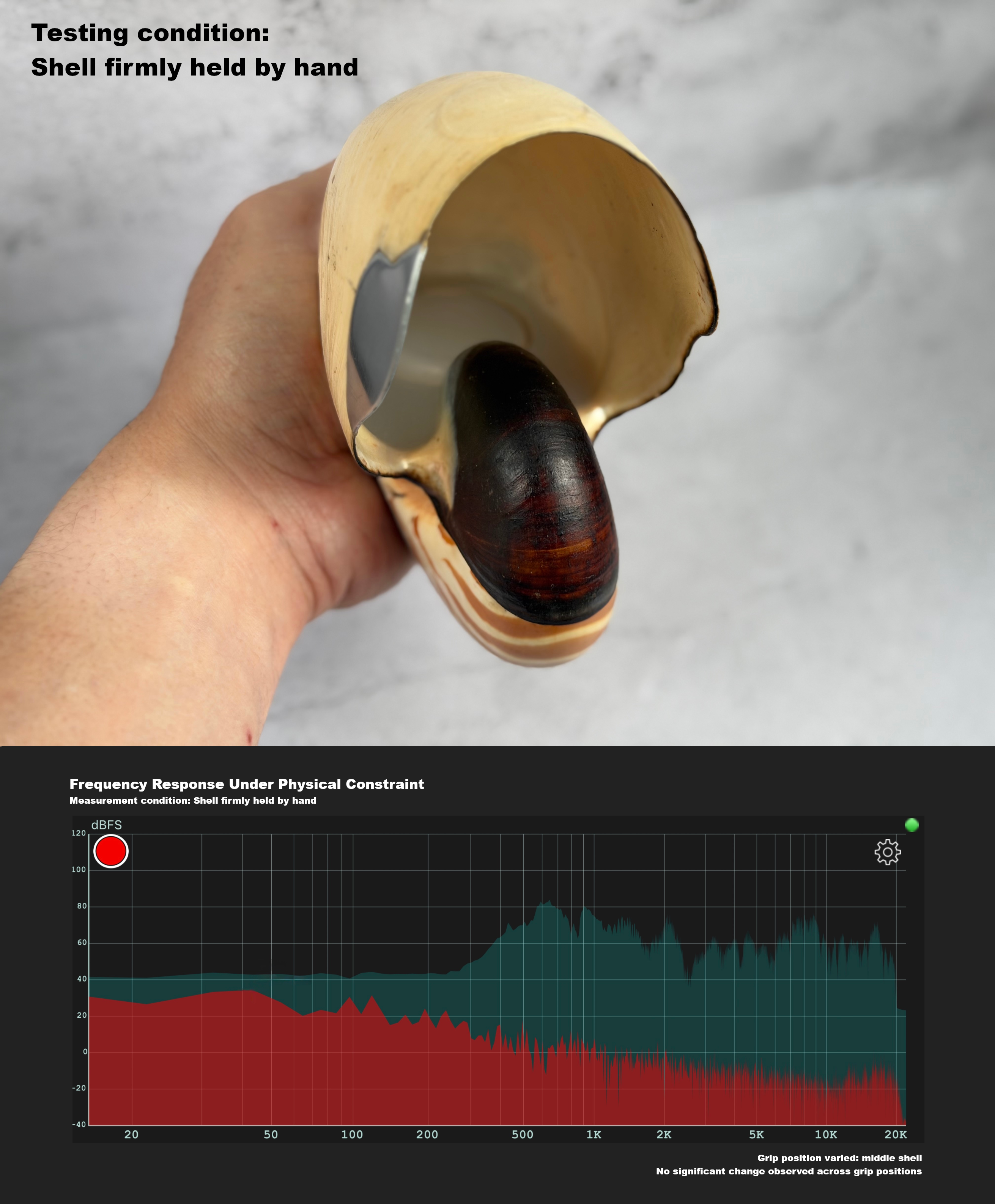

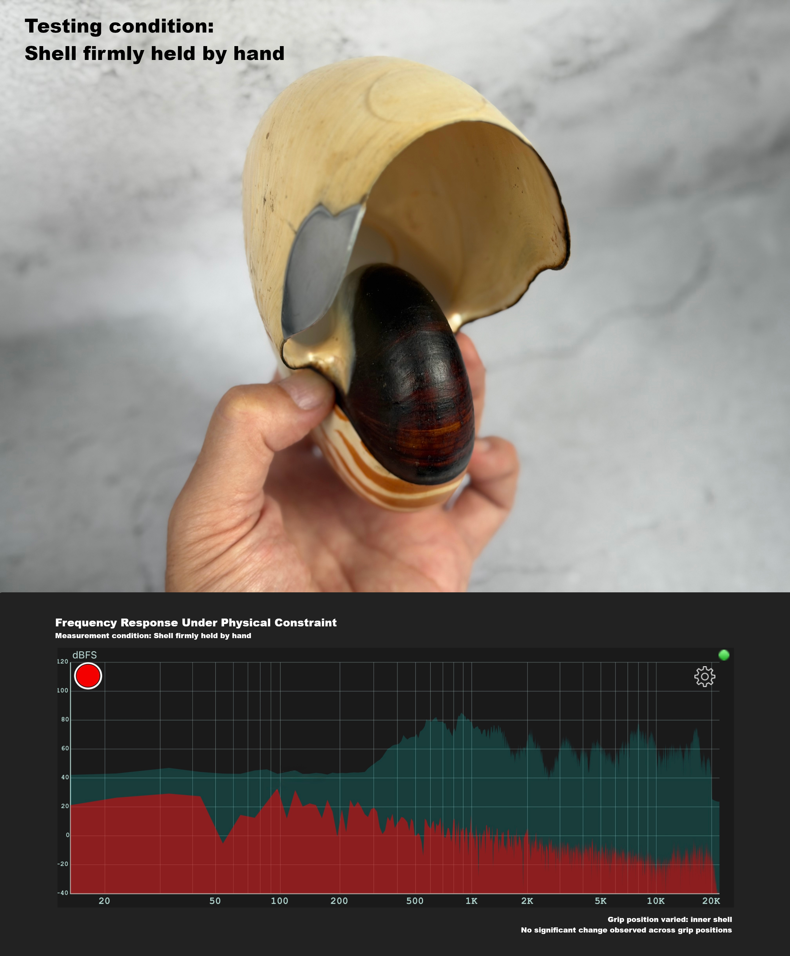

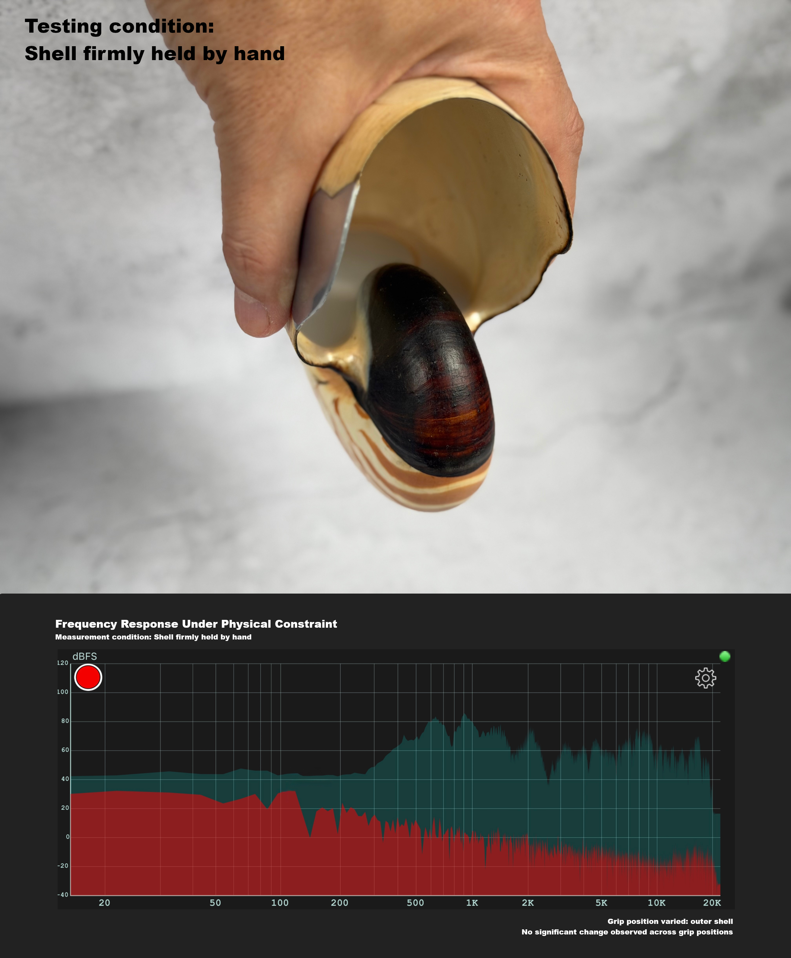

With the reference condition established, the next comparison focused on direct human contact with the shell.
In this condition (H2), the shell was held firmly by hand while the exciter continued operating under the same input signal and mounting configuration.
Three grip positions were tested:
* Inner whorl region
* Middle shell region
* Outer shell region
In all cases, the shell was actively supported and gripped by the hand, introducing substantial mechanical contact and expected damping.
Contrary to typical expectations, the measured frequency response showed no major deviation from the reference profile. Low-frequency behavior, midrange structure, and overall spectral shape remained largely unchanged.
Subjectively, no clear reduction in loudness or tactile vibration intensity was perceived by ear or hand.
This result was unexpected. Human tissue usually provides strong damping, particularly in lightweight resonant structures. In many comparable systems, hand contact significantly suppresses vibration and alters tonal balance.
The consistency of the response across multiple grip locations suggests that the shell’s global vibrational behavior is not dominated by local boundary conditions at the point of contact.
At this stage, the observation is documented without asserting causality. However, it strengthens the hypothesis that the Nautilus shell distributes vibrational energy in a highly non-local manner.

When the shell was held by hand—regardless of where it was touched or gripped (inner whorl, middle region, or outer shell)—there was no clearly audible change in sound pressure, tonal balance, or perceived vibration intensity.
This was surprising. In most small speakers or resonant objects, direct hand contact strongly damps vibration, altering both loudness and frequency response. Human tissue typically acts as a strong mechanical absorber.
Yet in this case, even firm gripping did not produce an obvious acoustic change by ear.
This observation was repeated multiple times and was consistent enough to raise a question:
Why does the Nautilus shell appear unusually insensitive to external damping by touch?
