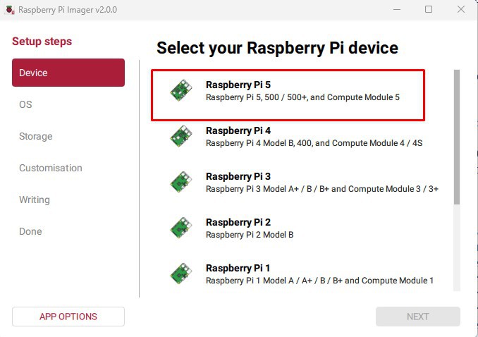

Then we need to download the Raspberry Pi imager software from the given Link. Now we need to select the Raspberry Pi model (in my case, Raspberry Pi 5).

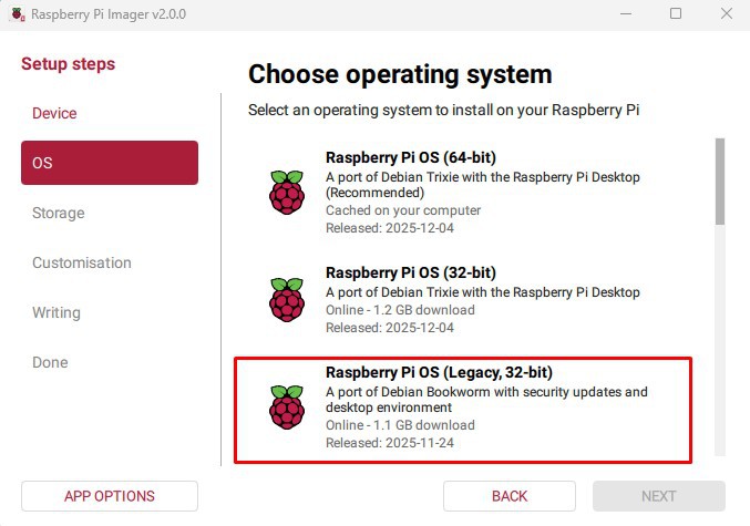

Next is the operating system, we select "Port of Debian Bookworm" according to the author's recommendations.

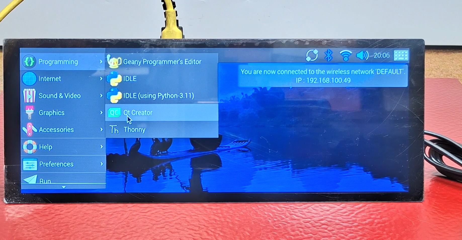

Next, we need to open the Terminal window and enter that folder with "cd linamp" - Enter. Then we copy the instructions from Github into the Terminal and press Enter. Now the installation of support (libraries and environment) as well as the program itself is being performed. This will take a few minutes. Then we go to "Programing" and we will see that new programs have been installed, Python 3.11 and QT Creator.
We start QT Creator, Open Project, Linamp folder, and activate the file named: CMakelists.txt. Now we go...
