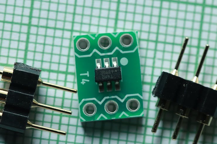

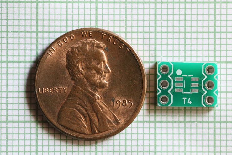

ATtiny4/5/9/10 ICs comes in 2 package style. The easier one to handle is SOT23-6 package. We can have a small adapter board which converts SOT23-6 to DIP6 300mil. We can easily get 6 pin IC Base with machined round pins. We can find the similar board from HERE which is also having Sch and Layout files.
SOT23 to DIP6
ATtiny4/5/9/10 SOT23-6 to DIP6 300mil adapter board
T4
ATtiny4 SOT23-6 to DIP6 300mil adapter

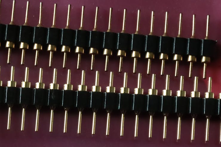

To use a machined 6 pin IC base, we also need to have round pins in the adapter.
Adapter board, IC and machined pins
These round pins are useful for handling the ICs with a 6 pin IC base.
Most of the other designs for the same purpose uses square pins with square pin compatible header. We can use those square pins for programming, breadboard development and using male or female jumper wires. But we can not fit that into a normal IC base. Since 6 pin DIP IC base is commonly used for Optocouplers, it is readily available and directly mounts on the board.
PINS
Machined pins with 2.54mm pitch and 0.8mm thick

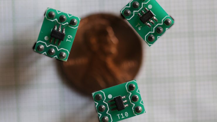

Assembled ATtiny4, ATtiny9 and ATtiny10 ICs
Now we have the devices mounted on DIP6 formfactor IC adapter boards. The device marking on silk screen is optional. It is just easy to read and handle. There is a marking for pin 1 as white dot.

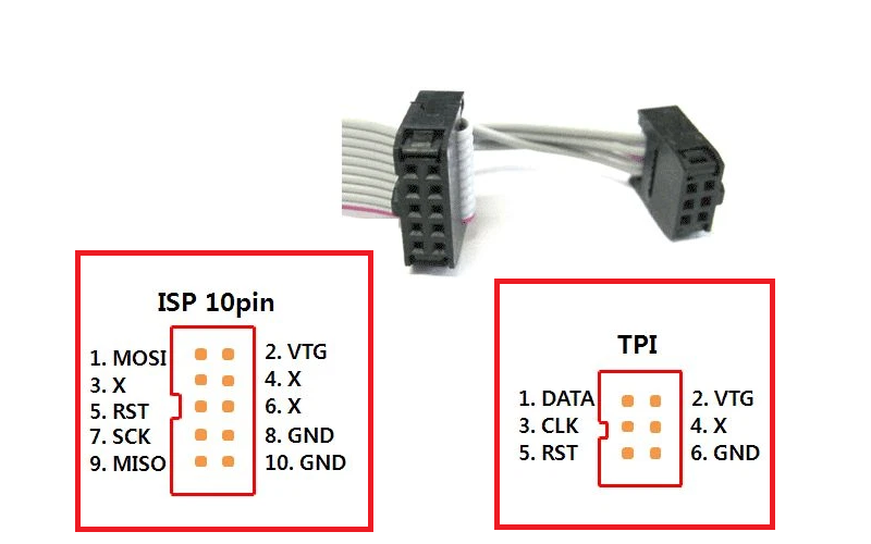

USBasp programmer uses 10 pin FRC connector and AVRISP MKII uses 6 pin connector. Depends on the programmer in hand, we need to decide which target board is useful.
ISP 10pin and TPI 6 pin connection details

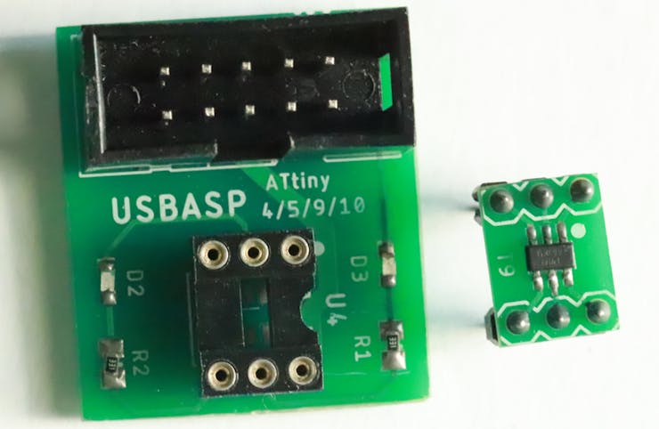

10 pin target connector:
USBasp
10 pin target board used with USBasp programmer
The above board uses 10 pin connector similar to USPasp programmer. Many pins are unused or connected to VSS. The advantage is we can directly insert the IC and programmer connector into this board for programming. There is NO additional target POWER is required.
The fully assembled board will look like below image
Assembled 10 pin target board used with USBasp
D3 and R1 and just power indicator. D2 and R2 are connected to the Target IC's RB2 port pin which is not used for programming. Both the feature are optional and not required for regular operation. U4 is 6 pin target holder. U3 is for direct soldering of SOT23-6 ATtiny IC without the adapter or IC base. Pay attention while inserting the target IC for pin number 1. Both...
