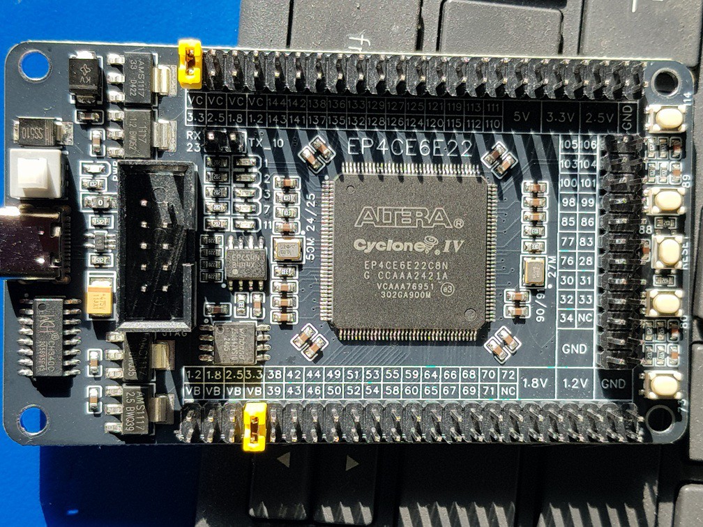

TARGET BOARD:
EP4CE6E22 with EPCS4 and CH340C
  • FPGA: EP4CE6E22C8N
    • Logic Elements (LEs): 6,272
    • PLLs: 2
    • Embedded Memory: 276,480 bits
    • I/Os: 91
    • Package: 144-LQFP
  • USB-to-Serial Interface: CH340C
    • FPGA TX pin: PIN_10
    • FPGA RX pin: PIN_23
  • Clock Sources
    • 50 MHz: PIN_24, PIN_25
    • 27 MHz: PIN_90, PIN_91
  • Push Buttons (Active-Low with Pull-Ups)
    • FPGA Reset: PIN_88
    • 4x User Buttons [3:0]: PIN_73, PIN_80, PIN_89, PIN_114
  • LEDs (Active-Low)
    • 5x LEDs [4:0]: PIN_1, PIN_2, PIN_3, PIN_7, PIN_11
  • On-Board Storage
    • Altera EPCS4N (Serial Configuration Device)
    • Winbond 25Q64JVSIQ (64 Mbit / 8 MB Serial NOR Flash)
  • Power Supply
    • +5V via USB Type-C connector
    • 4x AMS1117 LDO voltage regulators: +3.3 V, +2.5 V, +1.8 V, and +1.2 V outputs
  • Bitstream Programming
    • via a JTAG socket for USB Blaster

Onboard there are 2 clock sources available. 50 MHz(pin24/pin25) and 27 MHz(pin90/pin91). Each source connected to two clock input pins. We can use either one of them. In this case the clock connected to pin#24 which corresponds to 50 MHz input.
set_location_assignment PIN_24 -to clk
set_instance_assignment -name IO_STANDARD "3.3-V LVTTL" -to clk
 The board used already having CH340C onboard. We just need to assign the Tx and Rx pins.
set_location_assignment PIN_23 -to rxd1
set_location_assignment PIN_10 -to txd1
set_instance_assignment -name IO_STANDARD "3.3-V LVTTL" -to rxd1
set_instance_assignment -name IO_STANDARD "3.3-V LVTTL" -to txd1
