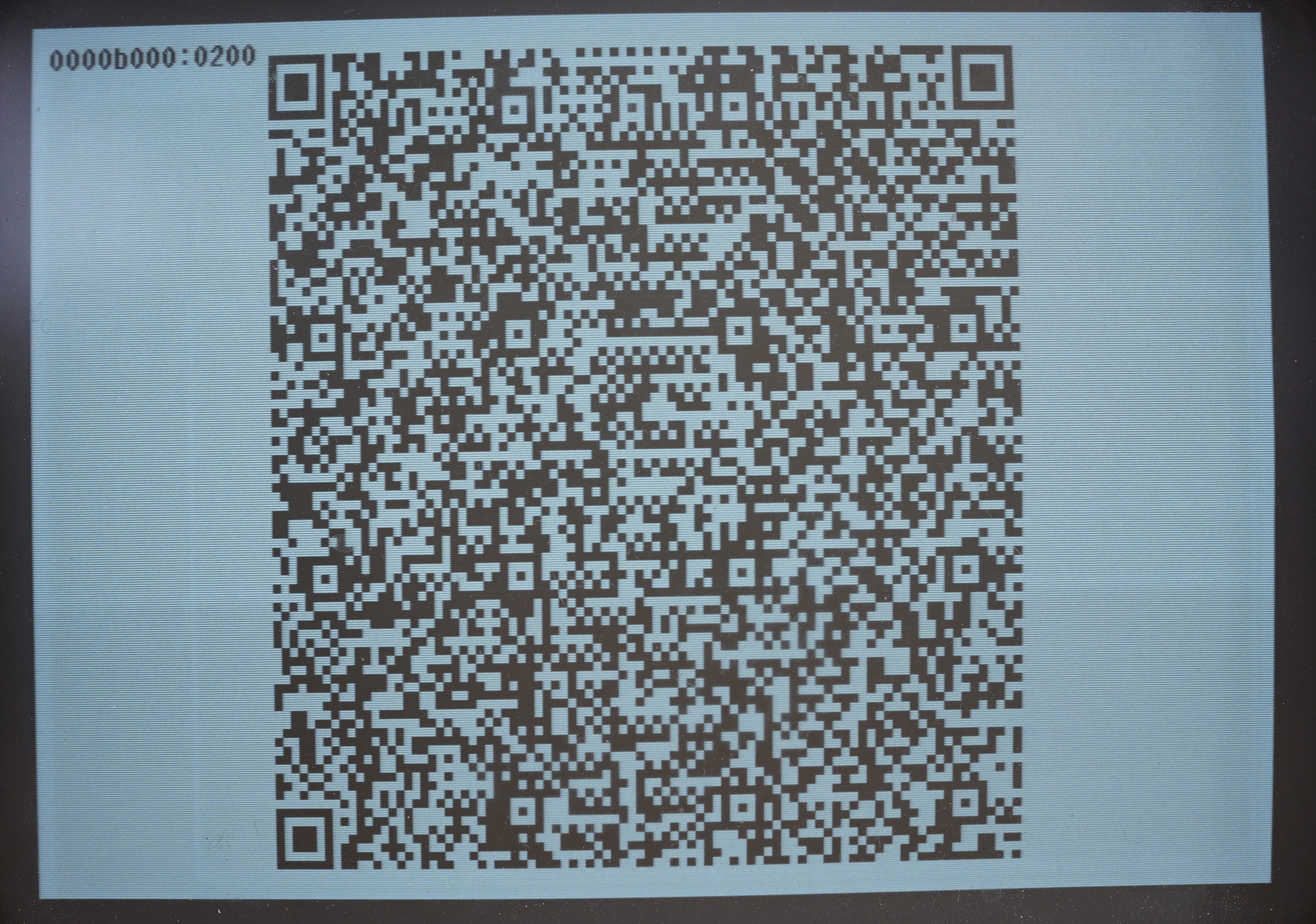

    The alternative I settled on was QR codes. Now that I could run C code on the device, I could put a chunk of ROM into a QR code, take a photo of the screen, and decode on my PC.
    The first challenge was finding a QR code library for C that I could run on the device itself. I tried some and they were slow or crashy on large QR codes. I was abotu to give up, until I came across the Nayuki library. It worked great on the device.
    The second challenge was decoding a big sequence of QR code screen photographs programmatically. It turns out that most of the standard QR code python libraries weren't able to handle the combination between the logic analyzer's little CRT screen and the large QR codes I was using. I don't know if it was the scan lines, the specific contrast issues, the screen curvature, or the Moire. I ended up going with the QReader library which uses machine learning to preprocess the QR code. As a result it takes several settings. But it works. For most of the images.
    I ended up sending 512 bytes of ROM at a time, base64-encoded (I couldn't get binary-encoded QR codes to decode properly using QReader). QR code generation on the logic analyzer was slow, and I added a bit of a pause. As a result, each QR code was shown for about 10 seconds at a time. I had a Sony A7RII camera pointed at the screen, with an external timer taking a picture every two seconds, in case not every picture worked. The setup took about a thousand pictures. I downsized them with Imagemagick, and ran them through QReader to reconstruct a ROM binary. All code is here.
    At some point the cat walked between the camera and the screen, but didn't stay long enough to mess up all the pictures of that particular QR code. I had one hiccup: I accidentally deleted the photos mid-way through the run, and had to re-take the rest.
    But then I had a nice 64K ROM file, which I was able to run through Ghidra.

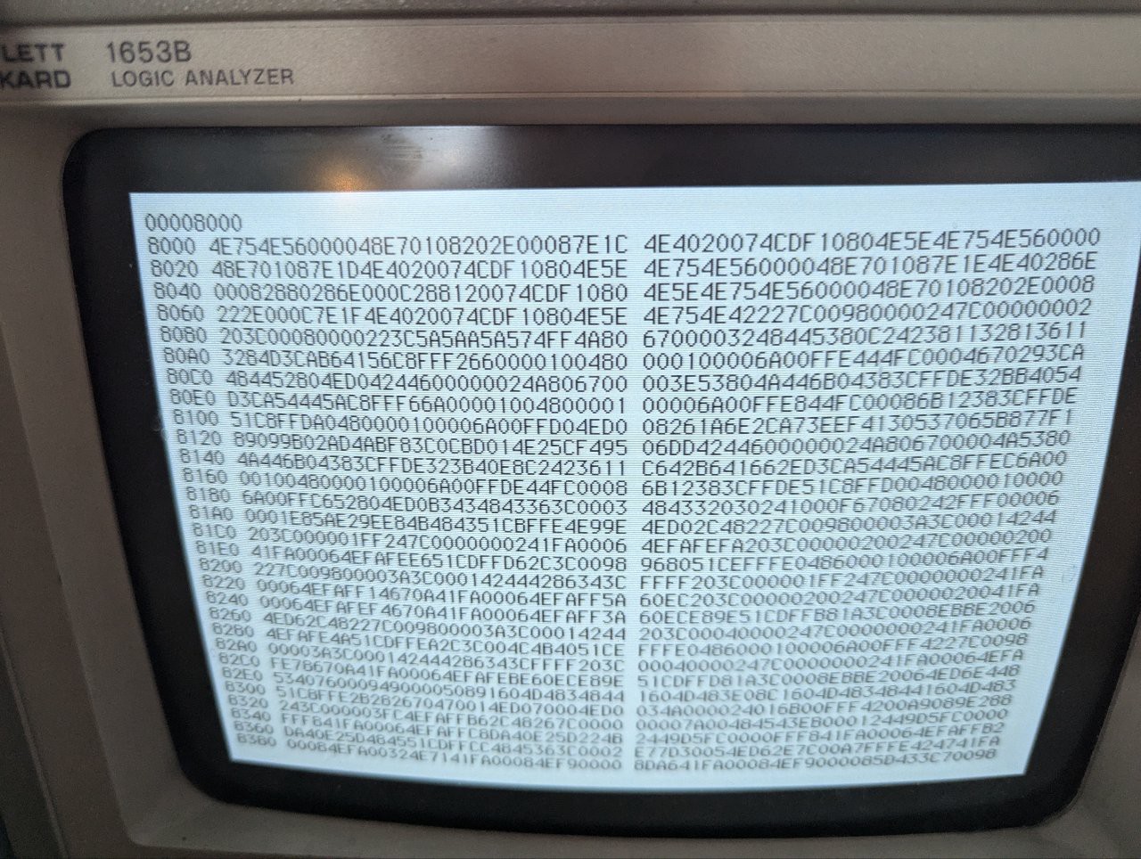

    Writing to the screen turned out to be more confusing than I expected. Writing zero bits did nothing. Writing one bits did different things at different times. It turned out from the Ghidra disassembly (I could also have learned this from the MAME code) that there were different writing modes controlled by a write-only hardware register at 0x0200100. For instance, if it's in mode 0xFE00, then writing 1's produces white pixels, while in mode 0xFF00, writing 1's produces black pixels. Discovering the intricacies of the screen i/o would still be for the future, but at least I was able to do basic output--put text on screen, and draw pixels.
    Next was input. I eventually found a ROM get key routine that the code called (0xEB38). With input and output I was in theory able to do a lot.
    I wrote various small bits of assembly test code, including a lot of code to dump memory locations to the screen. (The latest version is here. You can specify which address to go to, and press RUN to toggle whether the display is static or dynamic.) I was able to learn where in RAM the ROM code stored the current key and various information about the spinner state. (See my ever-evolving "messy notes".)
