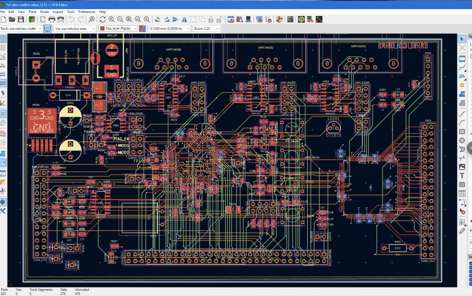

    But for a more complicated board the differences are more apparent. Here again is the board I posted about recently, with bus routing enabled in KiCadRoutingTools:
    And here is FreeRouting on the same board:
    FreeRouting actually failed to route 4 of the nets here. And it took it ~10 minutes. KiCadRoutingTools took ~1 minute and routed all tracks.
    KiCadRoutingTools gives tracks that are far more natural and organized than the Manhattan-style FreeRouting algorithm.
