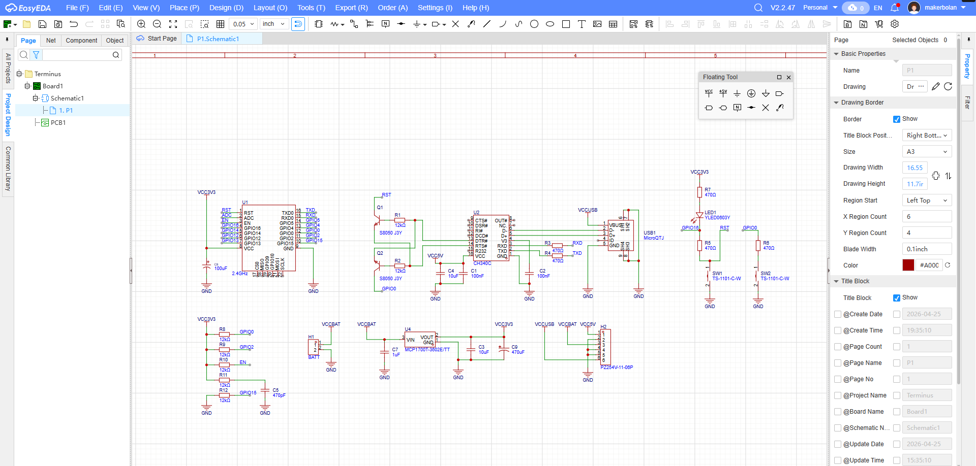

  • PCB Design Started!
    Bolan Xu05/10/2026 at 04:52 0 comments
    So I finally started working on a real PCB for this project in EasyEDA and I'm pretty excited to see where this goes!
    If you've been following along you already know what's in here. But with the PCB, I'm planning on using CH340C for USB-serial, MCP1700 for battery power, USB-C connector, and a bunch of resistors and caps. Nothing new really, just finally getting it all onto an actual board. The buttons will be fun.
    I'll post back here when I'm finished with the design!
    Stay tuned!
