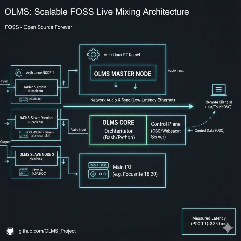

TECHNICAL ARCHITECTURE
To make the project concrete, I have defined the following architecture (full documentation available on GitHub: https://github.com/Open-Live-Mixing-System-OLMS/Open-Live-Mixing-System/blob/main/README.md ).
Technology Stack:
OS: Linux RT (Arch) with PREEMPT_RT kernel
Audio Core: JACK2 (Primary) / ALSA Backend (Fallback)
Engine: Ardour 8 Headless
Middleware Logic: Lua Scripts (integrated within Ardour)
Protocol: OSC / WebSocket (Native)
Interface: Open Stage Control (Custom Web UI)
2-Layer Structure:
Core (GPL): Ardour headless (48ch Template, Lua-based Bank/IO Management).
Interface (GPL/Proprietary): Open Stage Control layout serving as the Web UI.
Real-Time (RT) Optimization:
Hardware-specific IRQ pinning and CPU frequency scaling management.
Target: Latency 5-10 ms @ 128 samples, <2 xrun/hour.
Current Phase: Initial setup completed (Arch Linux + Ardour 8 + JACK2). Next steps: 16ch template configuration with 2-bank management, dynamic routing via native Lua API, and stability testing using ALSA loopback.

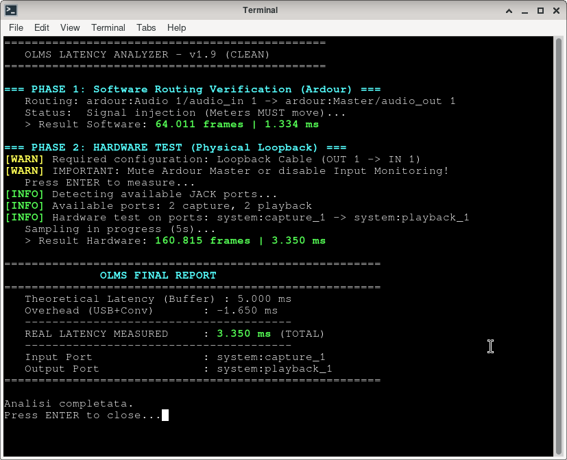

    I have been chasing an obsession: eliminating the compromise between the flexibility of Linux and the deterministic stability of proprietary live mixing systems.
    Today, initial tests on the OLMS (Open Live Mixing System) POC 1.1 have delivered results that exceed expectations: 3.350 ms Real-World Latency (Total Roundtrip) using a standard Focusrite Scarlett Solo.
    We are below the human threshold of perception. The engine is running. However, as a hobbyist developing in collaboration with AI, I am fully aware that a Proof of Concept is not a finished product. To bring OLMS to the professional stage, we need an architecture that, today, only exists on paper.
    🛠 The Technical State of the Art (Roadmap & Debt)
    The current system orchestrates an Arch Linux environment with a Real-Time Kernel, managing JACK2 and Ardour in headless mode via Xvfb. It’s solid, but "monolithic." To reach the next level, we are missing critical engineering components:
    - Distributed Clock & Resampling: We need to integrate zita-resampler and stabilize the network audio layer to manage Slave nodes
    - Deterministic Master/Slave Alignment: We need a logic that ensures all nodes in a cluster stay synchronized with zero jitter and predictable latency
    - Control Plane & Remote Networking: We lack the infrastructure for remote control. We need a local server exposing APIs (OSC/Websockets) to connect the Core to a remote UI.
    - In-Surface Extensibility: Once the infrastructure is stabilized, we need to unlock the potential of Lua scripting for dynamic processing and live-ready automation.

  • 3.35ms latency on real hardware. Looking for 3-5 co-builders to scale the architecture
    Francesco Nano02/16/2026 at 15:41 0 comments
    OLMS (Open Live Mixing System https://openlivemixingsystem.org/ ) Proof Of Concept is running stable. Latest tests on Focusrite Scarlett Solo confirm 3.350ms real-world latency (hardware loopback) with only 1.650ms USB/converter overhead against theoretical buffer size. This isn't a weekend experiment—it's a professional live mixing infrastructure: headless, deterministic, RT-optimized.
    The Gap We're Filling Hardware digital mixers: expensive, closed, fixed capabilities. Standard DAWs: not designed for headless reliability in critical live contexts. OLMS bridges this: a distributed, modular mixing engine optimized for RT kernel, turning commodity hardware into professional-grade low-latency audio processing.

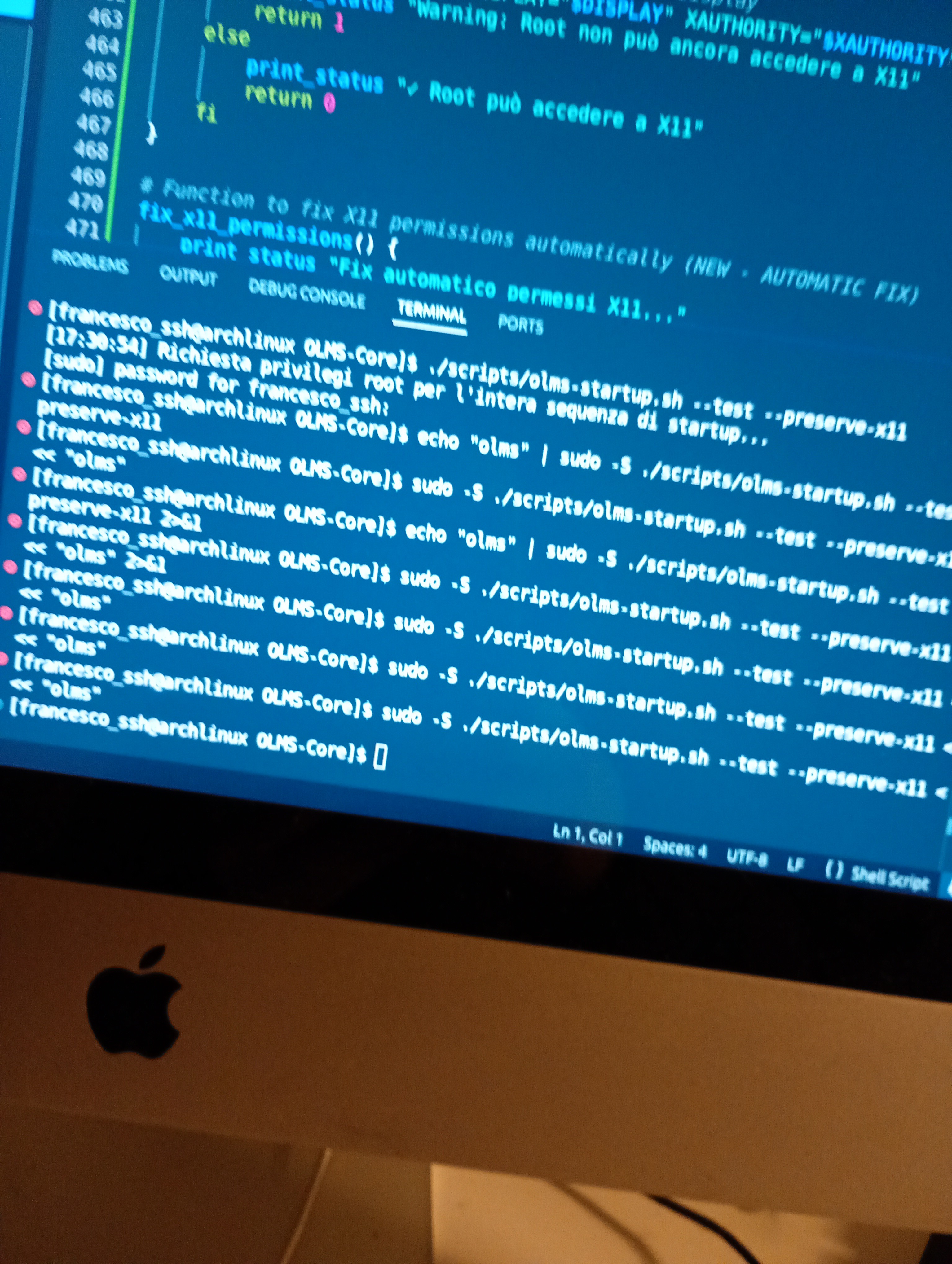

    Hi guys, I'm keep working hard on the audio engine startup process. It's very difficult because I'm going di do it avoiding systemd and trying to do everything on a started and running machine.
    The main challenge is we have 3 pieces which have to run together but with different privileges and starting users.
    Asla, jack and ardour.
    Very technical issues and solutions. In true I don't know exactly everything. The main part is AI driven. I'm the ai chief. I'm like a music producer that feels music but isn't able to explain musicians what to do because he's not understanding music theory, chords, and so on...
    I know what I want but I have no idea how to reach it. A lot of time is invested onto fails and bad ways.. make, come back, try again.
    Some times things goes right, after 1 minute anything is working anymore.
    Anyway... I'm at99% of a really important piece of this work: startup process running to start asla, jack and ardour all together in a very high performance high tuned machine.
    This assure ardour will run in a real time kernel in the best way possibile to match live low latency mixing needs with a standard PC.

  • Very high frustration level
    Francesco Nano02/01/2026 at 16:37 0 comments
    Audio engine startup seems working but... Isn't!! 😲🤬😡🤬

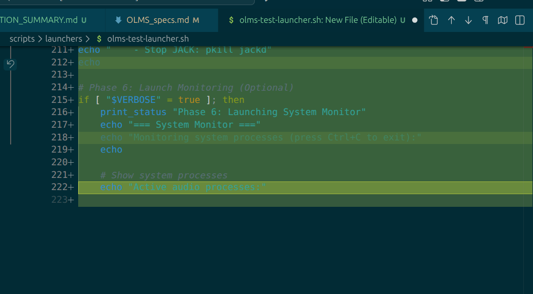

  • OLMS Core Refactoring: Modular Architecture and Enhanced Launchers
    Francesco Nano01/29/2026 at 07:57 0 comments
    A comprehensive refactoring of the Open Live Mixing System (OLMS) Core scripts by implementing a modular architecture with enhanced launcher capabilities for both development and production environments.
    Key Improvements
    1. Modular Script Architecture
    Before: Monolithic scripts with unclear responsibilities
    After: Hierarchical, modular architecture with clear separation of concerns
    New Script Structure:
    olms-startup.sh (Main Coordinator)
    ├── Phase 1: rt_tuning.sh
    ├── Phase 2: irq_pinning.sh  ├── Phase 3: prepare_machine.sh [args]
    │   ├── Phase 1: rt_tuning.sh
    │   ├── Phase 2: irq_pinning.sh
    │   └── Phase 3: olms-apply-affinity.sh
    └── Phase 4: audio_engine.sh [args]

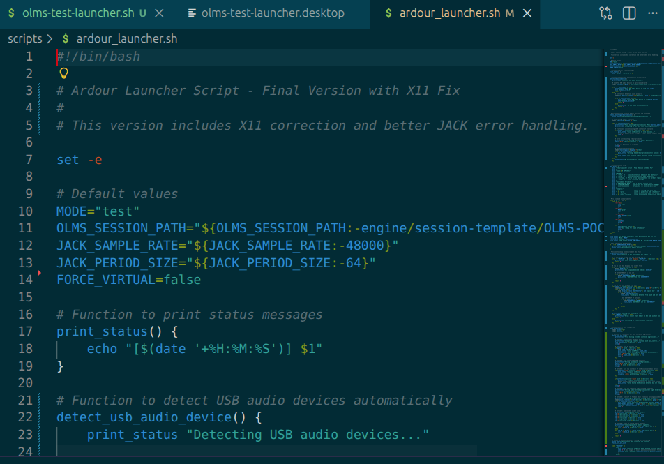

    olms-apply-affinity.sh - CPU Affinity Configuration
    • Sets CPU affinity for audio processes (JACK, Ardour)
    • Configures process priorities (nice/renice values)
    • Allocates dedicated CPU cores for audio processing
    • Verifies CPU affinity settings

    3. Enhanced Launcher System
    Launchers Directory Structure:
    scripts/launchers/
    ├── olms-test-launcher.sh     # Development/testing environment
    └── olms-prod-launcher.sh     # Production/headless environment
    Test Launcher Features:
    • GUI-enabled startup for development and debugging
    • Comprehensive system verification
    • Verbose output and monitoring capabilities
    • Detailed error handling and status reporting
    • Development environment instructions
    Production Launcher Features:
    • Headless operation for automated performance/recording
    • Optimized startup sequence for live environments
    • Minimal user interaction required
    • Production-focused monitoring and logging
    • Resource optimization for stable operation

    Systemd Service Integration:
    • Updated ardour.service to use audio_engine.sh
    • Synchronized script paths and parameters
    • Maintained compatibility between testing and production
