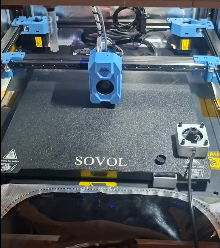

As a Mechatronics student in the Dominican Republic, I wanted to build an Ion Drone which required a custom planar flyback transformer and later attempted to miniaturize a pair of AR glasses for my university capstone project. In both cases, I hit a wall: getting a custom PCB meant waiting 3 weeks for shipping from China. That delay kills creativity. In underdeveloped countries, innovation is paralyzed by logistics. While we study advanced concepts like Quantum Computing and Plasma Physics, we lack the nanotechnology facilities to build the hardware. Existing solutions like NanoDimension or Voltera are priced for Fortune 500 companies ($50,000+), not for students. I realized that to solve this, I couldn't just buy a printer; I had to build a platform capable of manufacturing custom electronics locally, instantly and cheap. The Solution: I am building an open-source Hybrid Tool-Changing Platform that integrates six distinct manufacturing processes into a single automated workfl
Consisting in a 3d printer that integrates six distinct manufacturing processes into a single automated workflow by using a toolchanger for printing/assembly electronic hardware:
  1. Structural FDM 3d Printer extruder: High-temperature extrusion of engineering thermoplastics (ASA/PC) to create the chassis and dielectric layers..
  2. Laser Sintering (10W): used for the in-situ reduction of metal-oxide inks, synthesis of Laser-Induced Graphene (LIG), and precision cutting/engraving of masks.In-situ reduction of Copper Oxide inks and synthesis of Nickel-Graphene sensors (LIG), laser engraving and cut.
  3. (Future goal/ outscope / pending) Direct Ink Writing (DIW): Precision dispensing of conductive pastes using syringes or inkjet cartridges.
  4. Wire Embedding: Automating the embedding of twisted-pair copper wire for high-current power rails and data lines.
  5. (Future goal/ outscope / pending) Pick & Place: SMD placement of commercial silicon components.
  6. (Future goal/ outscope / pending) In-Situ Etching: Laser-masked acid etching for high-precision copper PCBs directly on the bed.
  7. Drag knife tool / Pen Holder: for cutting copper foil if used or painting silk mask over tracks.

  • Stealthchanger Shuttle Installation
    Joanbelk2 days ago 0 comments
    Last week I finished wiring the OptoTap Sensor in all electrical tools and installed the Shuttle for toolchanging. I ran on some problems, like not verifying the OptoTap sensor properly working, and also had a electric short with the Optotap sensor in one of the extruders... (doesnt power up now, maybe I will check the buck converter circuit of the micro in the PCB or buy a new one).
    I hope this week to work in the software to at least record a video of the system automatically switching tools.

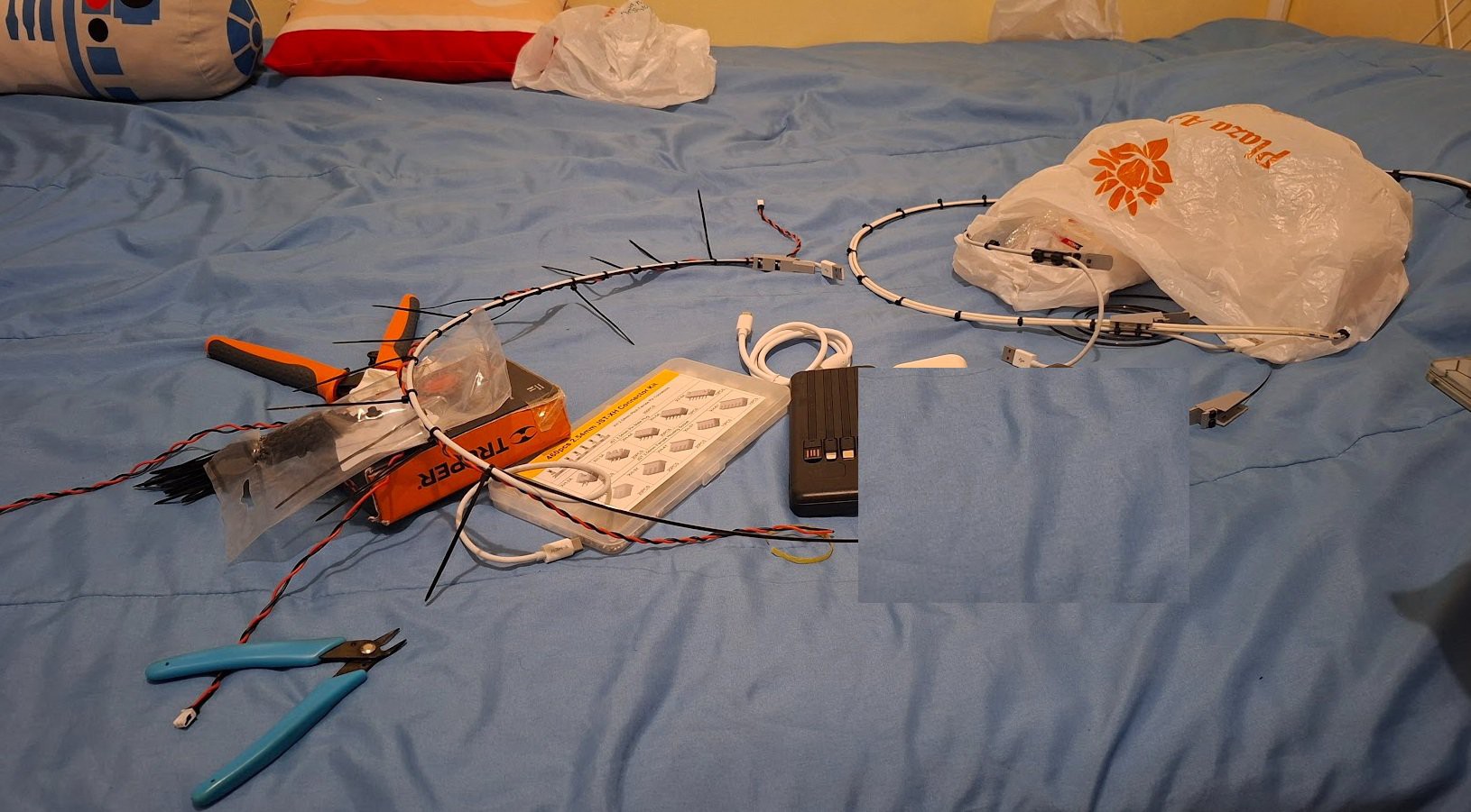

  • Umbilicals and Tools Wiring
    Joanbelk04/14/2026 at 00:12 0 comments
    Actual Date> 2-Apr/2026
    Started the tedious process of makeing the wires for each tool, each one has USB and JST connectors for the 24V or USB.
    Also wired some tools>
    Ended like this>
