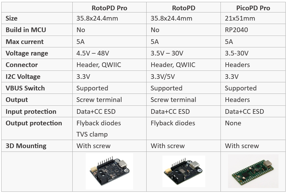

With the continuous improvement from the previous generation of RotoPD, our RotoPD Pro leverages advanced power delivery protocols 3.1 to achieve a full specification output range— 4.5V to 48V at 240W max. The breakout board use a stand alone Power Delivery Sink controller to negotiate with your modern charger and provide different output voltage.
Standard trigger board can select fix voltage like 5V, 9V, 15V, 20V, and 28V. Centylab's RotoPD Pro unlock more advance mode in your USB-C power supplies like Programmable Power Supply (PPS) and Adjustable Voltage Supply (AVS), to provide even more granular voltage adjustment. The RotoPD simplifies power negotiation with USB-C adapters, handling the complex process of establishing power delivery contracts. The controller does all the heavy lifting of power negotiation and provides an easy way to configure over I2C, free your micro-controller from the complicated USB-C PD protocol.

Technical specification
  • USB PD chip: AP33772S
  • Current sensor IC: INA238
  • USB-C voltages: from 4.5V to 48V
  • Maximum current: 5 A
  • Maximum power: 240W (48 V at 5 A)
  • Aux power: 5V@0.4A
  • Current reading: 0 - 5 A at ±2% accuracy up to 60C
  • Configuration: via I2C at 3.3V logic
  • Connectors: USB Type-C, headers, Qwiic/STEMMA QT
  • Weight: 6 g
Features
  • Input and output voltage range of  48V at 5A max
  • On board buck for 5V output at 1A max, 0.4A continuous
  • Support Qwiic or STEMMA QT in 3.3V Only
  • Support PD3.1 EPR/AVS Up to 48V and SPR/PPS Up to 21V
  • Certified USB PD3.1 v1.6  TID: 10062
  • Integrated ESD and flyback diode protection
  • Integrated NTC temperature monitoring
  • On board VBUS switch (back-to-back NMOS)
  • Current sensing from 0 to 5 A at ±2% accuracy up to 60C

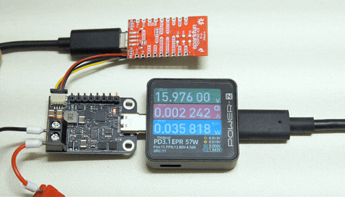

    CentyLab04/13/2026 at 07:37 0 comments
    We didn’t develop the library from scratch — we modified it specifically for the RotoPD Pro application. This IC is very important because it handles OVP (Over‑Voltage Protection) and OCP (Over‑Current Protection) for downstream devices.
    I couldn’t get a good photo of the code, so here’s a picture of the Rev 1.1 board instead.

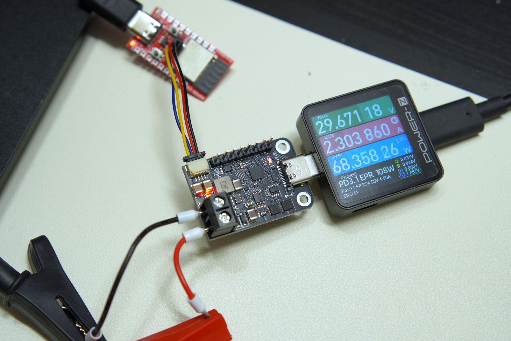

  • Quick fix actually work
    CentyLab03/20/2026 at 07:03 0 comments
    Swapping out the 3.3V -> 5V level shifter IC just solve this GitHub issue. We also need to swap out 2 (two) other resistors as the calculation was not correct. Basic functionally is working now!
    Next step: Firmware development!
