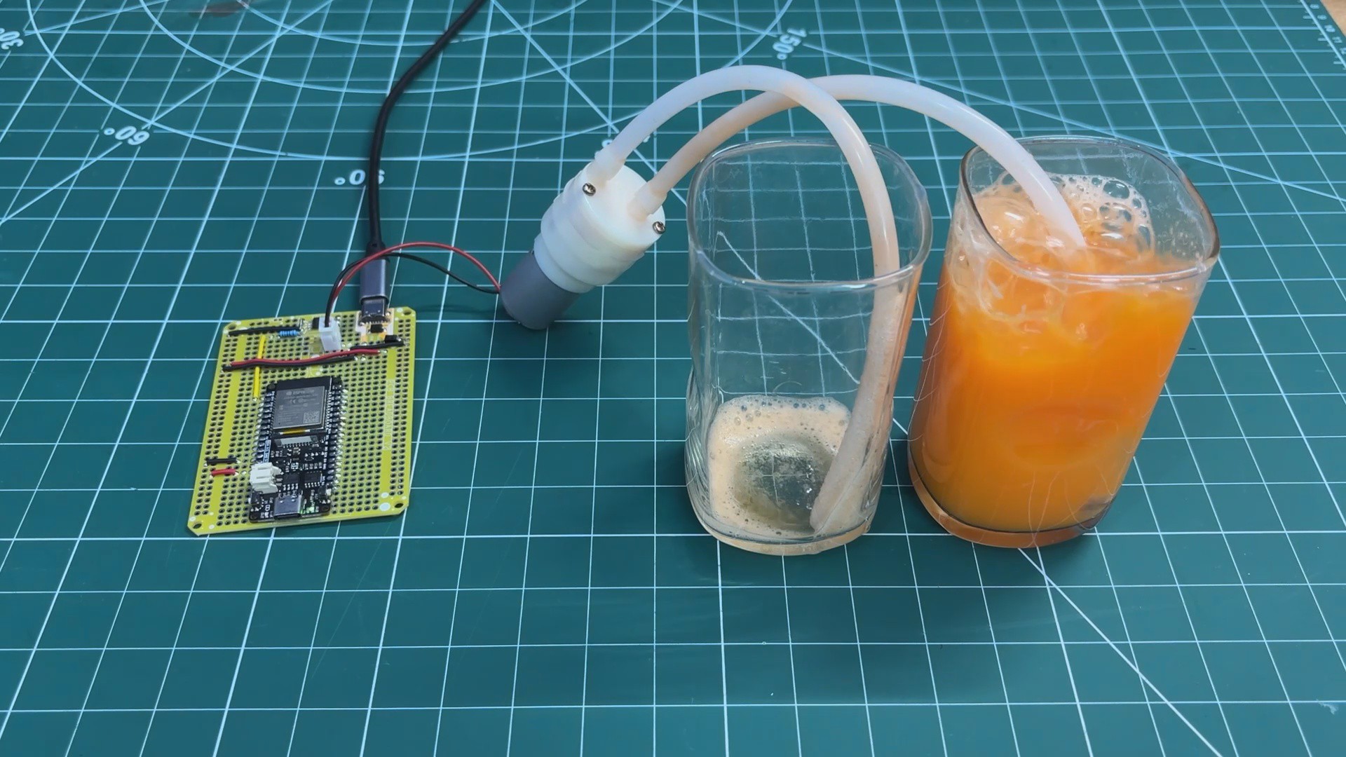

I recently had to work on a DC pump–based system for an upcoming project. In this project, the requirement was to drive multiple DC pumps in order to transfer a specific amount of liquid from Container A to Container B. To control the DC pumps, a MOSFET driven by a microcontroller was required. While this kind of circuit can be quickly built and tested on a breadboard, it isn’t ideal for longer testing cycles or repeated use. Breadboards are great for quick prototyping, but loose connections, accidental shorts, and wires coming out of place can make testing unreliable. To solve this problem, I decided to create something more solid and permanent than a breadboard, while still retaining the flexibility of prototyping. This led to the creation of a PCB breadboard.
The PCB breadboard includes a dedicated SOIC-8 footprint, allowing an AO4406 MOSFET to be soldered directly onto the board. This setup provides a much more reliable and compact solution compared to a traditional breadboard. The PCB breadboard was then paired with an ESP32 to drive the DC pump efficiently.
This article covers the complete build process of the DC pump driver circuit implemented on a PCB breadboard.

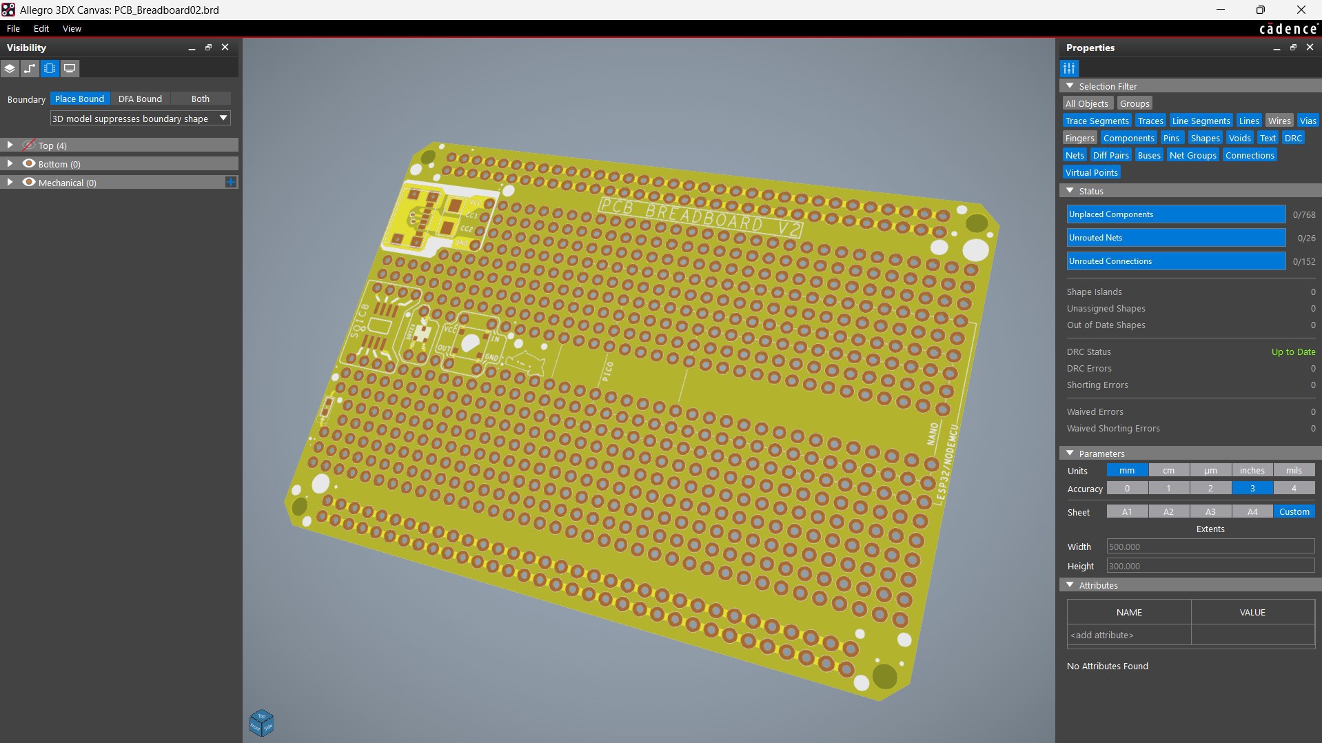

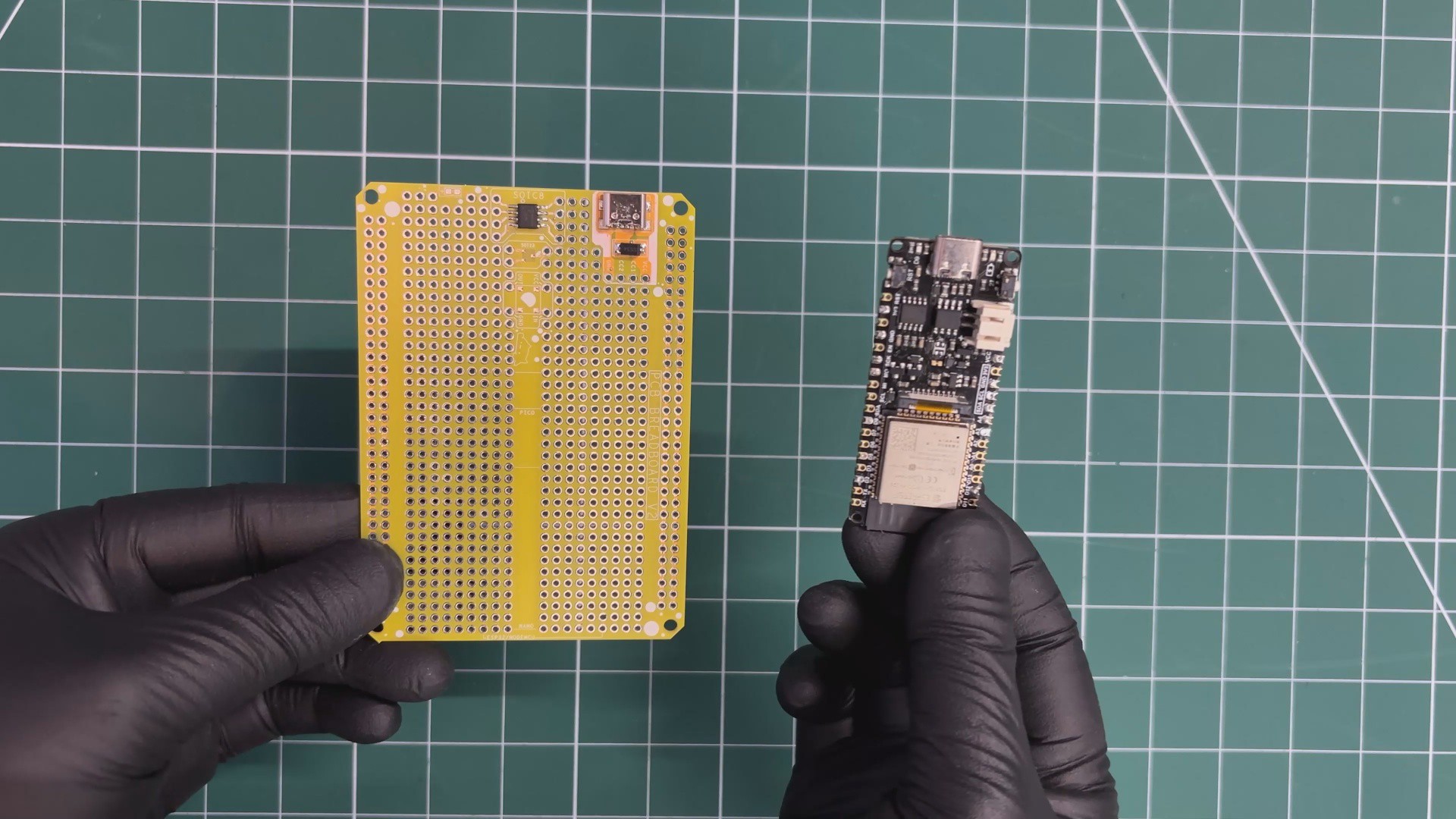

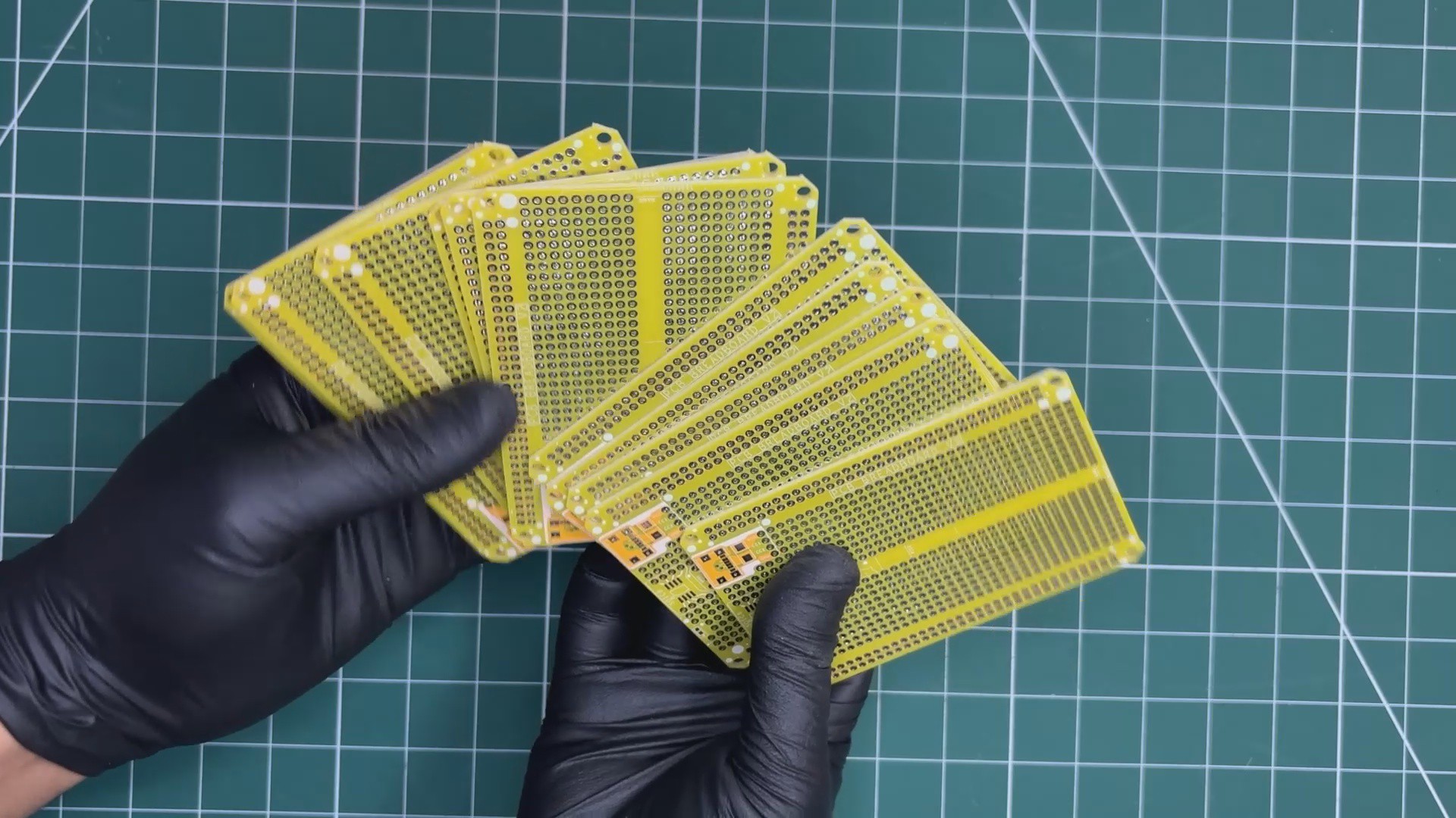

PCB BREADBOARD

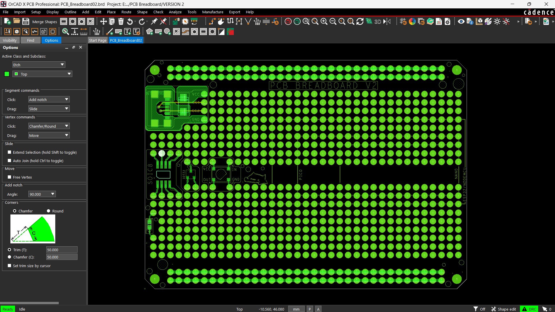

Usually, when starting any electronics project, we begin with a breadboard for quick and general prototyping. Once the circuit is finalized, the next step is typically to move everything onto a perf board or prototyping board, which offers a more stable and permanent setup compared to a breadboard.
However, I’ve always found perf boards to be bland, boring, and limiting; they’re usually single-sided and don’t offer much flexibility.
To solve this, I decided to design and build my own PCB breadboard, tailored specifically to my prototyping needs.

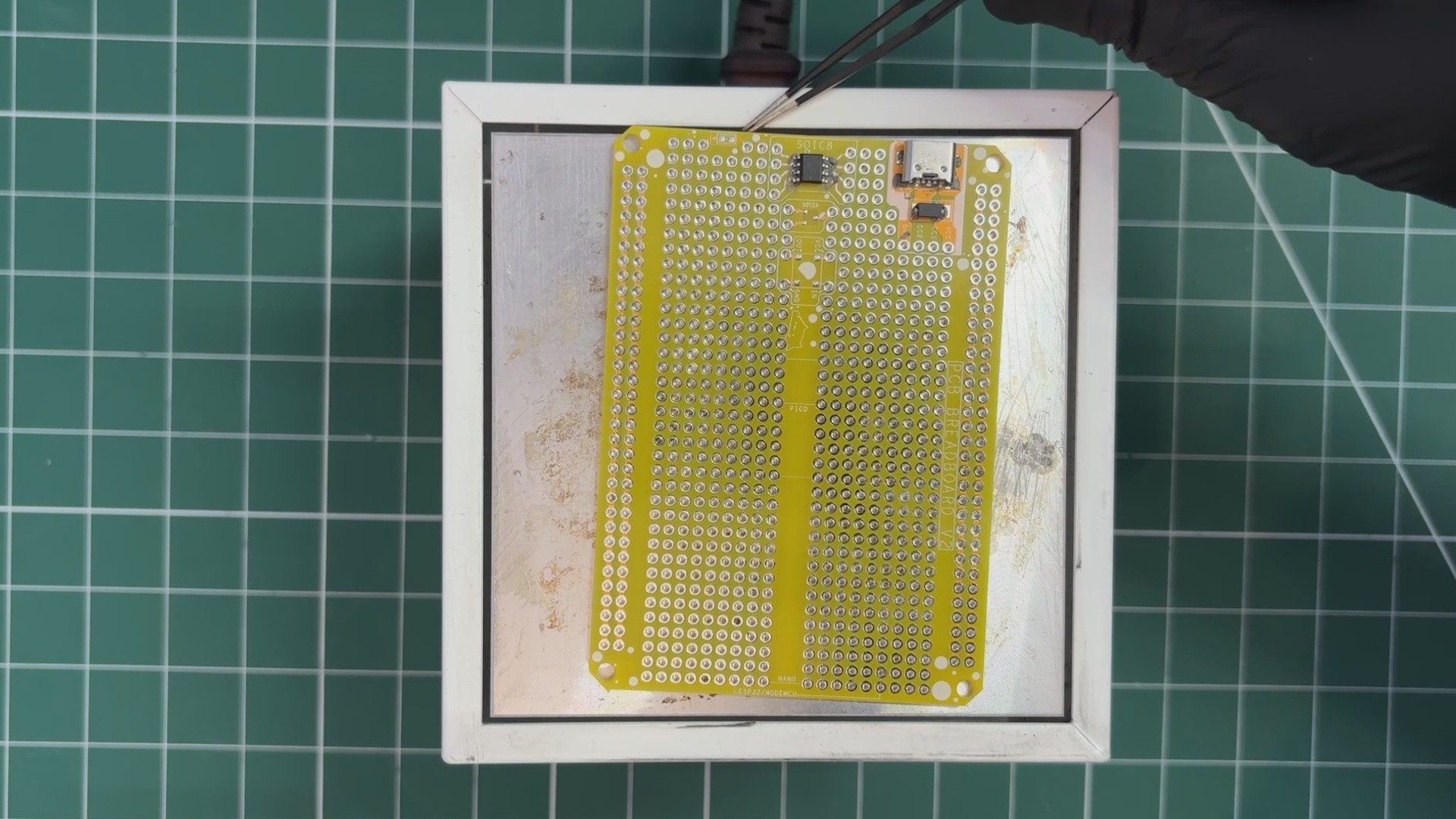

The first requirement was input power, which was addressed by adding a USB Type-C port to the PCB breadboard, along with an M7 forward diode for protection.
Next, an SOIC-8 IC footprint was added. This allows users to easily work with SMD ICs in SOIC-8 packages, making the board especially useful for SMD prototyping when the component being used is not available in a through-hole package.
To add some visual flair and functionality, an addressable LED footprint was also included, allowing a WS2812B RGB LED to be mounted directly on the board. In addition to that, a 0603 LED footprint was added for simple status indication.
The overall layout of the PCB breadboard closely resembles that of a traditional breadboard. However, the middle section consists of individual, unconnected pads, instead of vertically connected columns like a standard breadboard. This design choice allows users to manually create custom connections on the PCB breadboard rather than being restricted by fixed vertical rails.
The VCC and GND rails are laid out exactly like a conventional breadboard, making the transition from breadboard to PCB breadboard seamless and intuitive.

After completing the PCB design, Gerber data was sent to HQ NextPCB, and an order was placed for a yellow solder mask with a white silkscreen.
After placing the order, the PCBs were received within a week, and the PCB quality was pretty great.

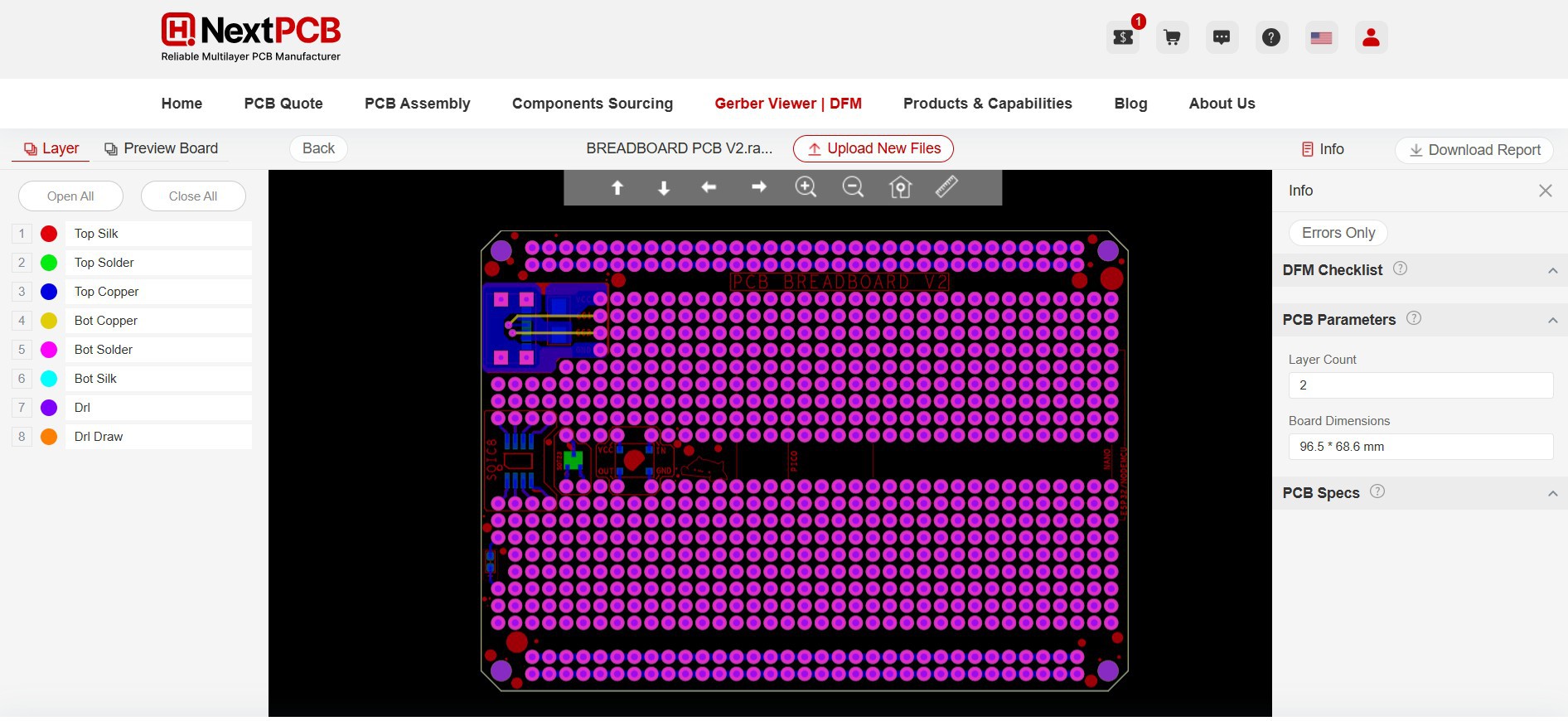

HQDFM: Free Online Gerber Viewer and DFM Analysis Tool
Also, NextPCB has its own Gerber Viewer and DFM analysis software.
Your designs are improved by their HQDFM software (DFM) services. Since I find it annoying to have to wait around for DFM reports from manufacturers, HQDFM is the most efficient method for performing a pre-event self-check.
This is what I see in the online Gerber viewer. It's decent for a quick look but not entirely clear. For full...

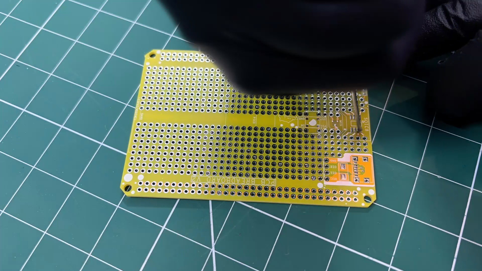

    PCB ASSEMBLY PROCESS

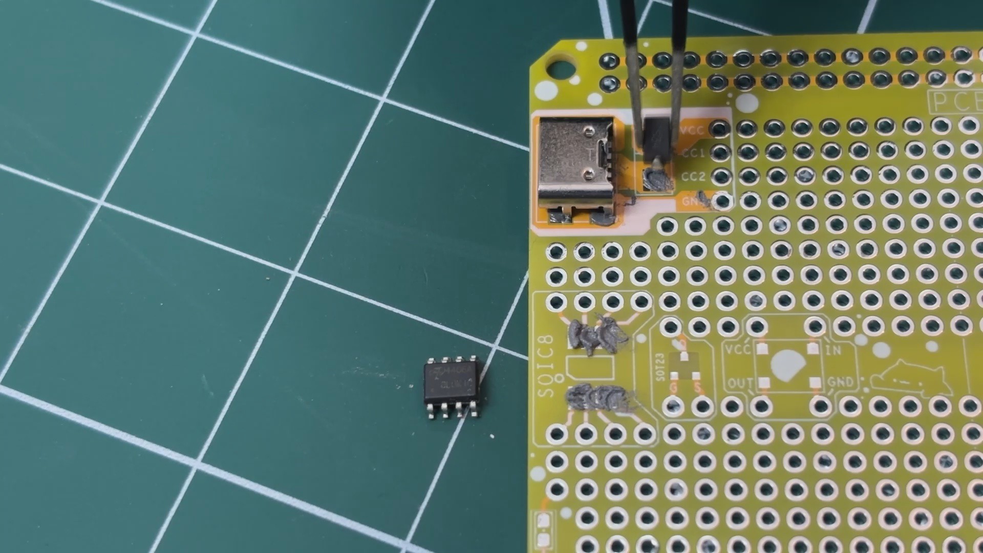

    1. We began the PCB assembly process by applying solder paste to the SOIC-8 footprint and the Type-C connector footprint. For this build, an SnPb 63/37 solder paste was used, which has a melting temperature of approximately 200°C.

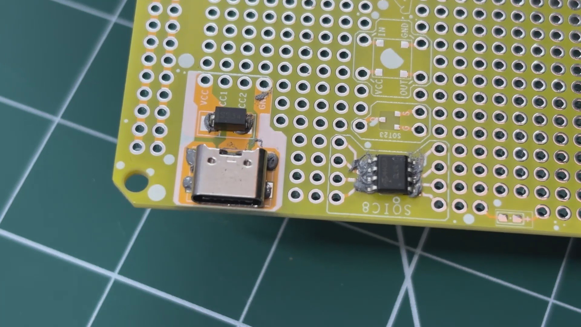

    2. Next, we start the pick-and-place process for the SMD components. The components were placed in the following order: first we added the USB Type-C port, next the M7 diode, and at last the SOIC-8 MOSFET IC.

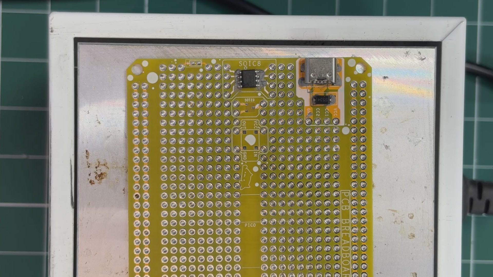

    3. Once all components were correctly positioned, the entire PCB was placed onto a reflow hot plate. The hot plate heats the PCB from below and gradually brings it up to the solder paste’s melting temperature. As soon as the target temperature is reached, the solder paste reflows, allowing the components to self-align and solder firmly into place.
    4. After cooling down, the PCB assembly was complete and ready for the next stage of the build.

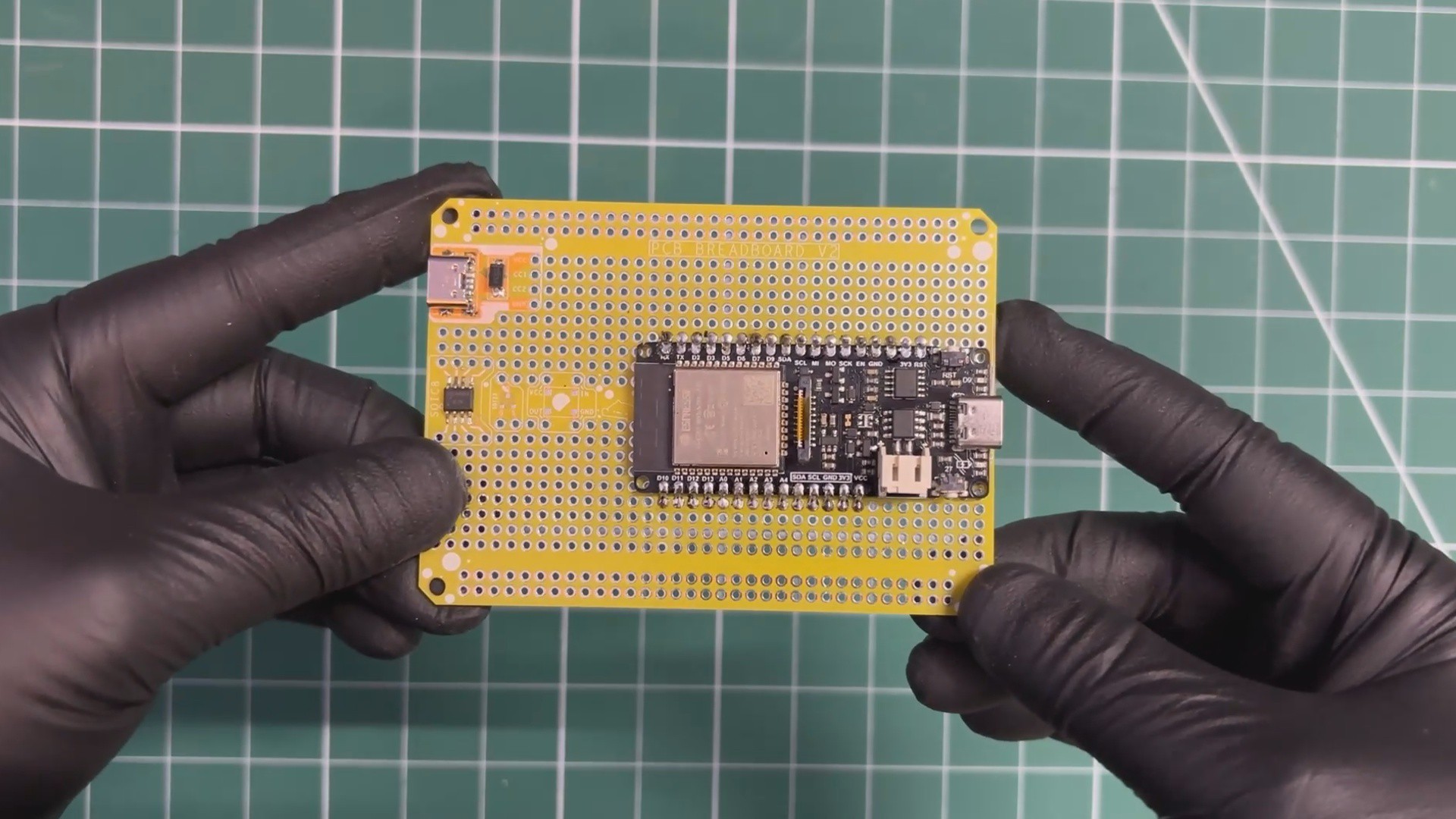

    ELECTRONICS SETUP

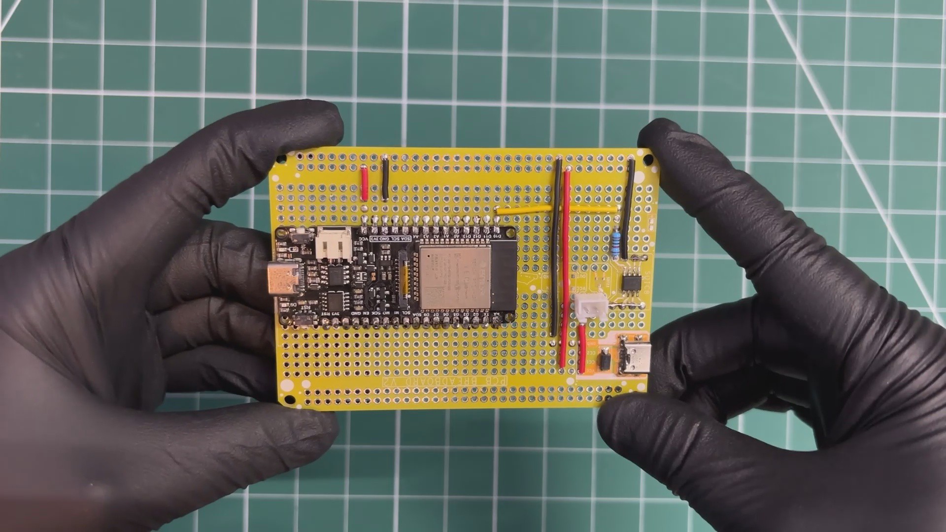

    For the main electronics, we are using a FireBeetle ESP32 board, which was first soldered onto the PCB breadboard. After that, all the connections were made by following the provided wiring diagram.
    1. The gate of the MOSFET IC is connected to GPIO27 of the FireBeetle ESP32 through a 10 kΩ resistor, which acts as a gate resistor to ensure stable switching. The grounds of the ESP32 and the PCB breadboard are connected together, creating a common reference point for the entire circuit.
    2. A DC JST connector is added to the PCB breadboard for the pump connection. The positive terminal of the JST connector is connected to VCC of the PCB breadboard, while the negative terminal is connected to the drain of the MOSFET.
    3. The source of the MOSFET is connected directly to GND, completing the low-side switching configuration.
    4. To power the entire setup, the 5V output from the FireBeetle ESP32 is connected to the VCC rail of the PCB breadboard, which supplies power to the pump and associated circuitry.
    With these connections in place, the circuit is fully assembled and ready for testing.

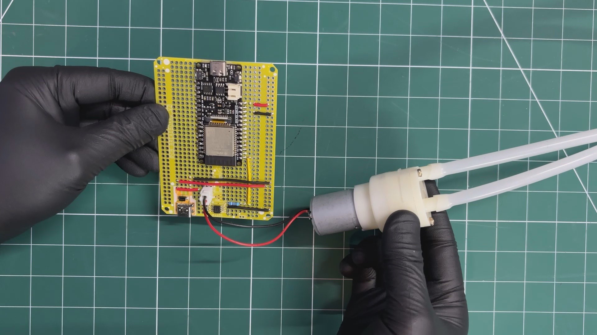

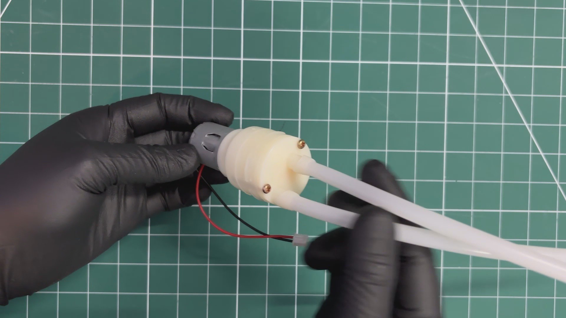

    DC PUMP
    In this build, we are using a vibrating DC pump, which is well suited for transferring liquid from one container to another without relying on siphoning or any external assistance. The pump works by actively drawing liquid from the source container and pushing it into the destination container, making the flow predictable and easy to control.
    Pumps based on this working principle are commonly found in coffee machines. While most commercial coffee machines use AC-operated vibrating pumps, the underlying operating principle remains the same. For our application, we sourced a 5V DC vibrating pump, which makes it ideal for microcontroller-based projects.
    To connect the pump, a JST wire harness is used, which plugs directly into the JST connector on the PCB breadboard. This provides a secure and reliable connection while keeping the setup neat and modular.
    With the wiring complete, the pump is now ready for testing.
