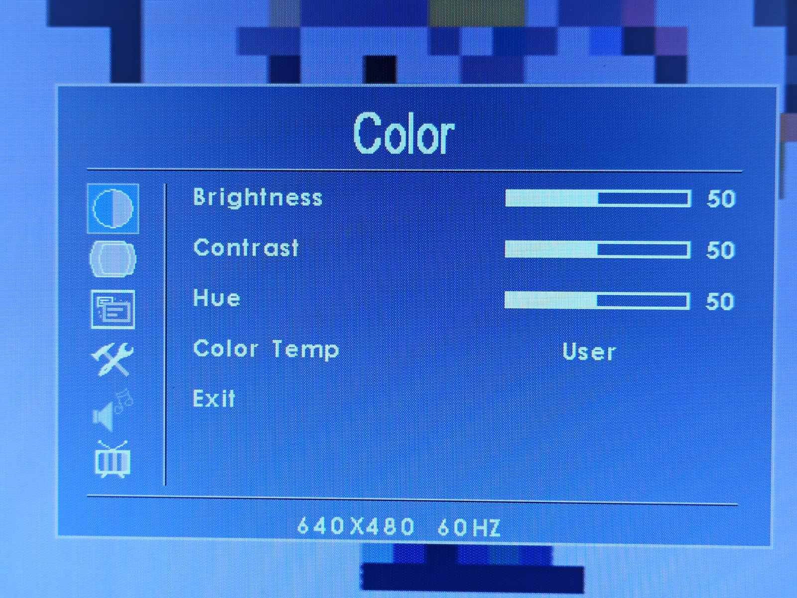

Here are results of my experiments with varying this line duration -- with total lines per frame fixed (525) this will effectively control the frame rate, with shorter line durations leading to faster refresh, and vice versa.
Using Arduino, closest approximation to this line duration can be done in steps of 0.0625 (1/16) of microsecond, as its clock rate is 16MHz. This way, the standard line duration would be 31.75 microseconds (508 clock cycles), and it gives us framerate of 59.993 fps, very close to 60.
With these parameters, the OSD shows the standard VGA:

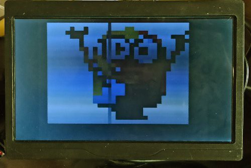

On the other side, there is also a tolerance to bigger horisontal synchronization pulse widths. There is one side-effect visible - during blanking interval which is triggered by sync pulse end, there is dark calibration on part of the line performed. And when pulse width becomes so long that it ends during active image area, the line is sampled at non-zero values, which throws colors off. Otherwise the image itself is stable.
The vertical grey line in the middle of image is probably that dark level sampling area.
When further increasing Hsync pulse length, the lock flips the same way as it was with Vsync -- when LOW pulse becomes longer than HIGH, then the latter starts being used as the synchronization signal, and image now tears apart.
Even further increase of LOW hsync signal duration makes image move left, and when the HIGH part becomes similar in length as standard LOW pulse, the image becomes centered again. This way, the signal polarity is completely flipped, without any consequences on locking onto line.
One fun thing that might be done, is make Hsync and Vsync pulses slightly bigger that half of line / frame respectively -- this way image tears both horisontally and vertically:

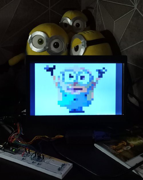

I slightly updated the circuit, adding 3 simple 2-bit resistor ladder DACs, so that now I can output images in 64 colors (RGB 222).
The images are measly 36(or less) by 25 pixels, so are quite blocky. They are taking 900 bytes, thus I can hold only one in 1kB memory of atmega168 chip.
Blockiness is also comes from the fact, that each pixel takes some time to output; in my implementation the for loop is used to retrieve each pixel value from array, and each loop takes 11 cpu cycles, so at 16 MHz, I can output a pixel every 688 nanoseconds, thus effective pixel clock is at 1.4545 MHz, far less than 25.175MHz for standard VGA 640*480@60Hz.
Next is a couple of examples of images produced:
An airport radar tower
NNot
A picture of a Minion:

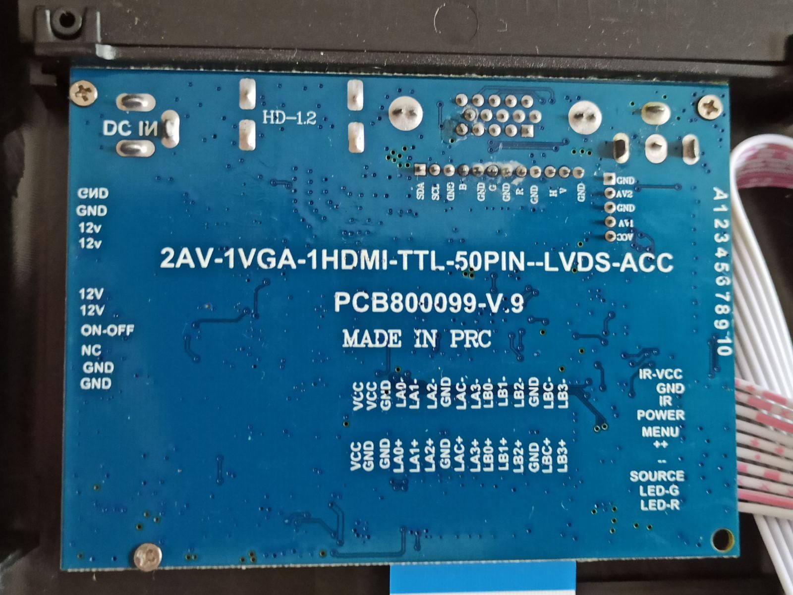

Some 3 years ago I've bought a small 10-inch monitor on AliExpress for using in projects involving generating VGA signals. At the time I checked that it works, but haven't done the experiments I intended it for, until just recently; it was lying around in my electronic junk box.

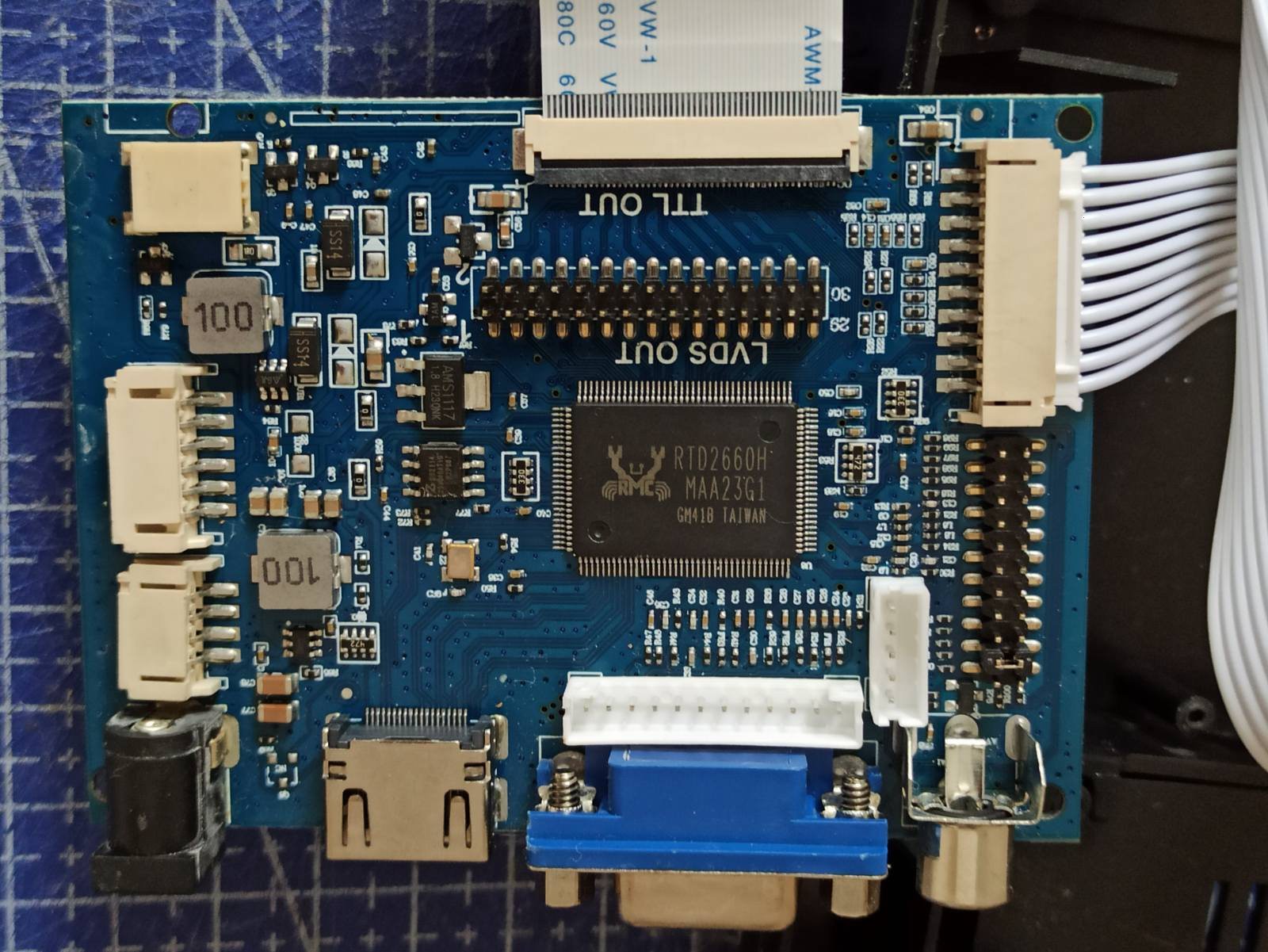

Now, I've retrieved it, and took a look inside, hoping to find out what chip is driving it, and through searching in its datasheet to find which resolutions and framerates it can recognize from VGA input. The chip was found to be RTD2660H, its datasheet proved quite dense, and I couldn't figure out where in it the info I needed could be found. So, now I am resorting to find out experimentally, what it can take for recognizable input, starting with standard timings that it sure should recognize. I'll write what I found in the future log entry.
Now, here will be just photos of this monitor:
Front
Back
Inside
LCD panel number up close:
Controller board:
It looks like this one is similar to small monitors for Raspberry Pi sold by Adafruit; at least the controller board has the same chip, and looks very similar. Example with seemingly the same LCD panel.
