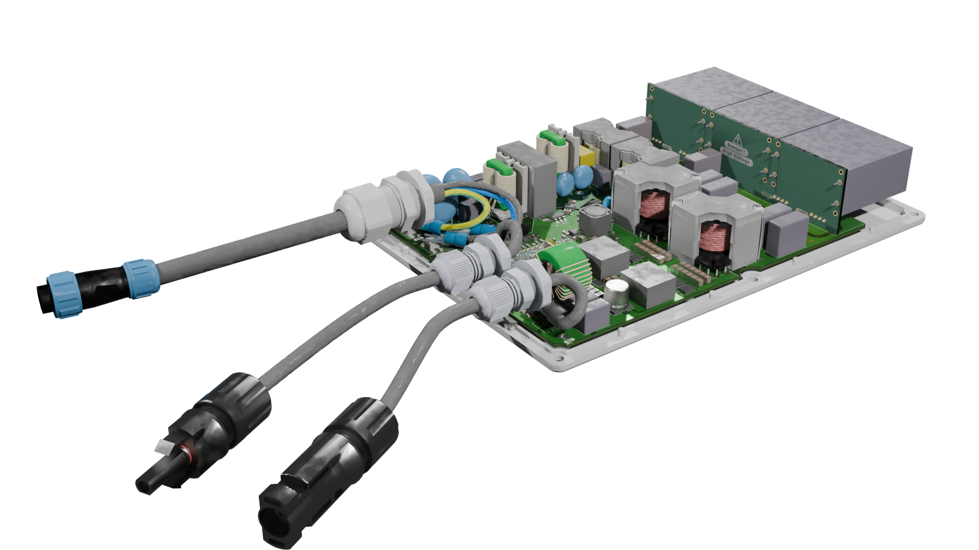

An open-source - community built micro-inverter
Manifesto
The project goal are :
- Having the first open source PV micro-inverter
- Finally a design easy to repair that is no longer a black box
- Redeem your data sovereignty, you will no longer depend on a proprietary cloud to follow your solar production and consumption.
Open, for everyone, forever
- This project is propulsed by its community.
- The collective work generated is meant to remain open.
- Design files are made with open source software - Namely kiCAD.
- Mechanical interfaces and components are modeled using FreeCAD.
- Simulation files use ngSpice.
In that sense, the owntech foundation aims at protecting this technical common.
