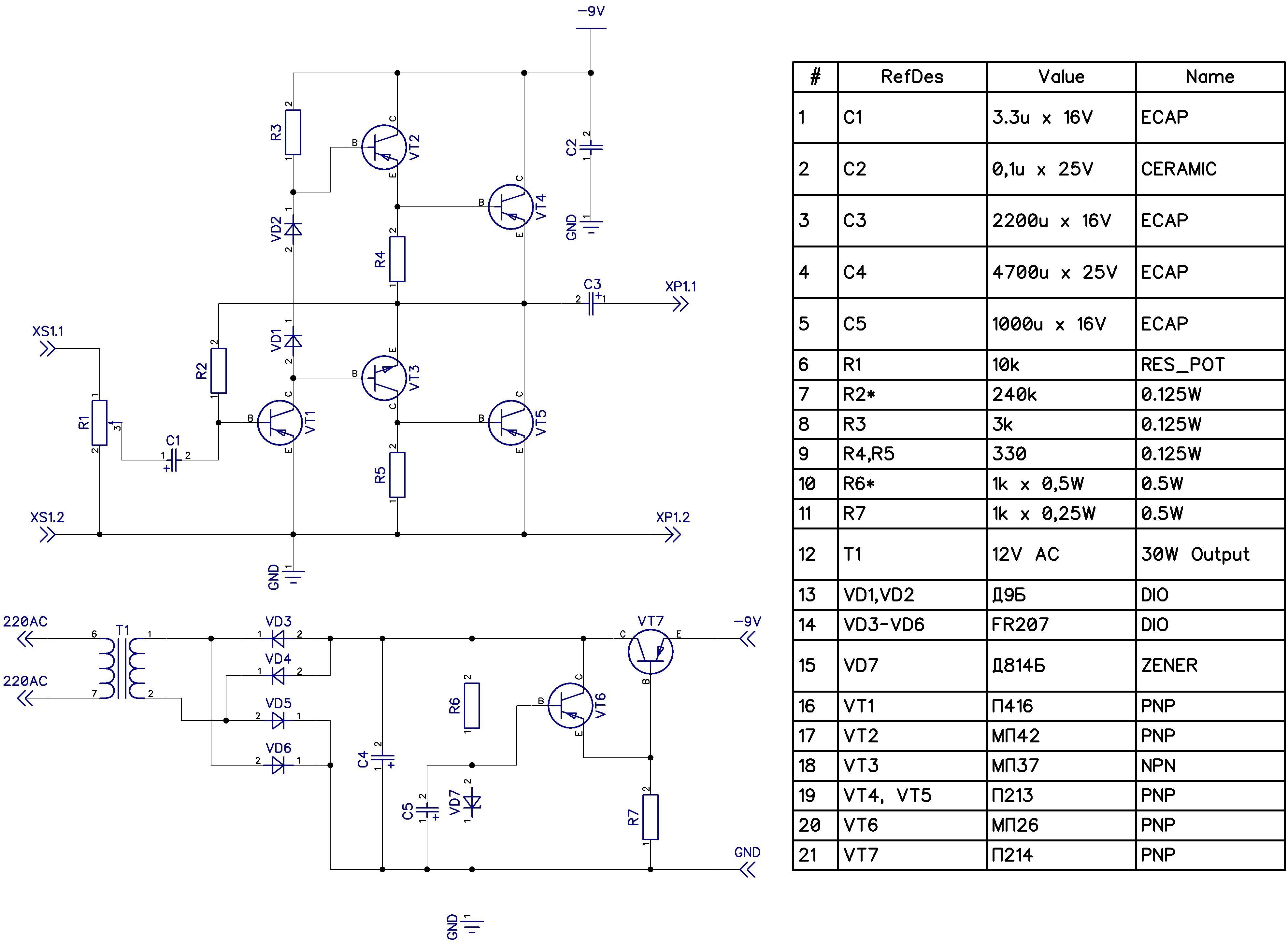

A custom-built Class AB headphone amplifier powered by vintage Soviet germanium transistors (P213B), housed in a "sandwich-based" acrylic chassis. This project revisits a classic schematic from V.G. Borisov's 'Young Radio Amateur' book from 1960 to the end of 1970.
For many electronics enthusiasts who grew up in the post-Soviet space, V.G. Borisov’s book "Young Radio Amateur" is practically a sacred text. It’s where many soldered their first joints. I remember getting stuck on this circuit when I was 12. After a failed attempt to build a specific transistor amplifier from that book back then, I decided in 2016 that it was time to settle the score.
The result is a Class AB headphone amplifier built strictly on vintage Soviet germanium transistors. The circuit relies on MP37 and MP39 (МП37 / МП39) transistors for the driver stages, with hefty P213B (П213Б) transistors handling the output. Since original parts are getting scarce, I had to dig through donor boards to salvage the necessary germanium components.
It wasn't a plug-and-play affair. The initial build suffered from the dreaded "metallic" sound of crossover distortion. To fix this, the quiescent current was bumped from 10mA up to 50mA by tweaking the bias circuit with an additional diode, smoothing out the sine wave. I verified the result using an oscilloscope.
The stabilized power supply was also assembled based on an old 60's circuit using two germanium transistors. Unfortunately, I could not find germanium diodes or Zener diodes, so I used modern equivalents.

    There is only one channel in the diagram.
    The second channel is similar.

Ken Yap wrote 02/04/2026 at 23:57 point
Funky transistor metal cases. 😀 Would the power stage need heatsinks for sustained high output or have you not driven them that hard?
Osman Mazinov wrote 02/05/2026 at 09:53 point
I used this amplifier with headphones with an impedance of 16 ohms. Of course, if you connect speakers with an impedance of 4 ohms, heat sinks will be necessary!
