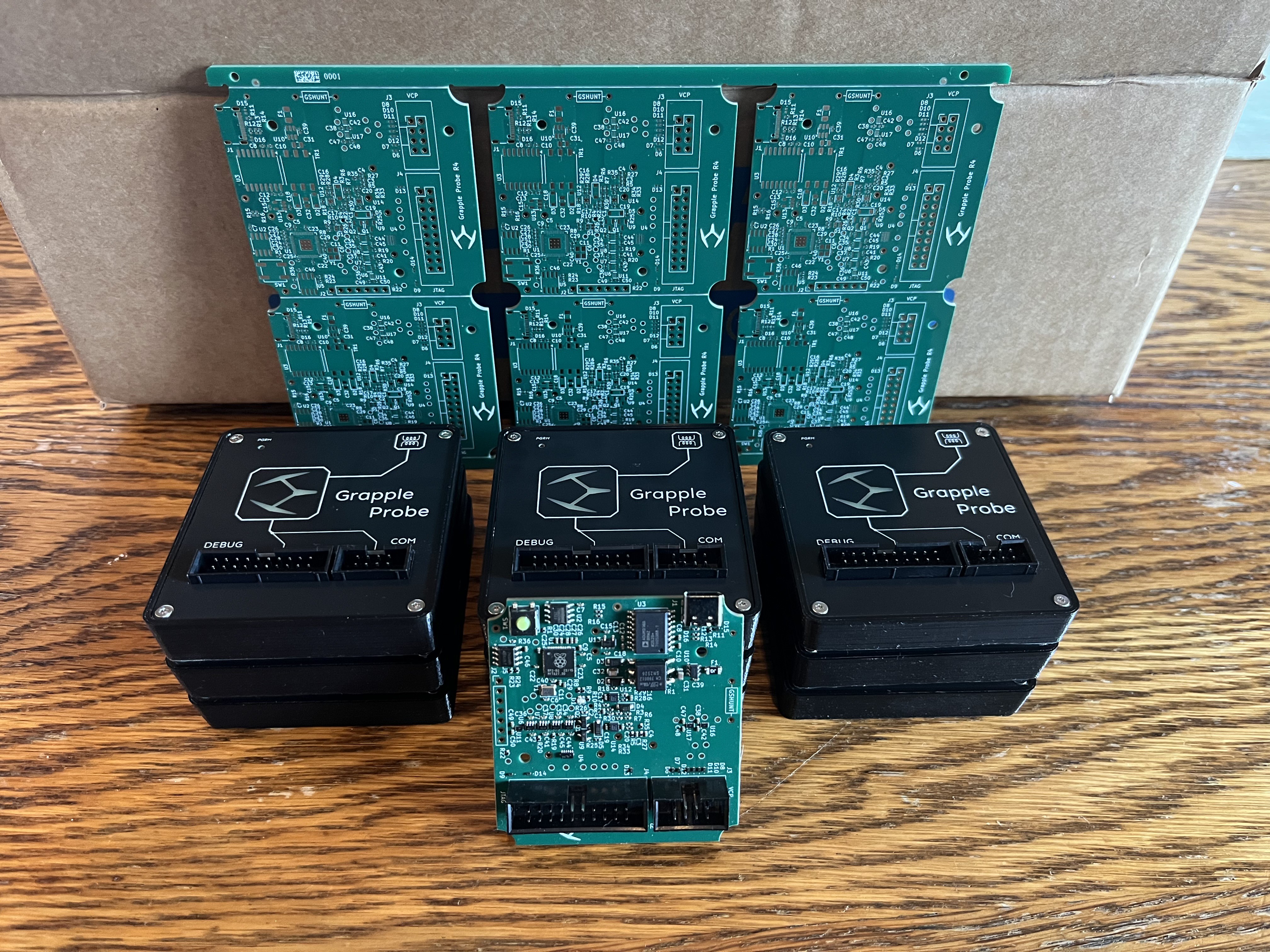

    We're to the point where we're ready to send some first version Grapple Probes out to some lucky recipients.  We now have some documentation on our website! https://grapple.systems/docs/grapple-probe. And I made some boxes to put them in with a QR code that links to the documentation.
    9 Grapple Probes ready to give to a few alpha testers.
