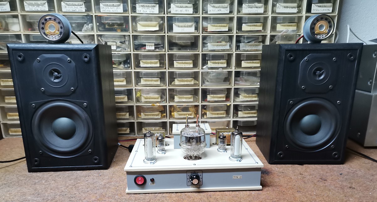

In addition, the cost of such an amplifier would be really low, and also during its construction you will learn a lot about electronic devices which use vacuum tubes. The amplifier that I present to you is a modified version of a FU32 tube amplifier kit, which was available a few years ago, but unfortunately is no longer for sale
  First, let me describe the components used individually. The most specific component of these amplifiers is the mains transformer together with the rectifier. This time I use this cheap DC-DC converter that uses 12V input voltage and the output voltage can be adjusted from 40 to 700V.
   For the needs of this amplifier, the output voltage is set to 235V
   I will use the input voltage also for heating the Tubes.
   For this purpose, the three series groups of tubes are connected in parallel to 12V as shown in the picture.
  In this way, the whole power supply part is solved very elegantly and simply. Instead of FU32 I use GU32 Tube which is 100% compatible.
 Input tubes are 6Ј1, one for each channel. For a better visual impression, I also installed a retro VU meter with EM84 tubes, and I described its making in one of my previous videos

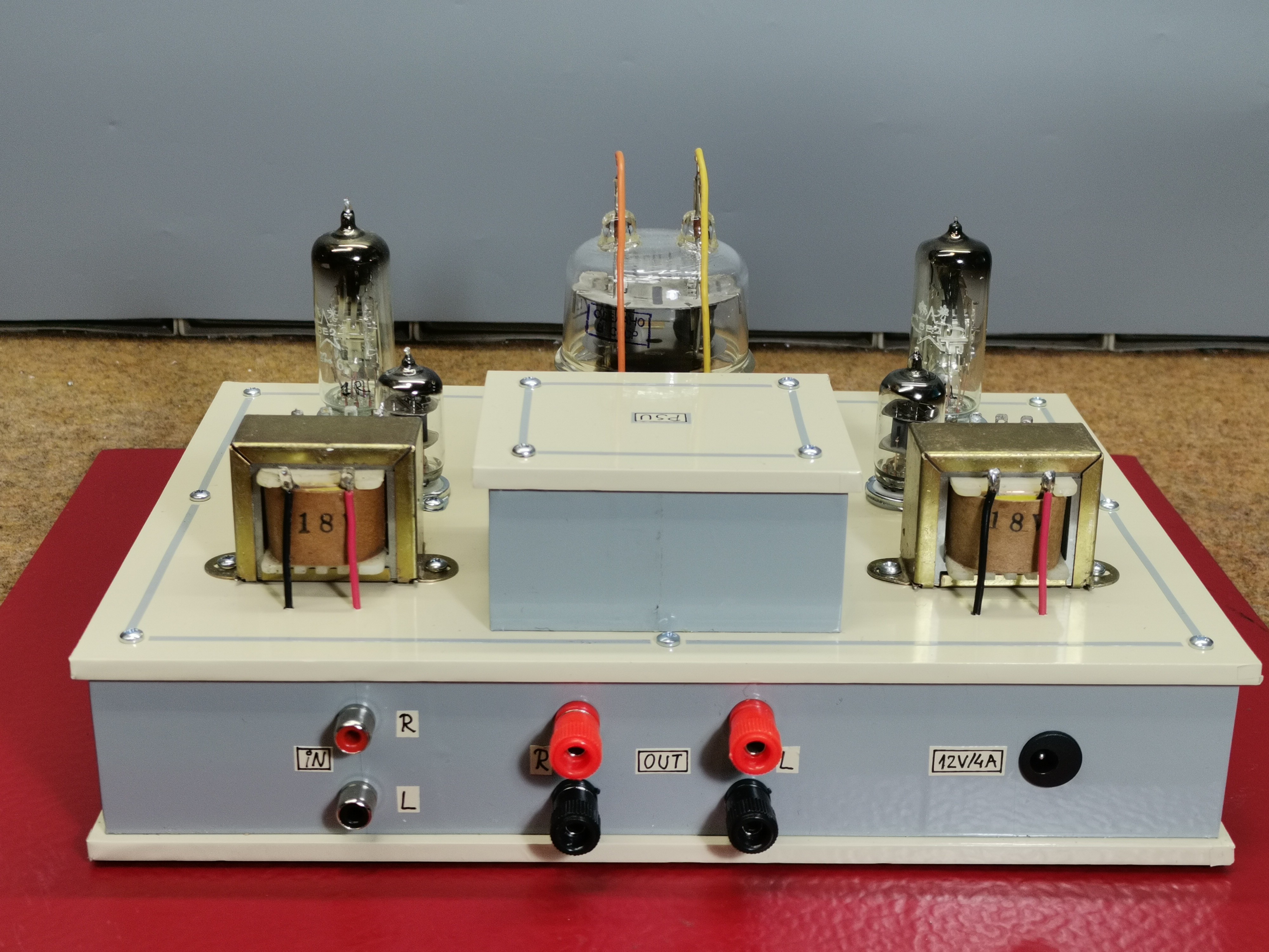

  Now let's take a look at what's inside the box.  In this small box is the power supply module that provides voltage for all parts of the device. Here is how the connection of the components looks like.
  In order to interconnect the components, I used segments of self-adhesive copper tape which really made it much easier for me to make. All connections are made with thin wire keeping in mind that very small currents flow through them. Only the heating lines and speakers connections are made with a thicker wire.
   It can be said that the most important part of these amplifiers is the output audio transformer. These transformers are made with a special way of winding, and the quality of the resulting sound, especially at low frequencies, largely depends on them. For simpler rough initial testing and modifications to the amp, I made the amplifier with ordinary mains transformers.
Otherwise, it would be better to use wide-range sensitive speakers with a larger cross-section membrane specially designed for use with low-wattage tube amplifiers. After turning on the amplifier, it takes some time for the cathodes of the tubes to heat up. I use my PC as the audio signal source, and for copyright reasons I will use songs from the free YouTube audio library. Unfortunately, the sound you will hear on the video will not correspond to the sound I hear live, so you will either have to make the amplifier yourself, or trust my subjective claims. I think the first option is far preferable. It is interesting fact that the amplifier does not make any noise or hum at maximum power, without an input signal. I added a 100 microfarad 400V filter capacitor to the output of the power supply module, but the situation was the same without it.
   As for the output power, although it is declared on the source schematic as 3.5 W per channel, according to my rough measurements it does not exceed 2 to 2.5 W with acceptable distortions for this type of amplifier of less than 3%. At more than 3W output power, the distortions were greater than 10%. However, even this relatively low output power is sufficient for normal listening in smaller rooms, especially if we use sensitive speakers.
   And finally a short conclusion. The idea of this project is to present to you perhaps the simplest way to make a relatively powerful stereo Vacuum Tube audio amplifier with components that are easily available for purchase, and also the cost of the whole assembly is significantly low. However, the quality of the resulting sound is excellent, at least in my personal subjective opinion, and to make sure of that, you will have to make it yourself and hear it. Just to mention that the total cost of this amplifier does not exceed 25 dollars without output audio transformers.
The total consumption of the complete device at maximum load is about 40 Watts, so it is desirable that the 12V power supply is intended for currents of 5A or more. I installed the device in a box made of PVC material, but it is preferable to install it in a wooden or metal box in a retro style.
