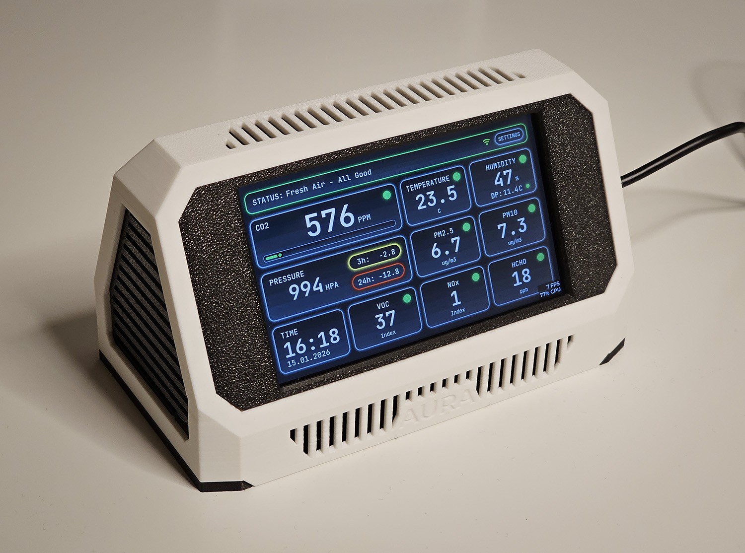

Waveshare ESP32-S3-Touch-LCD-4.3 — An all-in-one board featuring:
  • Dual-core ESP32-S3 processor
  • 16MB Flash memory
  • Gorgeous 4.3" IPS capacitive touchscreen (800×480)
  • The visual quality difference from cheap displays is like comparing an old TV to a modern tablet

Sensirion SEN66 (Switzerland) — The heart of the system. This single module replaces an entire laboratory:
  • PM1, PM2.5, PM4, PM10 (full particulate spectrum)
  • CO₂, VOC, NOx (air freshness and chemical pollution)
  • Temperature & Humidity
Sensirion SFA30 (optional) — Direct formaldehyde measurement. If you've done renovations or bought new furniture, this sensor reveals the invisible danger.
Adafruit Pressure Sensors — Support for DPS310, BMP580, or BMP581. The device auto-detects which sensor is installed and starts plotting pressure trends.

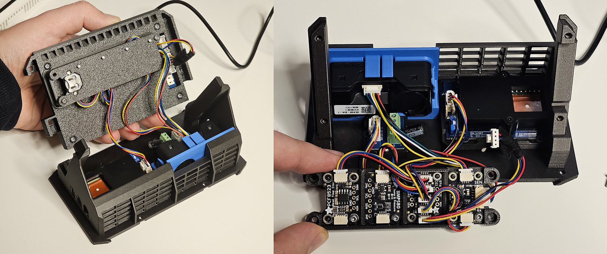

    1. No soldering required — This needed to be accessible to anyone, not just electronics experts
    2. Industrial-grade sensors — No cheap DHT11/MQ-135 clones. Real Sensirion sensors or nothing.
    3. Professional UX — No "Arduino project" aesthetic. It needed to look and feel like a commercial product.

    I went through three major iterations:
    Version 1: ESP32 DevKit + 2.8" resistive touchscreen + breadboard mess. It worked, but looked terrible. Cable management was a nightmare.
    Version 2: Custom PCB + 3.5" capacitive display. Better, but still felt like a prototype. Manufacturing costs would've been too high for a DIY project.
    Version 3 (Current): Waveshare ESP32-S3-Touch-LCD-4.3 + Grove/STEMMA QT ecosystem. This was the breakthrough. The integrated display eliminated cable spaghetti, and standardized connectors made assembly trivial.
