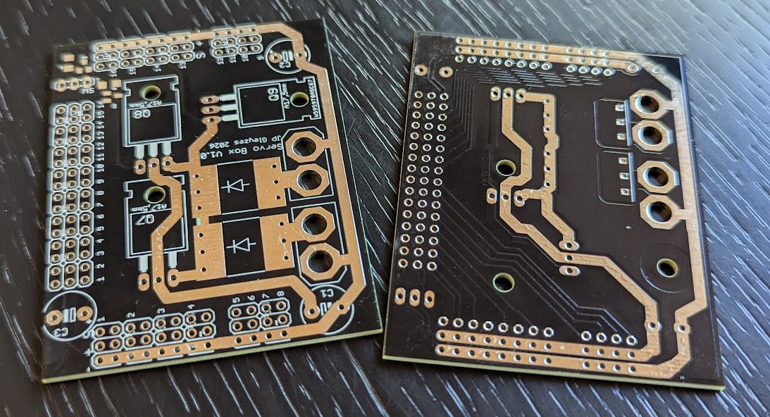

PCB
The PCB can be bought at PCBWay
The PCB was kindly sponsored by PCBWay and is as usual of excellent quality.
You can order it here :PCBWay shared project. It's cheap, delivered very fast and so professional looking!
and if you are new to PCBWay please use this affiliated link : https://pcbway.com/g/o35z4O
As you can see "big" tracks are exposed to be reinforced either with solder or (better) with copper wire. Doing this will increase drastically the current capcabilities of this board. It will sustain up to 20A with a total of 16 servos powered with 2s lipo packs.
