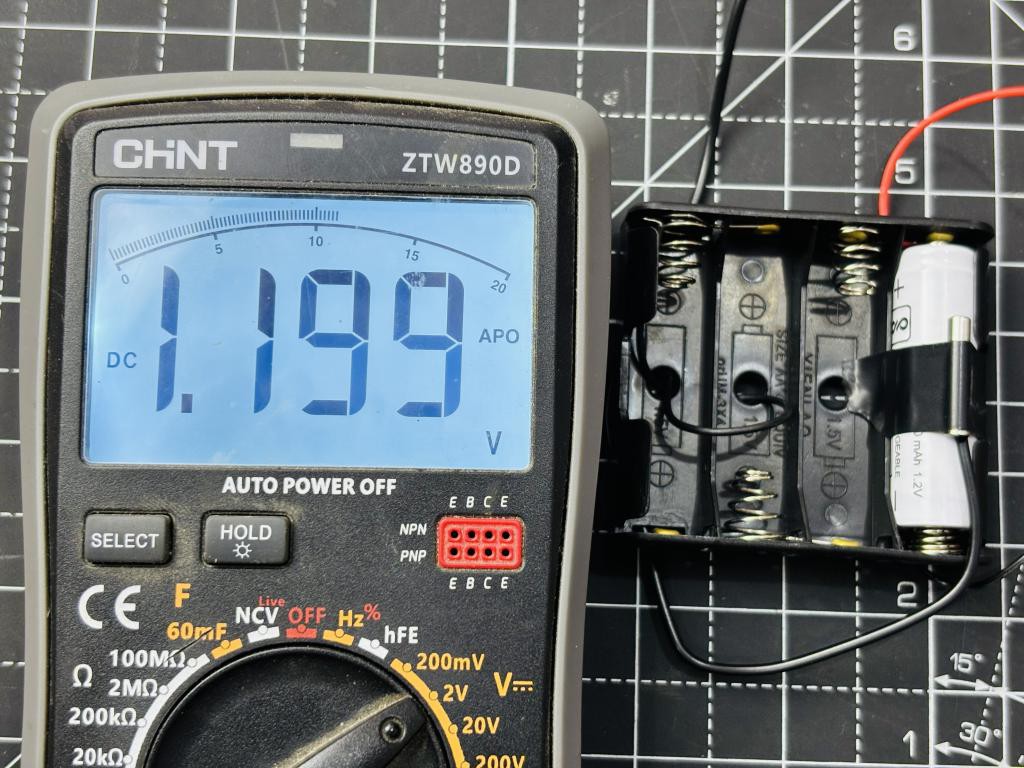

I have covered some battery chargers in past articles. Here is my new article on the topic of how to exactly charge NiMh or NiCd batteries without any protection circuitry. I will let you know the exact profile and charging mechanism in the CC/CV mode because the charging mechanism is a bit different. here is the picture of discharged one with setup:

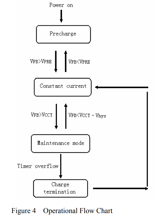

- Precharge(Conditioning): If battery voltage is <1V, a low current trickle charge is applied. In this case, only 1/10th of the constant current is applied to the battery for safety purposes. So that battery can be pulled back to the state of charge.
- Constant Current (CC) Mode: When battery voltage rises above 1.2V, the programmed charge current is applied. Constant current mode is simply a current limiter; we limit the maximum charging current to the IC. It will be discussed further in more detail.
- Maintenance (CV) Mode: As the battery approaches 1.65V, the charging current tapers off. This is basically filling the battery from 90% to 100%. This is important for good battery health, but we can also plug out the battery after CC mode is done.

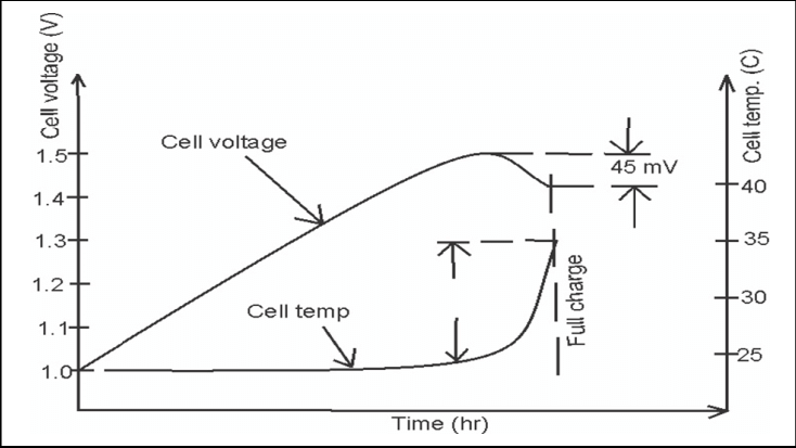

How to Determine a Full Charge:
1. (ΔT/dt) Temperature Termination:
During charging, NiMH and NiCd batteries convert excess energy into heat once they approach full charge. This causes a rapid rise in temperature. In rate-of-temperature-rise termination, the charger continuously...
