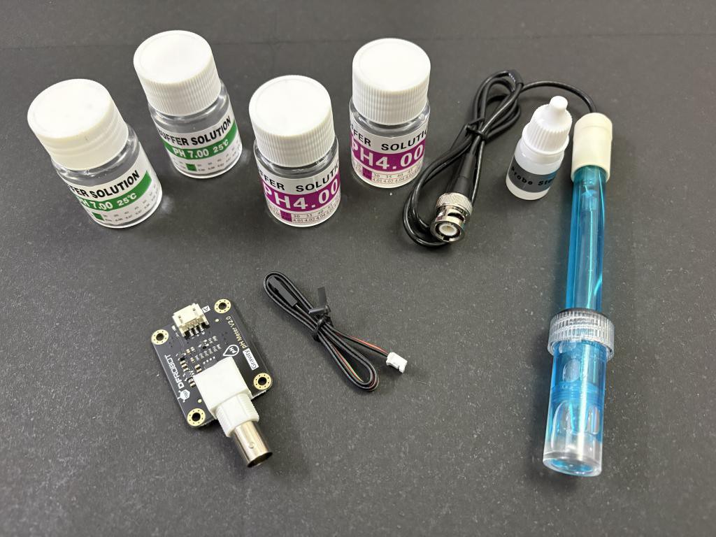

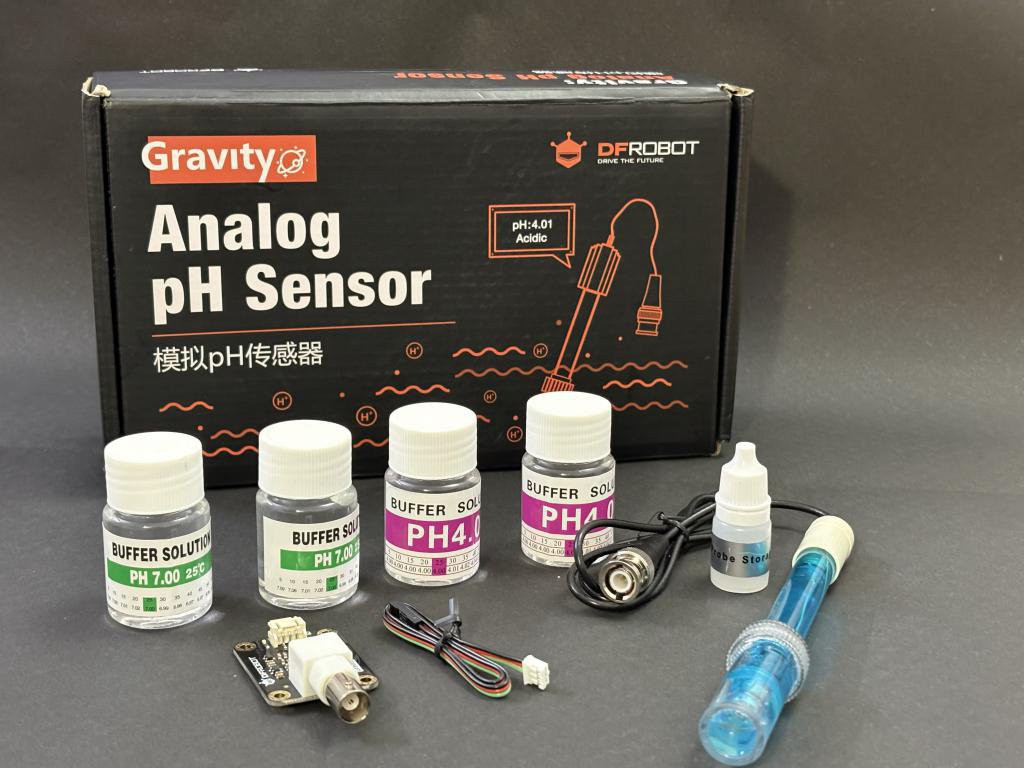

The kit arrived well-packaged with everything you need to get started:
What's in the Box:
  • pH Probe (Laboratory Grade) with 1-meter cable
  • pH Signal Conversion Board V2
  • Gravity Analog Sensor Cable (3-pin)
  • pH Standard Buffer Solution 4.0 (2 bottles)
  • pH Standard Buffer Solution 7.0 (2 bottles)
  • Waterproof Gasket (2 pieces)
  • Screw Cap for BNC Connector
  • M3 nylon standoffs and screws for mounting

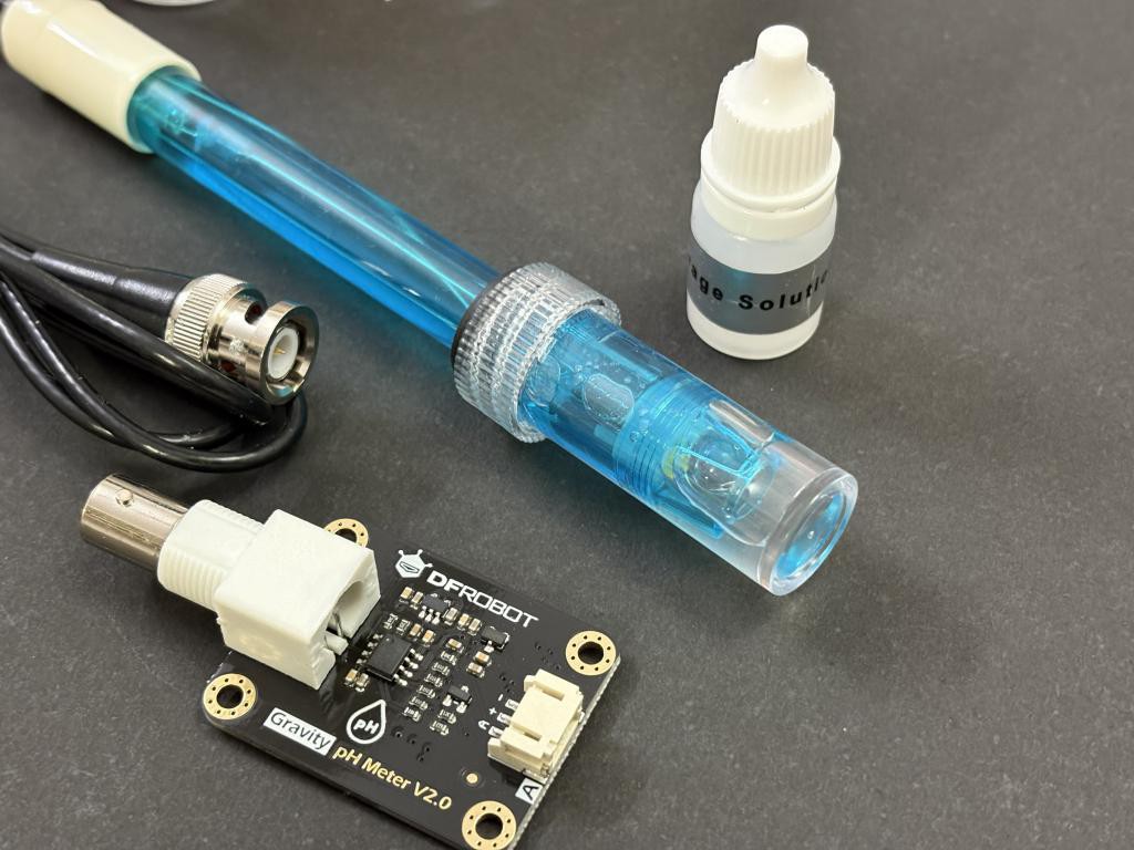

How Does It Work?
The heart of this kit is the laboratory-grade pH probe. Unlike the cheap pH sensors you might find online, this one uses a proper glass electrode.
The capabilities are given here:
  • Detection Range: 0-14 pH
  • Temperature Range: 5-60°C
  • Response Time: Less than 2 minutes
  • Internal Resistance: Less than 250MΩ
  • Zero Point: 7±0.5
The glass electrode works on the principle of ion-selective membrane potential. The glass membrane is sensitive to hydrogen ions (H+), and generates a voltage proportional to the pH of the solution it's immersed in. This voltage is typically in the millivolt range and has extremely high impedance. The raw output from a pH probe is low low-voltage (millivolts) signal, which requires buffering and amplification. The signal conversion board handles all of this:
Specifications:
  • Supply Voltage: 3.3-5.5V
  • Output Voltage: 0-3.0V (analog)
  • Measurement Accuracy: ±0.1 @ 25°C
  • Connector: BNC for probe, PH2.0-3P for output
From an electronics perspective, the board likely uses a high-input-impedance op-amp buffer (probably a FET-input op-amp given the impedance requirements) followed by signal conditioning circuitry.

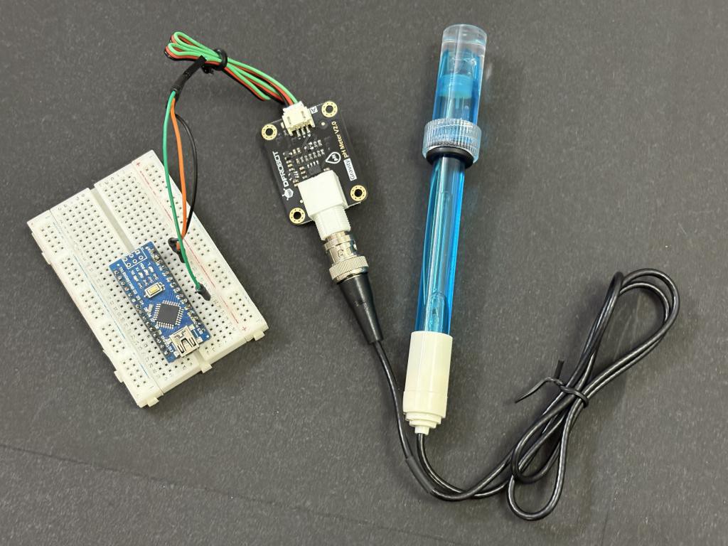

Setting Up the Hardware
The hardware setup is straightforward; connect the pH probe to the BNC connector on the signal conversion board. Wire the signal board to your Arduino:
  • VCC (Red) → 5V
  • GND (Black) → GND
  • Signal (Blue) → A1 (or any analog pin)
I'm using Arduino Nano/UNO for this project because it's compact and has enough analog inputs for future multi-sensor projects I'm planning.
