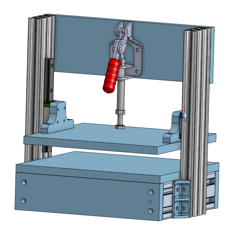

    The Test Fixture
    I also designed and built a simple test fixture with some spare parts I have from an ongoing CNC build. The goal was to get an idea what the end-to-end test procedure would feel like. Overall, I'm pretty happy with the outcome and would only change a few things.
    1. Use ESD safe materials
    2. Switch to standard 2020 aluminum extrusion since that's easier to find
    3. Include a place, maybe underneath, to store the DUT Hub and other test electronics
