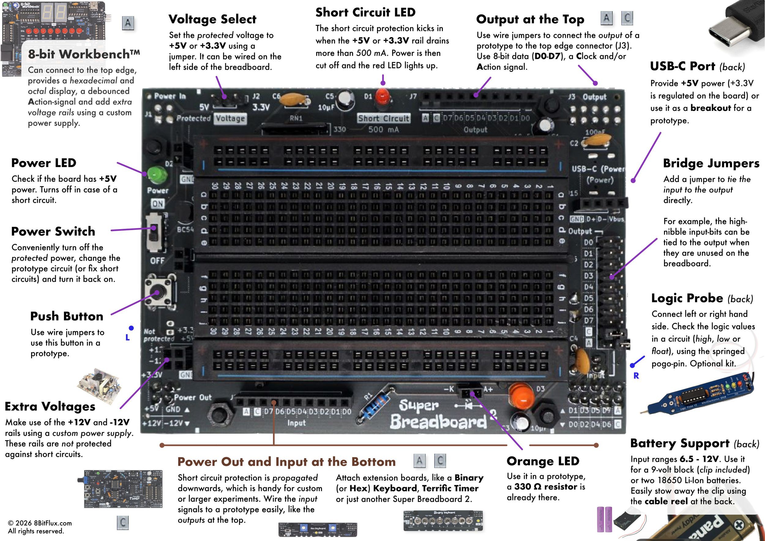

Super Breadboard 2: a breadboard on steroids
Enjoy short circuit protection for both +3.3V and +5V. Power it using USB-C or with a 9-volt battery. Now has Logic Probe support.
A prototyping board based on a standard 400 pin breadboard. Has multiple voltage rails (+5, +12 and -12V), 8-bit data input and output connectors, a Clock and Action line. It has 3.3V regulation on the board itself, based on the 5V input. The 5V and 3.3V lines are protected against short circuits, power is then cut off and this is indicated by a red LED. Some other handy goodies are around the breadboard, including a USB-C port that can act as a breakout for a prototype, or it can supply 5V power (3.3V is derived) by using a power bank. A push button and LED (with resistor) are ready for use. All signals of the extension interface can be bridged using jumpers. For example: the four high-nibble input-bits can be tied to the output when they are not used on the breadboard.

  • Overview of Features
