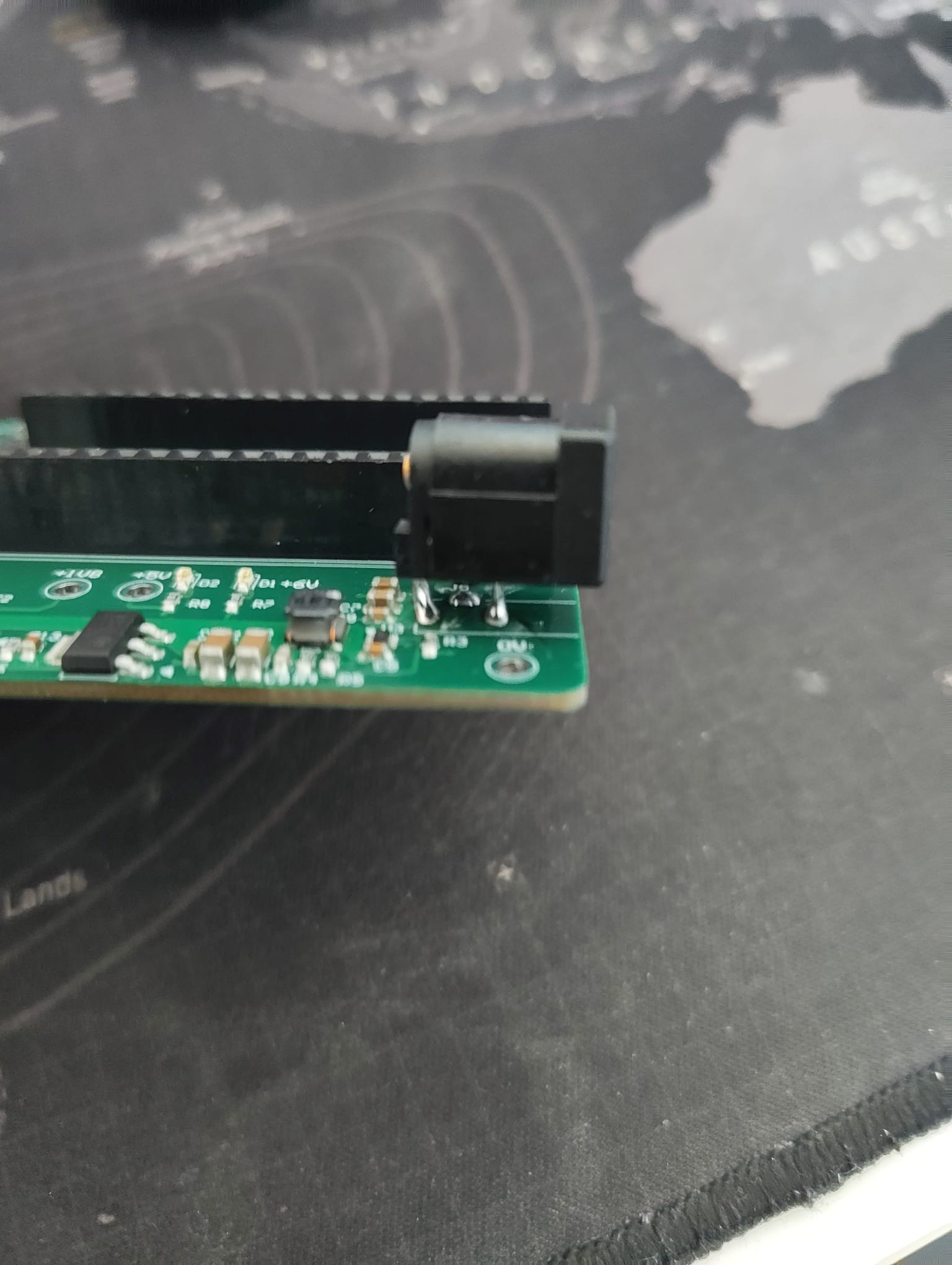

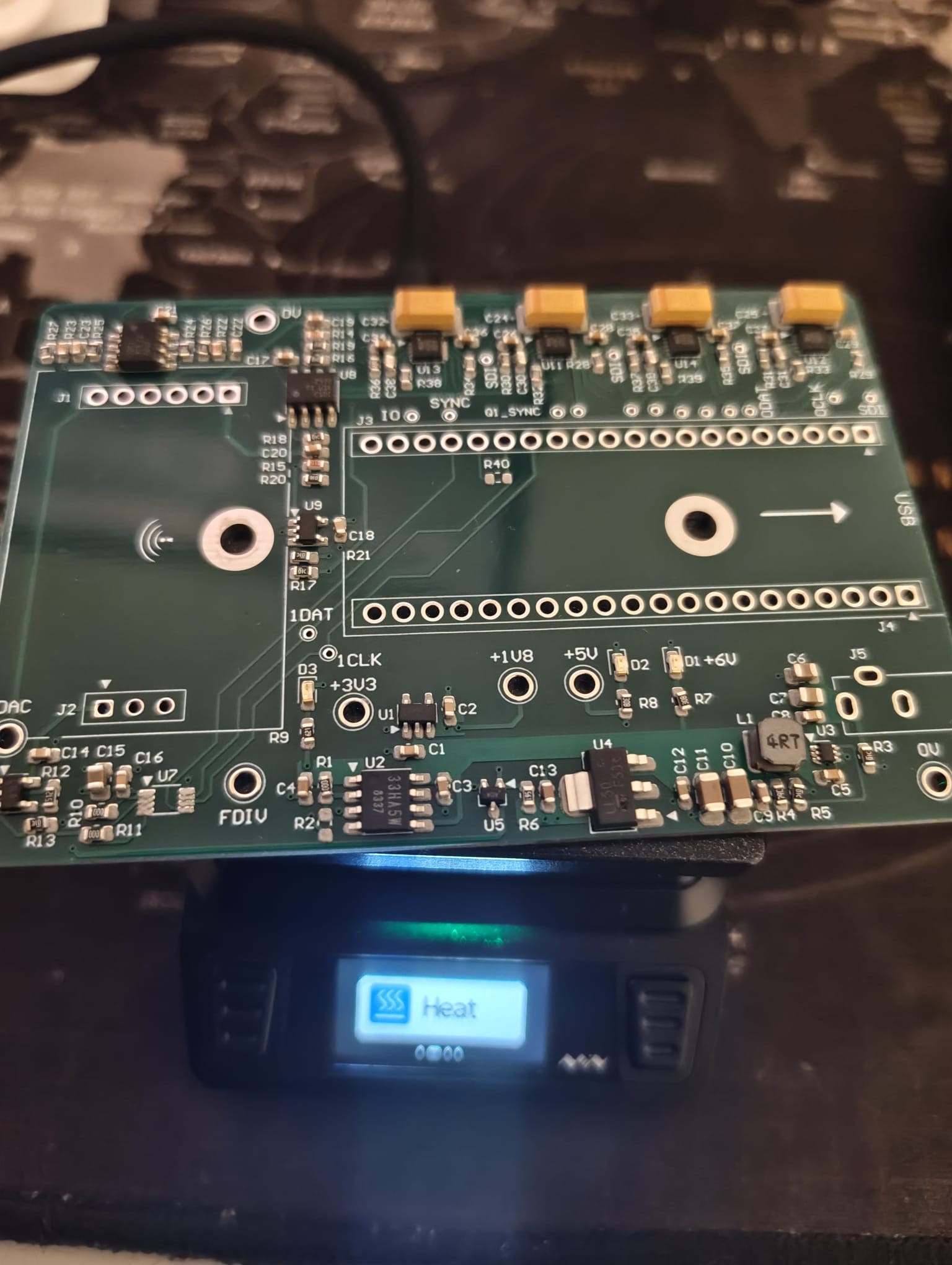

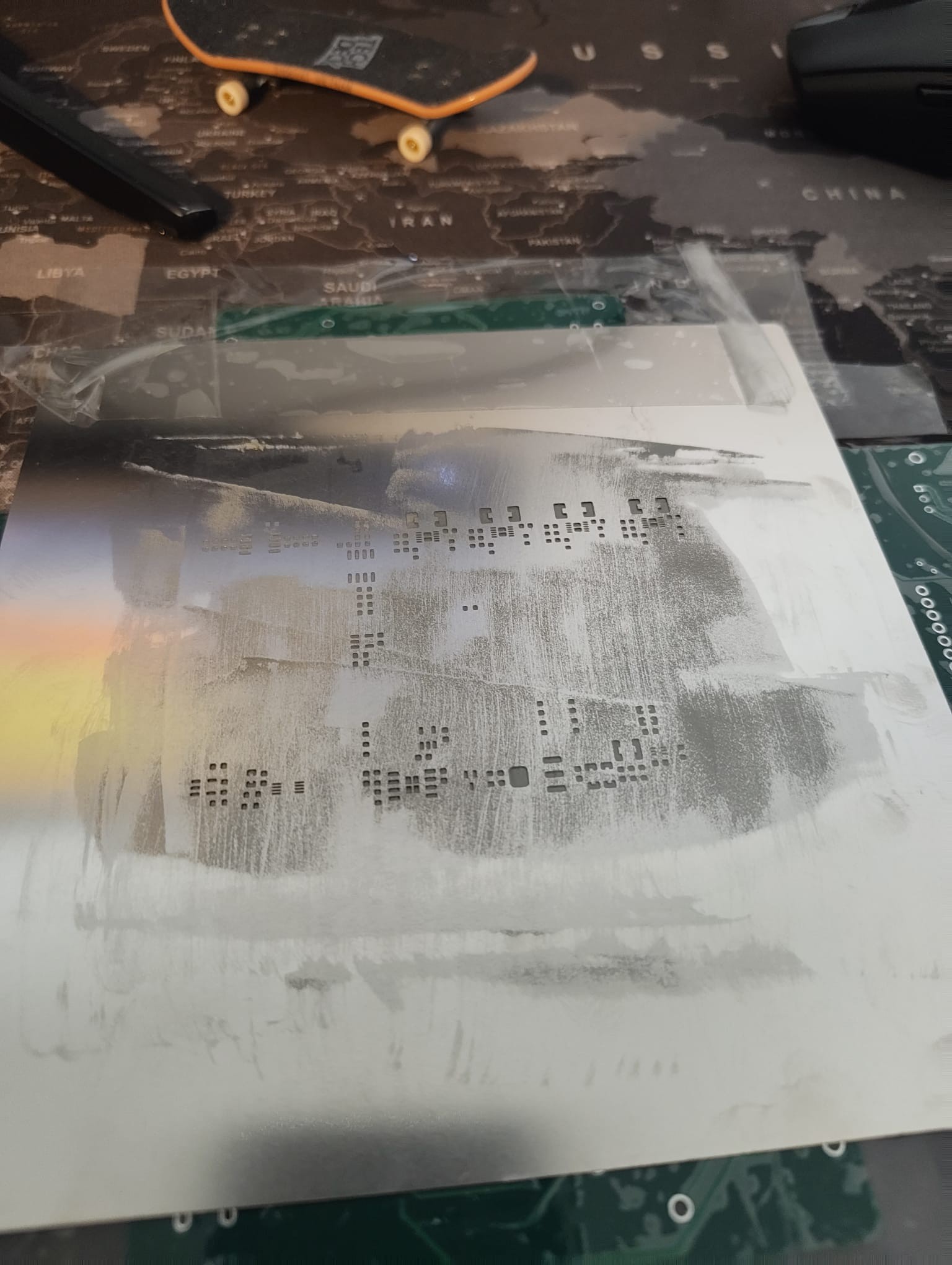

    I had all the components with me and it was time to start placing them down.
    I very rarely get boards made externally infact it was probably a few years ago I had got one made externally, the reason being is predominately cost, but as well I have not done anything too complex in terms of placement and to be honest, I quite enjoy the manual labor.
    I had only ordered five boards and decided to do my usual thing of making my DIY stencil jig.
    The thermal paste used was nothing too extravagant. I just use whatever is able to be kept at room temperature. I had found out even past expiry it was still good to use! I suppose the flux had not dried out of it. Using any old card as a squeegee you want a nice even layer across the stencil, it is key you have this secured down and not move it whilst applying the paste, you get this awful squiggy looking texture and uneveness, it will usually result in a bit more rework.
    Thus it was time to start placing down 127 components..
    After 1 hour and 45 minutes roughly, quite poor timing I think from myself, It was time to solder!

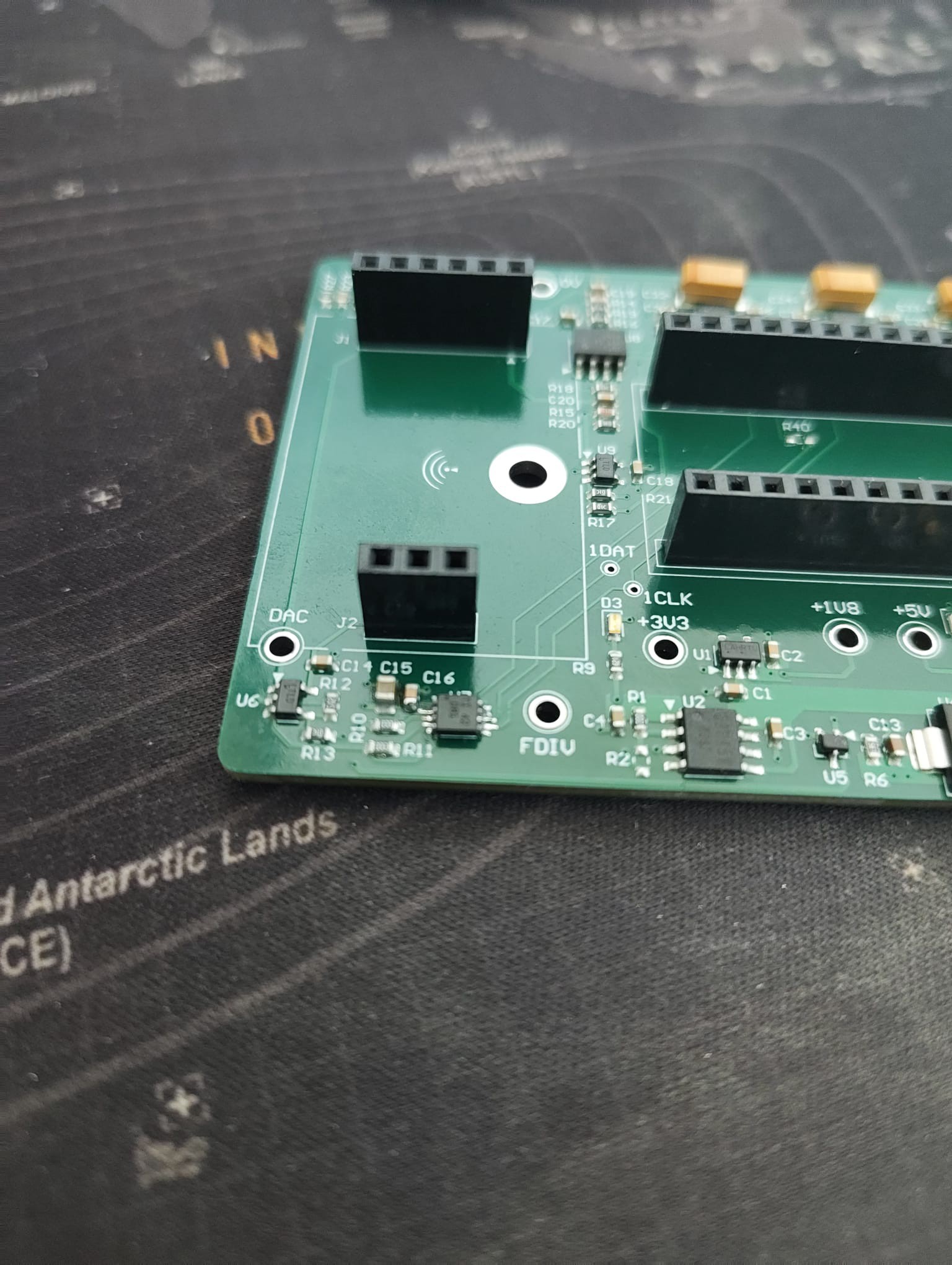

    As you can see I am missing U7 and this was because I had messed up on the footprint of it, this led to quite a bit of headache for the rework. A wise man once said that a good design is characterised by a good library. I should have really checked it!
    Besides that, the hotplate was also throwing error of it unable to detect the hot plate, whilst having a rattling sound which is never good. Instead of trying to fix it, I had decided to use the hot air gun.
    After another 10 - 20 min of hot air and a cup of tea the board was completed, well nearly. I could not find my silicone mat I usually use, so I decided to use an old board that was scrap. Just so I did not burn a hole in my desk, which I have done multiple times..
    It was time to fix the board and my components, the footprint was smaller than the component, but the pitch between pins were close, so I had decided to squeeze the pins together and bring them down so I can fit it on the pad, I was quite pleased with the outcome.
    Unfortunately, my phone camera was no good but hope you can barely see the effort gone through! As well the barrel jack footprint was messed up, at least the cable I had ordered fits..
    The overall board was complete and it was time to test it! I had originally thought I was going to build two, but the amount of errors on the board I thought it would be better to save components and use them to build rev B.

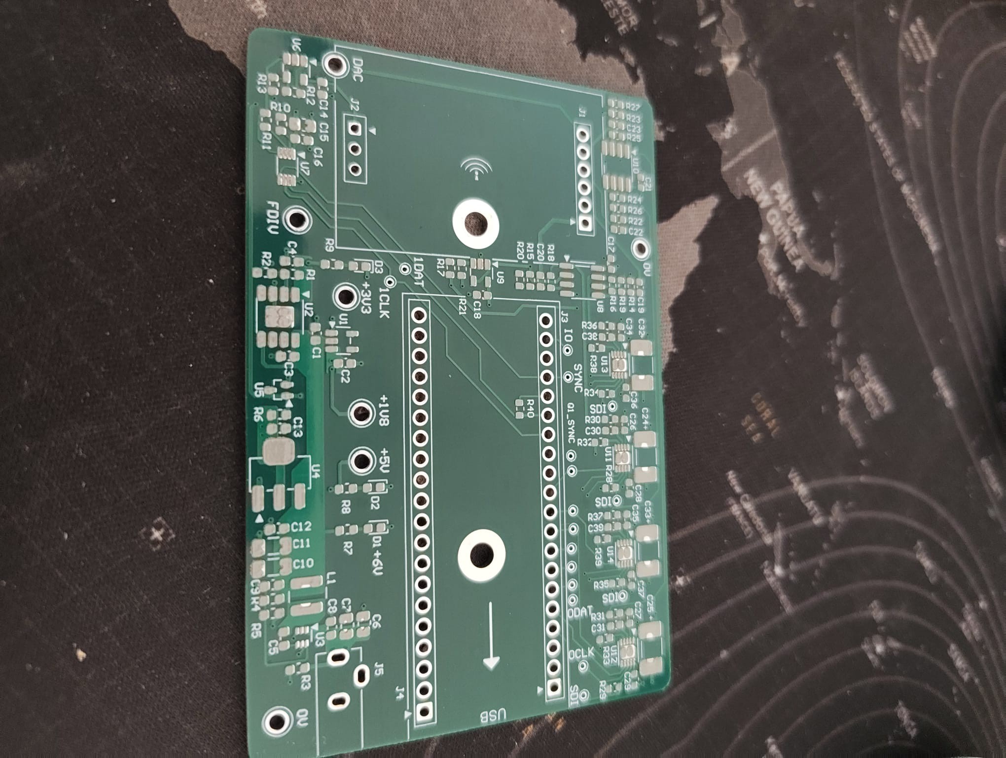

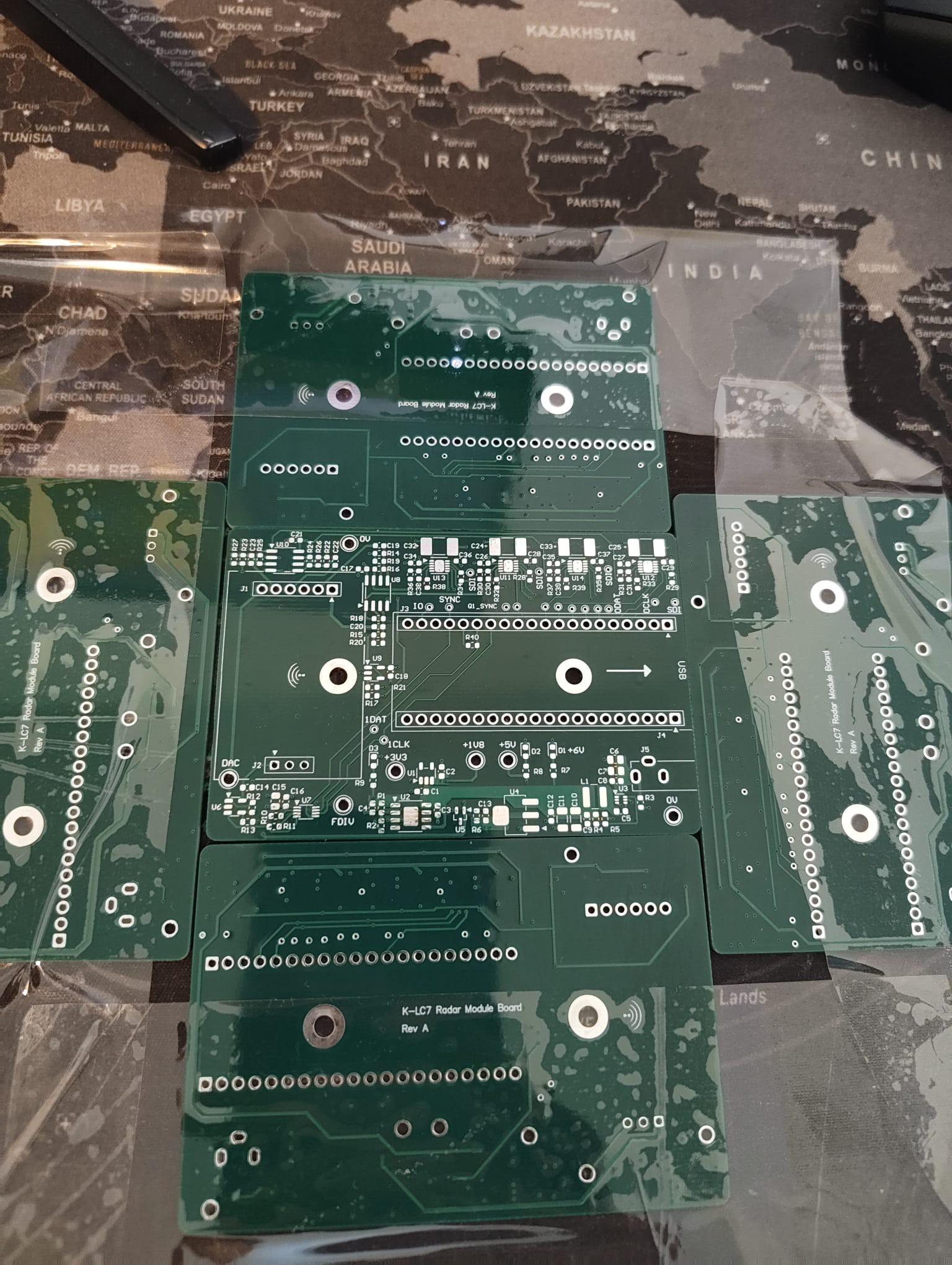

    Darren Winter04/21/2026 at 19:24 0 comments

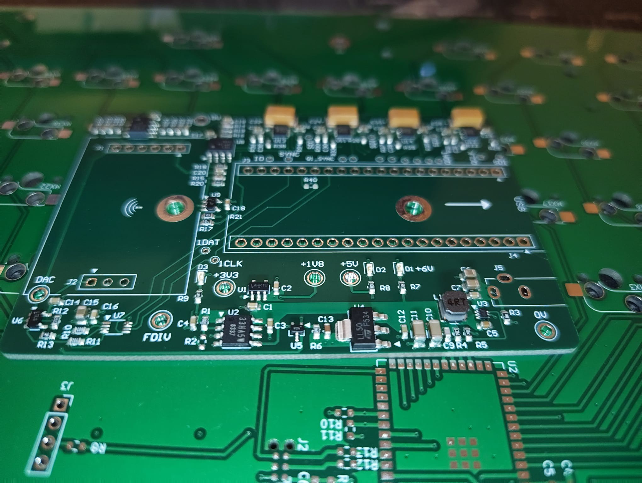

    The PCB has arrived and it is reasurring to know that these two components fit at least. I have yet to start any firmware development on this, but already having found a problem. I had not connected the 0V on the pico to the boards 0V. A rookie error. I was not quite sure what I was thinking at the time, but I will be sure to get some measurements of the before and after making the mod.
    The rest of the components are on the way, so I will be documenting the build process. During the design of the PCB the same rules applied to any other and that was keeping areas seperate on the board where you can and short traces. I certainly was a bit nervous when routing this as the analog portion does not have much wiggle room and the radar output is already quite close to the noise floor.
    I have tried to keep the traces as short as possible so they enter the op amp stages as soon as they exit the radar, though looking back I think some optimisation on placement could have been done.
    I did project on gas sensing once in a previous role which was quite interesting and the same concerns were had there with such a tiny mV signal coming out of the sensor the same concept of trying to keep things nice and tidy together was important. Highlighted in green is the radar output. You want to make sure that keeping that trace short as possible and entering your op amp gain stages quickly as possible.
    On my ADC section I had replicated the layout so when I do find a mistake of course at least it will be easy to fix on all four ADCs. Nifty tool from Altium, PCB layout replication. I had also opted to only fit ADCs needed for one receive antenna, otherwise I thought I may run into more issues getting ahead of myself. Once the signal was amplified I was still cautious to not route it against any clocks or things that will ring. Even though the signal is amplified it is still an analogue signal to be cautious, that is not to say digital ones you do not need to be worry of. A good solid ground plane also helps underneath.
    The power section had kept on the other side of the board and rather segregated from anything else. The only other portion of circuitry next to it is my DAC which I will use to generate the chirp which is circled gracefully in red. Again, keeping things seperate from my analogue and digital side the DAC was constantly going to be firing out things, and we saw this in the prototyping of breakout boards that we could see the DAC harmonic being shown on our USB ADC. We are avoiding that this time.
    One thing I could have done actually and have forgotten is stitching vias, it is handy to have a checklist and all good, but seems I did not even use it..
    You will also notice I had placed lots of test points everywhere, these are your friends, even if you do not expect to use them.
    Since we have a solid ground plane underneath with enough 0V vias to tie things together, I do not expect issues of floating copper. Speaking of copper, one of the things I am not doing much nowadays is pouring copper on the top and bottom layers. Yes it does get etched away and perhaps you could argue well it could cause issues maybe its better practice to place a top and bottom copper pour, though Mr. Peterson will do a better job explain than me here.

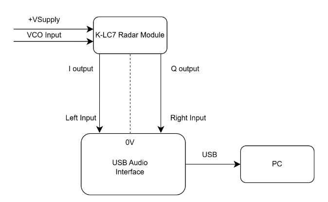

  • Basic Testing the Radar Module
    Darren Winter02/25/2026 at 19:45 0 comments
    As a reminder, this is what our basic block diagram looks like:
    To start off , the radar is set to continuous wave (CW). Many times than not we forget that we must start off simply and build our way up. Whether this is even as simple as making a LED blink with a microcontroller. Setting this to continuous wave means we can see if our module works and decreasing the amount of parts in this trial.
    For context, the VCO pin on the module allows you set a ramp. This ramp allows you to control the chirp, thus making a frequency modulated radar.
    The datasheet of our radar module stated a minimum of +3.2V is needed. There were issues in reading the radar output, the current consumption was also below the 90mA specified in the datasheet. The datasheet is treated as gospel usually, at least I used to, though we should really verify these instead of trusting blindly. After steadily ramping the input voltage to +4V data was able to be seen.
    With +4V applied to the VCO pin of the radar as well, there is no ramp, a set frequency is applied and this set frequency could be 24.125GHz for example, the radar will transmit that.
    Taking a slight step back on how we selected our equipment for this trial, our USB audio converter. Based on Nyquist we can safely sample to roughly 20kHz with a 48kHz sample rate. Our maximum beat frequency in this case must be below 20kHz.
